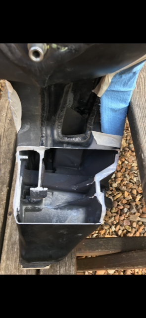

    Dont forget the tyre grows taller as you accelerate so the real way of getting a 60 profile to fit is to modify the swing arm as the shape of the front edge is wrong and doesn't mirror the curved shape of the top of the tyre. quite easy to do once you understand it.
  7. heres a street fighter arm being cut for 200 60 tyre clearance
  8. RS arm and all associate parts circa £3000-5000 second hand if you can find one
    street fighter arm modified... £500
    ideally both need a ttx as well for £1000, a rs rocker ratio and tie rod for £400

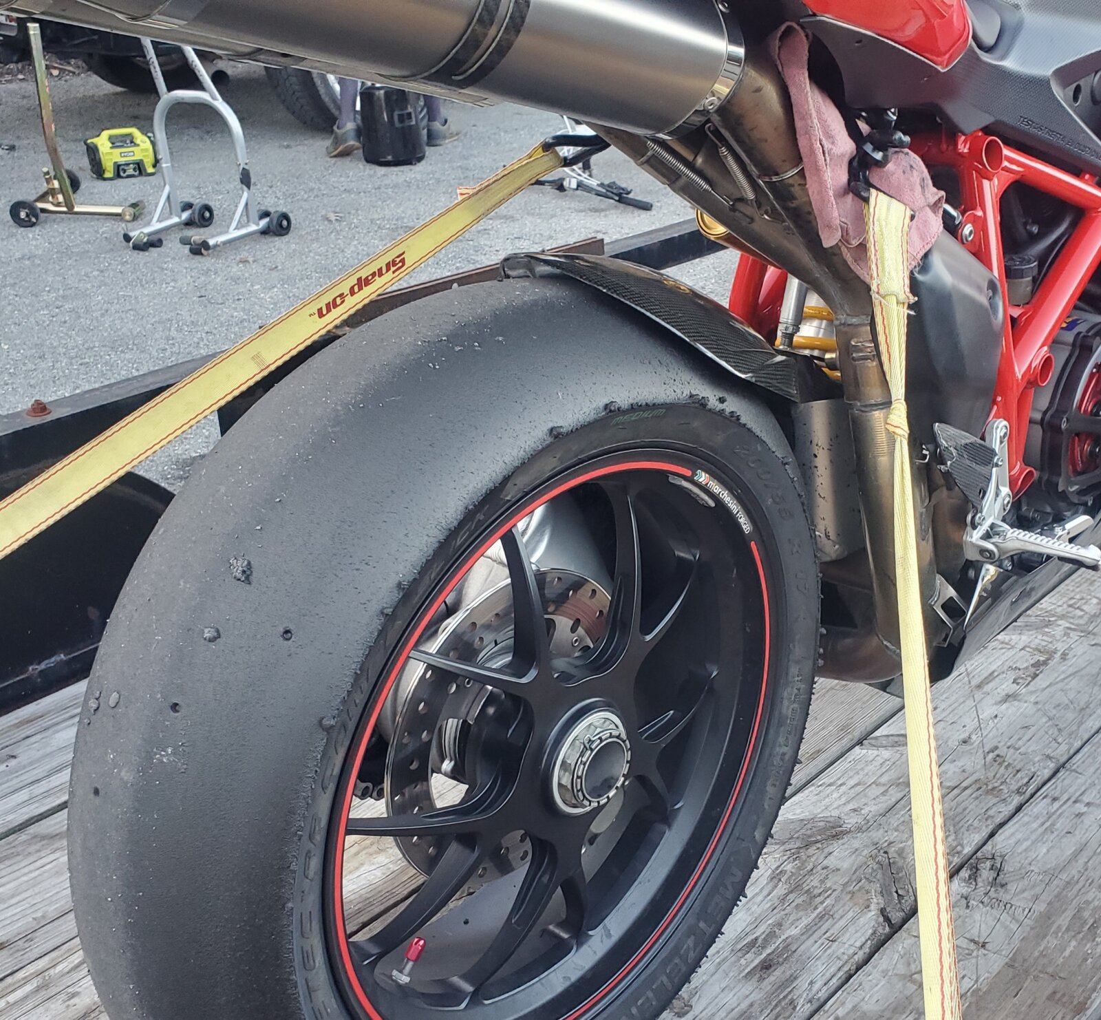

  12. A 200/55 won’t fit my 1098R without rubbing. I tracked the bike with a 190/55 and my favourite tyre was the Metzeler Racetech which although treaded (it’s got a few slash cuts) suited me. Andy
  13. I have a metzeler 200 55 17 comp k slick that fits and performs well with no fitment issues at all. I did however previously install a 14t front sprocket and performed the rear brake caliper mod which moved the rear wheel back further.
