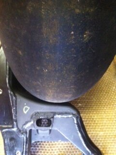

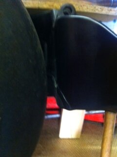

  5. A 200 will be close to the swing arm at the front especially when the tyre grows under acceleration....you could rotate the wheel back with a longer chain to get clearance....or cut that bit of the swing arm away...or get a corse swing arm..
    you can see the curve of the the both around the circumference and the width of the tread is not matched by the swing arm
  7. That 200 looks a bit close for comfort, will give the 180 a try... and if I'm not happy I'll try the Supercorsa V3.
