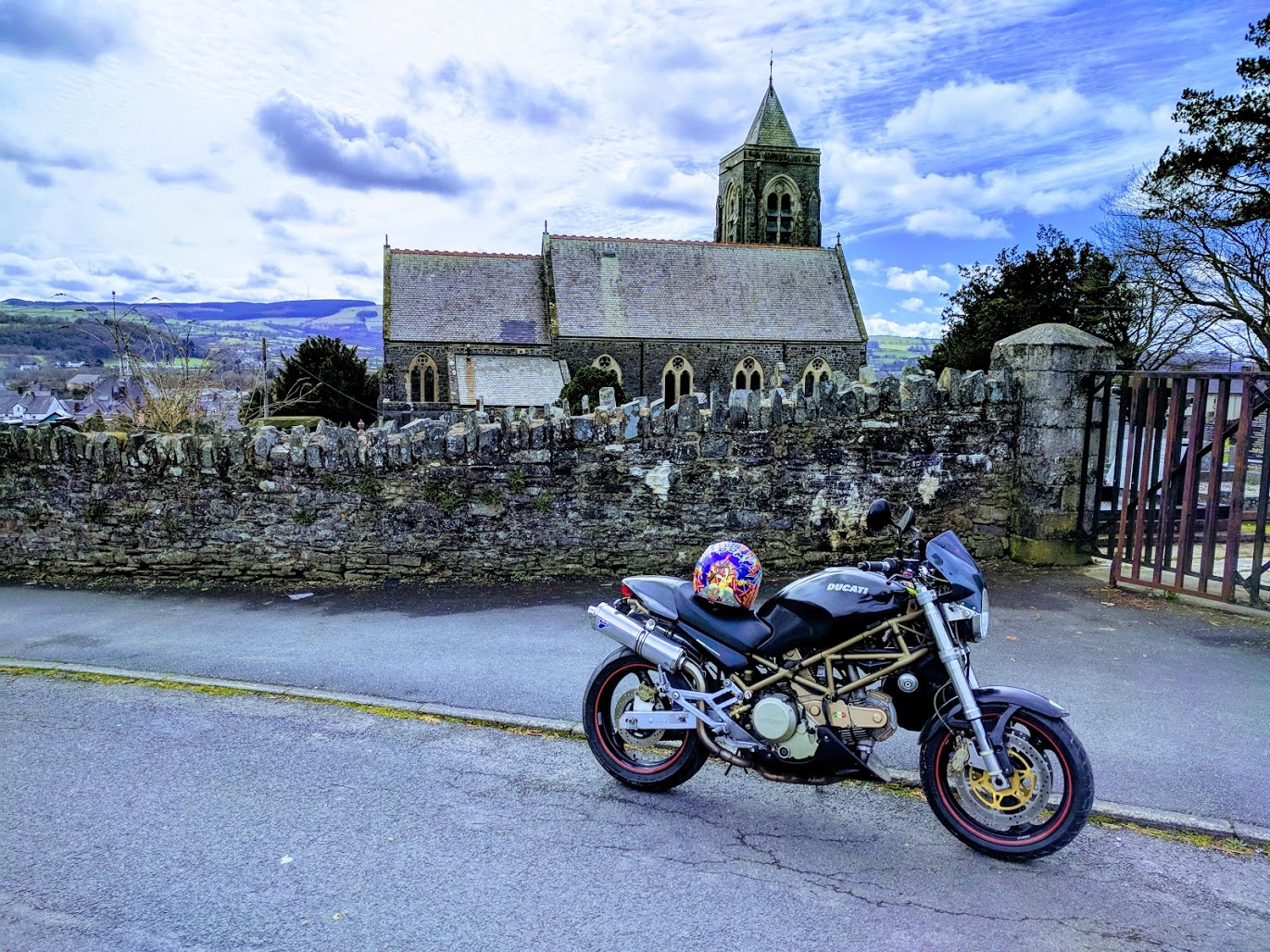

  7. My 600 was a fantastic bike, I had it for 7 years and it had 23,000 miles on when I traded for my M1000Sie. Never let me down, always started first press - I did use a battery tender - and cost peanuts to run. Useful range of 170 miles to reserve, so better than the 120 of my 1000. Simple to work on and fun to upgrade. bike_lampeter.jpg
