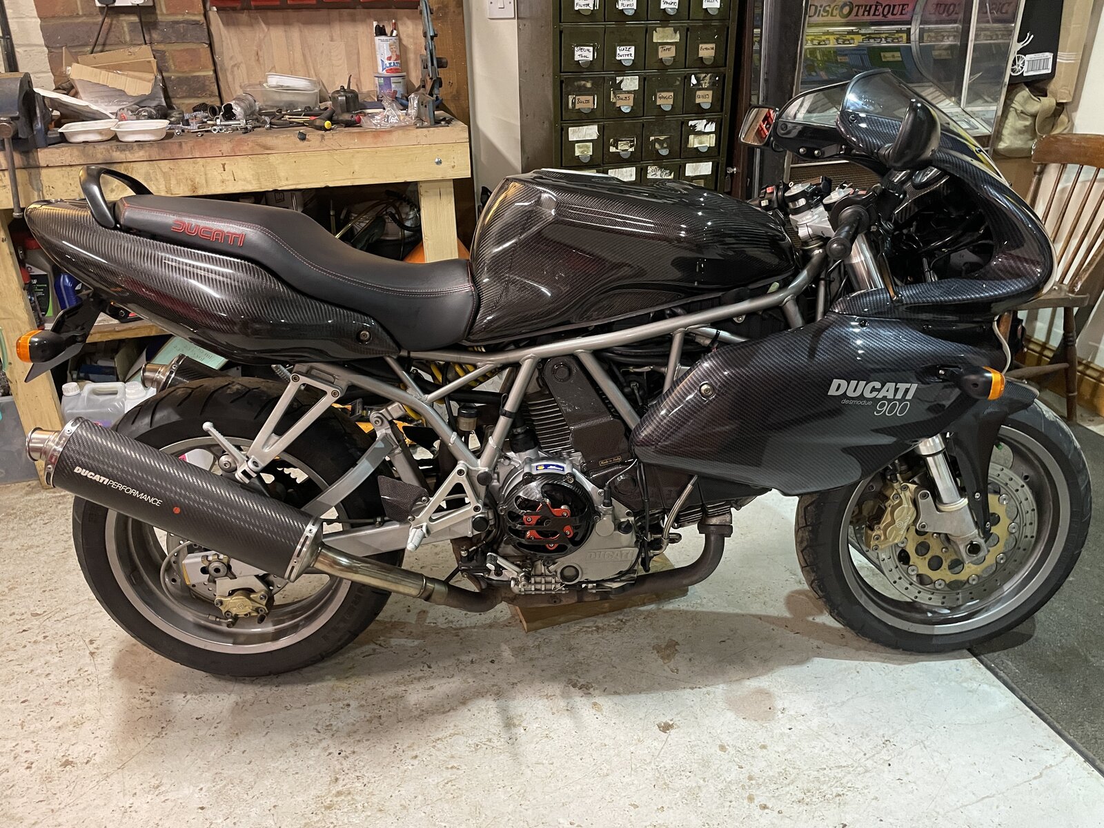

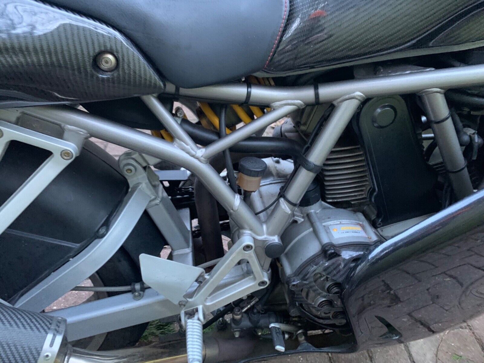

    I bought this bike on impulse really, the price was ok, it was local and I liked the carbon fibre. I've has loads of Ducati's in the past and still have a Darmah SSD so its not totally alien, but I've never had this model before.

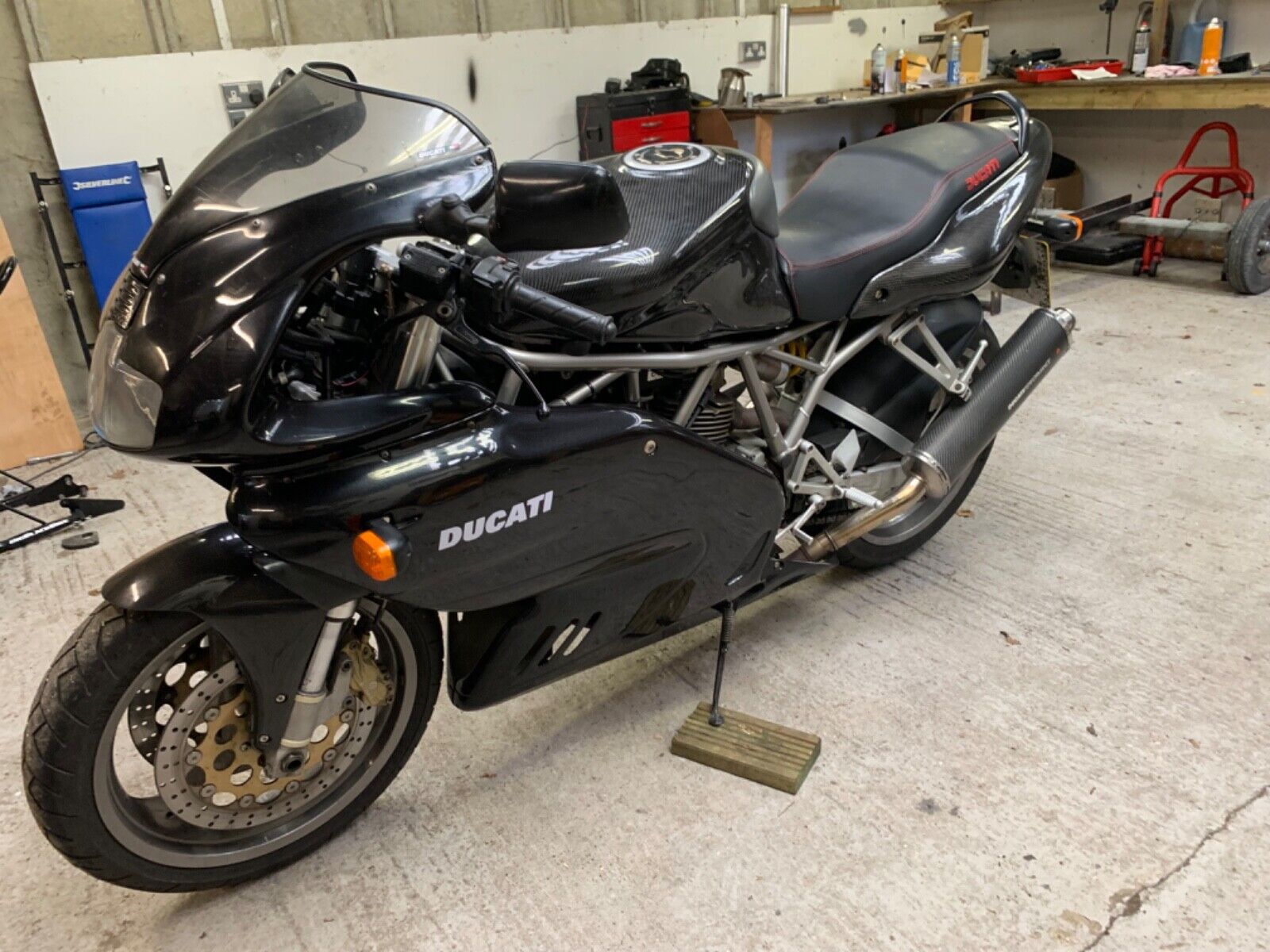

    It has some great features. The tank and seat panels have been carbon fibre overlaid which would cost a fortune to get done. The frame wheels etc paint is in great condition. It just needs a bit more work to get it to the next level. Thought might document it here and hopefully get the technical help should I need it. BD2C2162-9CFA-4EC2-90C1-D3D60A69BD0B.jpeg DF4D9CFC-D047-4031-865C-4B3F092A5B4E.jpeg 6A048482-888F-444F-96C1-EE5BD3F1AB9B.jpeg

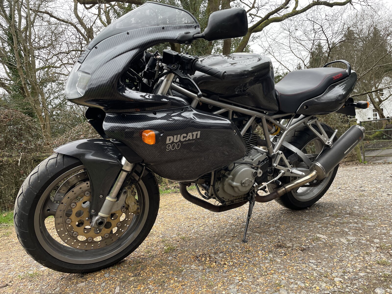

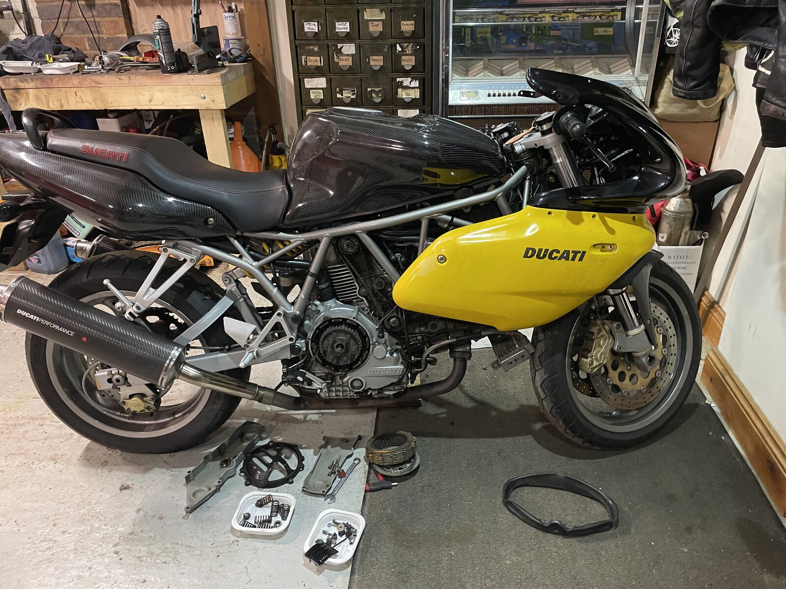

  2. 045637FB-7706-4E63-B77A-DABF4A9E4333.jpeg The fairing lowers turned out to be pattern. I've never been a fan of the full fairing so took the saw to it. I like the look but decided to go for original half fairing panels. 7F6A460A-FDB4-4756-A6CE-CDC51CFD215C.jpeg

  3. Think you have a SSIE rather than the carby SS

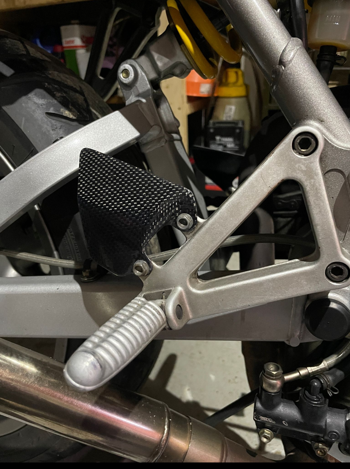

    I picked up a pair of carbon heel guards yesterday to continue the theme.

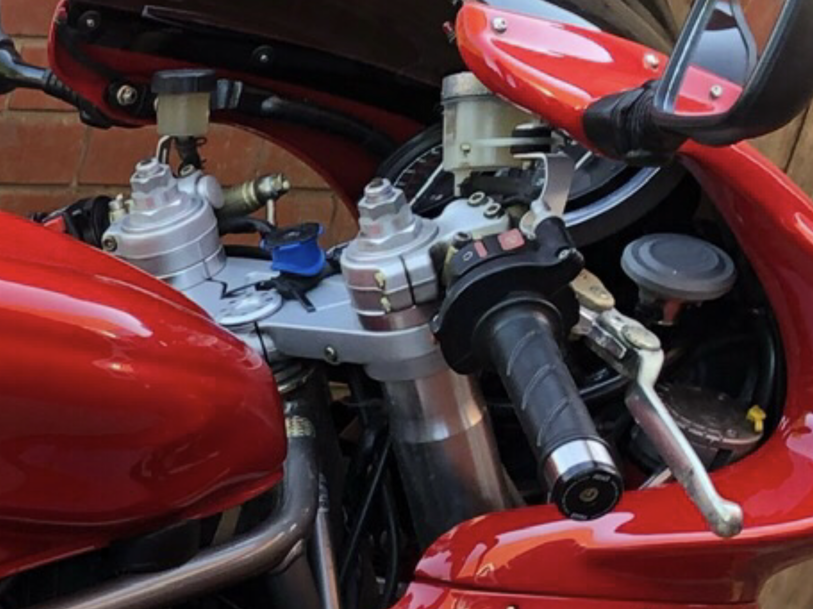

  5. I think it probably isn’t an SSie exactly but is a 900 Sport ie due to the steel swingarm and non adjustable forks. If it was black originally it would have been satin black. I haven’t seen an ie with coffin style reservoirs and old style levers (grub screw adjusters), as even the later carby 900ss came with double “tupperware” reservoirs, and ie came with the 4 position dial reach adjusters. Either changed out by a previous owner for some reason or an import and that was the spec in that country?
  6. It certainly appears to be a dark model, non adjustable suspension. Not sure if those clip ons are original either, the brakes certainly arent. They were only fitted to early carb models they swapped about 95 to the round reservour ones.

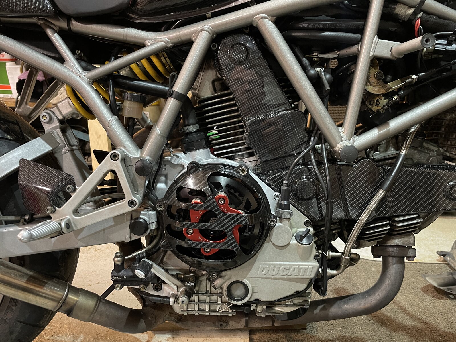

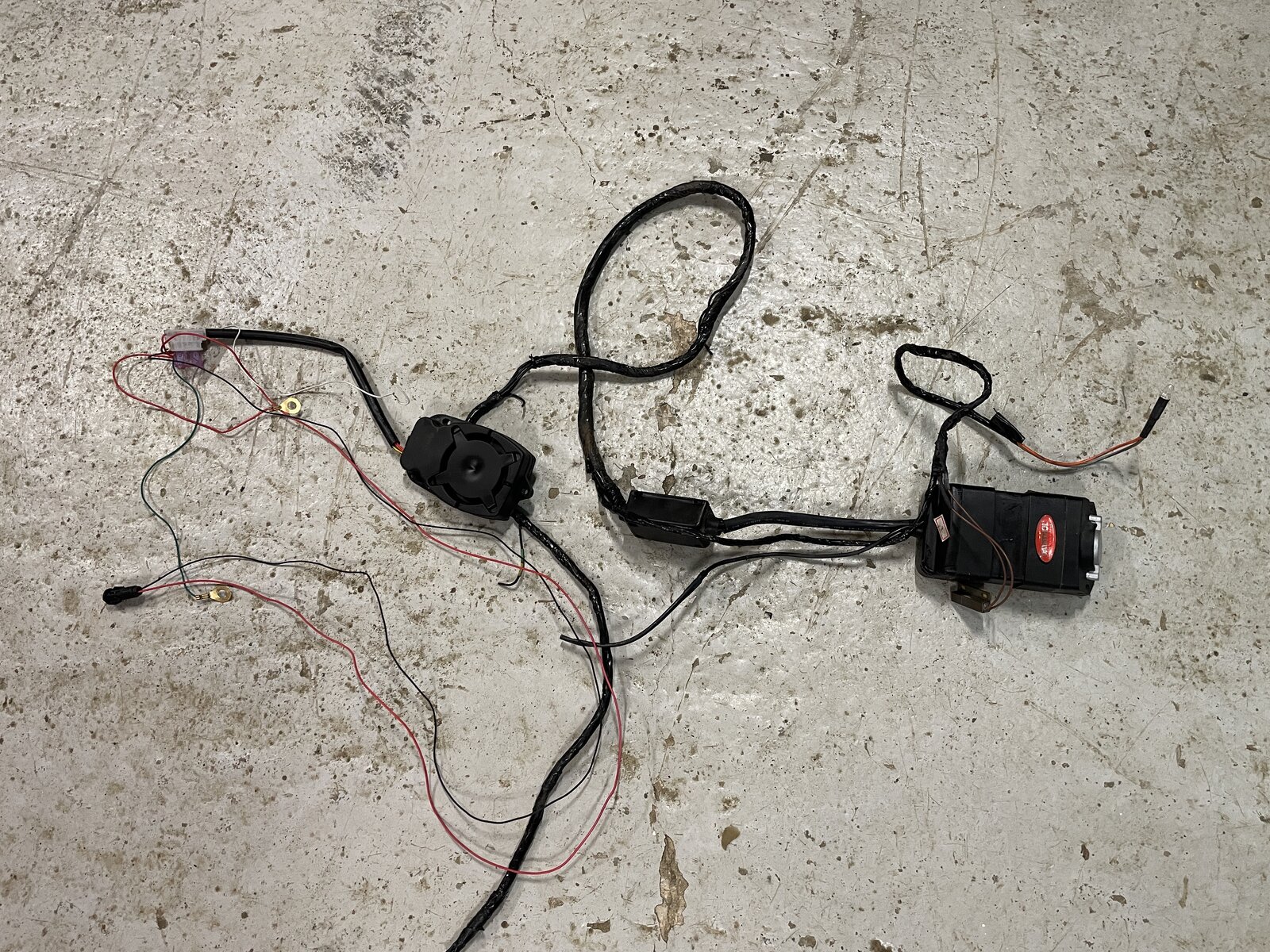

    I removed the cheap alarm and the tracker immobiliser as it was disconnected from the battery anyway and meant I could tidy up the loom again, no more insulation tape.
    Thanks to Rman for the spare clutch plate FOC. I fitted new timing belts, carbon belt covers a prettier pressure plate and springs.
    I dropped the fairing off for a Carbon look hydro dip, so lets see how that comes out?

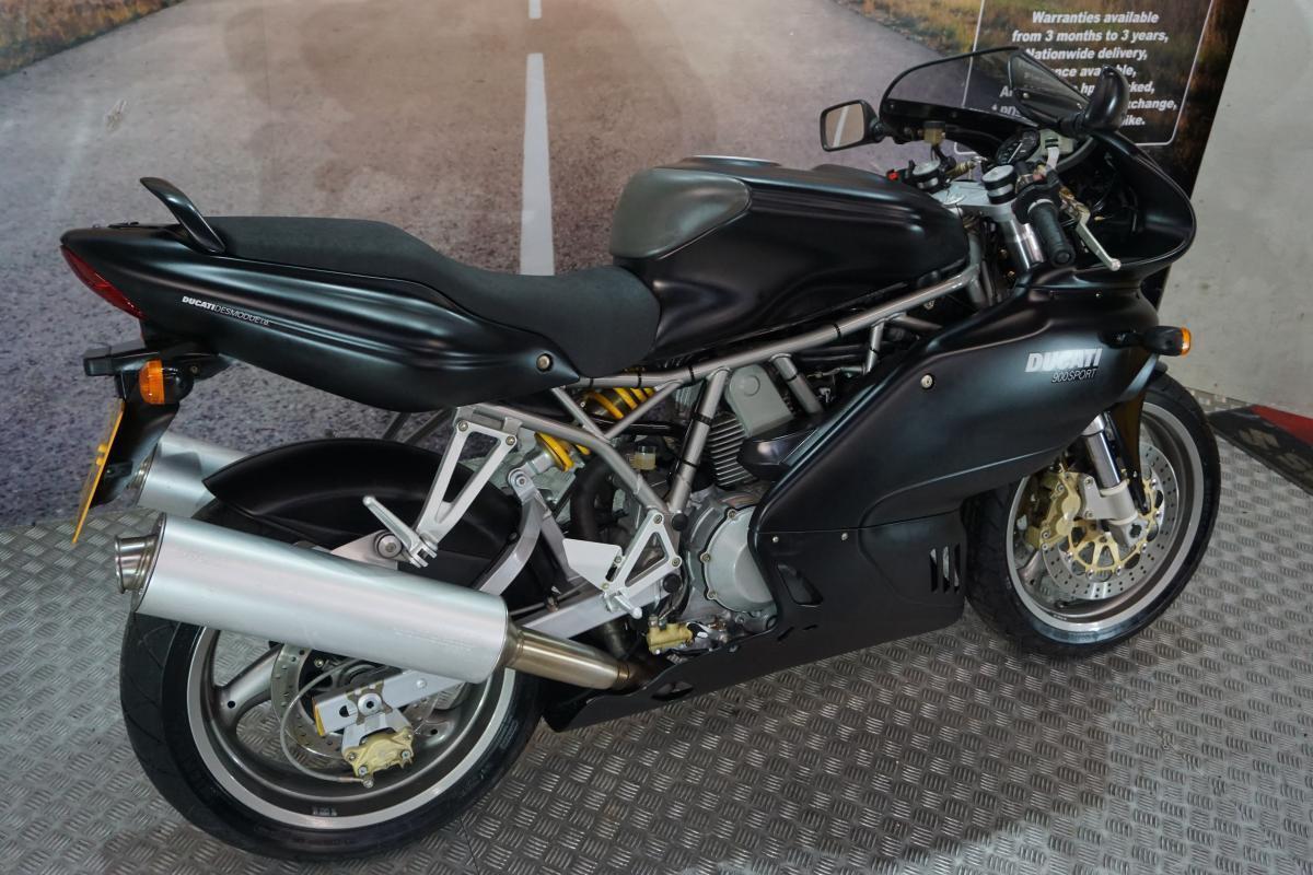

  8. Heres a new old stock bike for sale, steel swing arm and clip ons. Looks like this was my spec. only the master cylinders differ.
  9. Ah, cool. I had a 'Senna' SSie and it had different clip ons, thats why I thought they werent OE. Masters are available on ebay or new from plenty of suppliers. Although to be fair, the 'coffin' style arent that bad

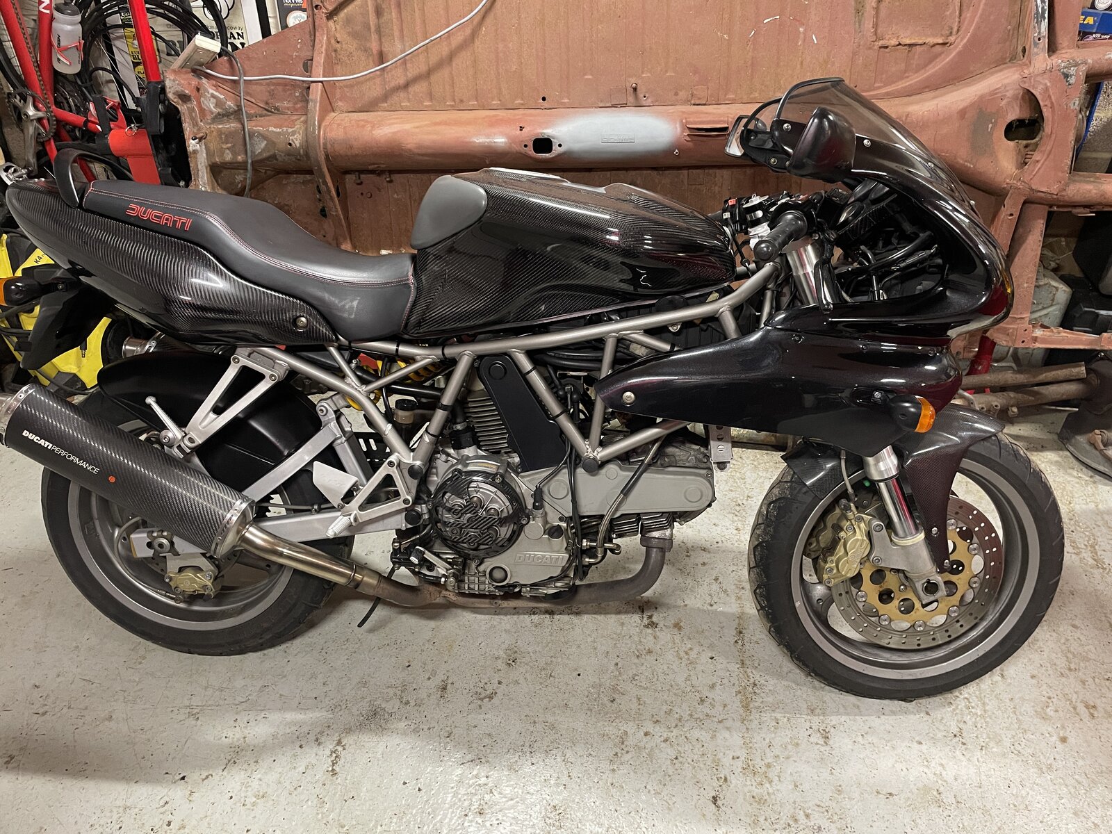

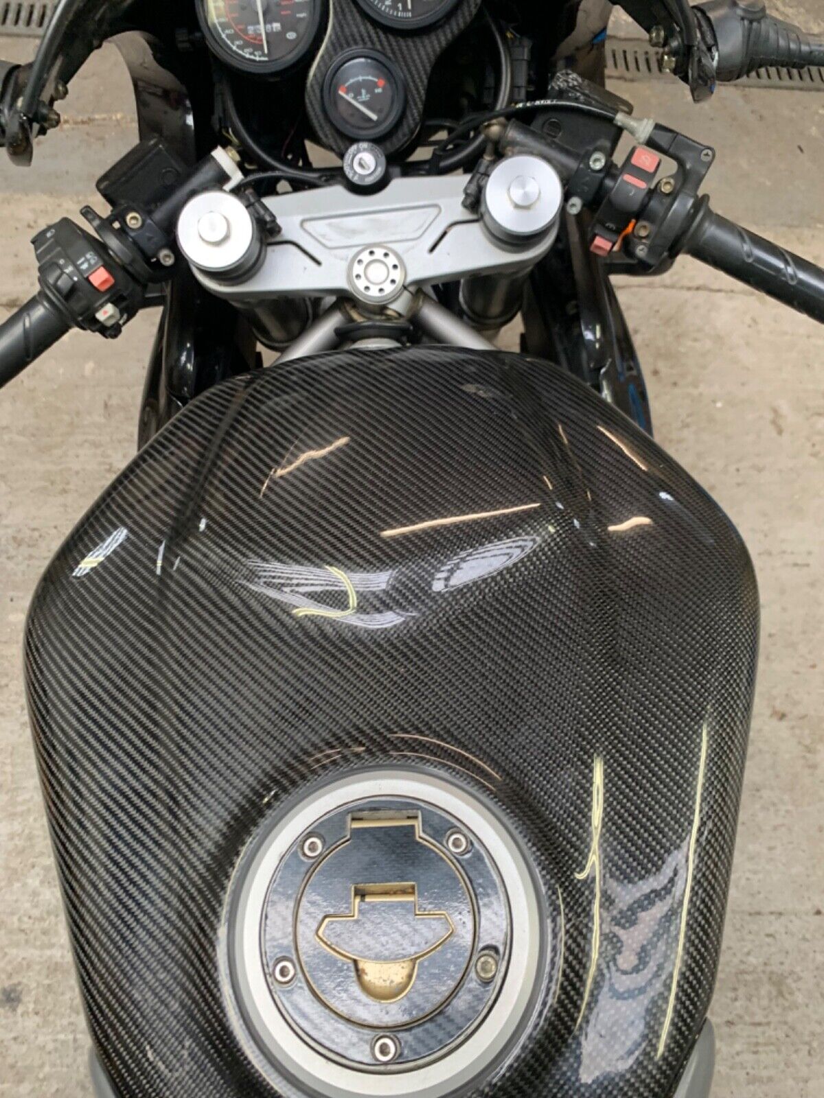

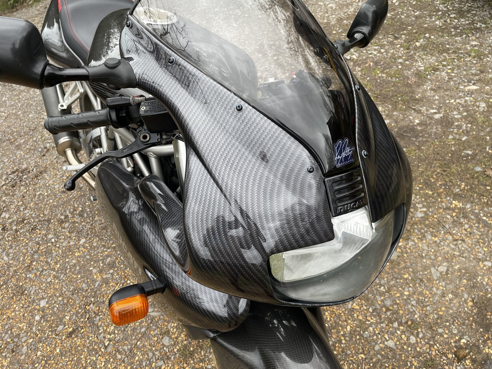

  12. I finally picked up the hydro dipped fairing. A pretty good match for the real carbon fibre. IMG_6815.jpeg IMG_6806.jpeg

  13. wow that looks good. Don't forget to put oil in it... looks empty on the sight glass...
  14. It will do on the prop stand. Shame about it loosing the lower half of the fairing though.

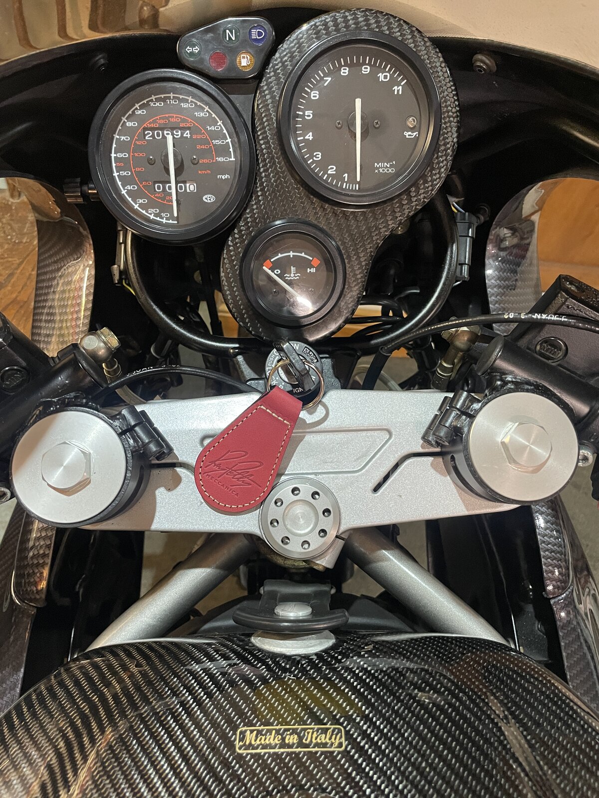

  15. Nice bike mister. Unless it was deliberate, I'm sure those clip-ons should be mounted under the top yoke. I'd have thought the steering geometry would be affected significantly by the current set-up, with so much fork pulled up through the top yoke.
  16. sorry - you’re wrong for the SSie.
  17. Yep, SSie clipons are above the top yoke and further more there is a spacer on the fork leg protruding through the top yoke and the clipon sits on top of it.
    See photo below. At one time I did sit the clipons on the top yoke and put the spacers above them, just to keep them safe but the years have marched on and I’ve reverted back to the original configuration. One of the reasons I bought my Striple 3 years ago. Ok for shorter journeys but it’s the Striple for touring these days.
  18. Apologies for the clip-on confusion...as you were
  19. Just for info...the carby ones are below. :upyeah:
