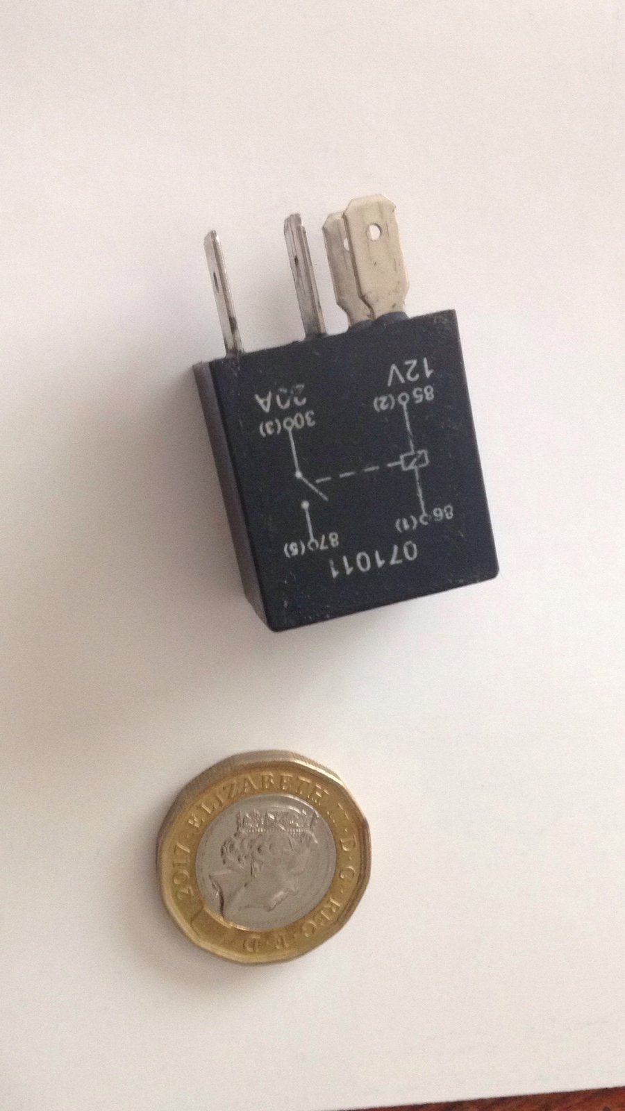

  6. Search on here for the fuel relaying the 749/999 section, someone here knows an alternate part number to search for on flebay and its stupid cheap compared to dealer
  7. Tyco V23073
