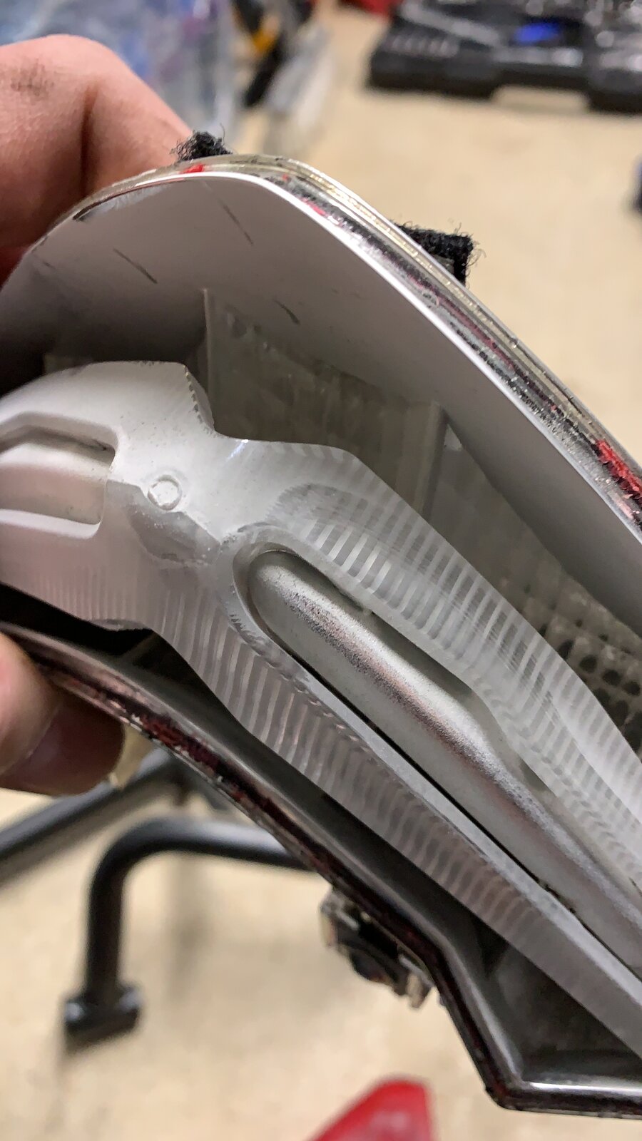

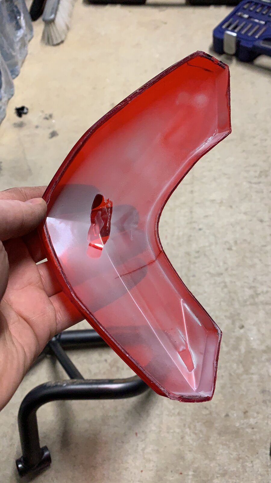

  5. They can be opened up, faulty LEDs replaced and resealed. I did it to a 2010 model a few years ago.

    Thanks Derek. Sorted it yesterday. What a nightmare getting the lens off but once I got one section released I just levered as I went. Only 1 LED out. So cleaned it all up and glued back together. It will do until such times as I come across a replacement.
