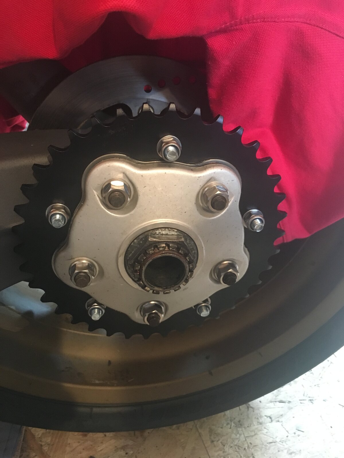

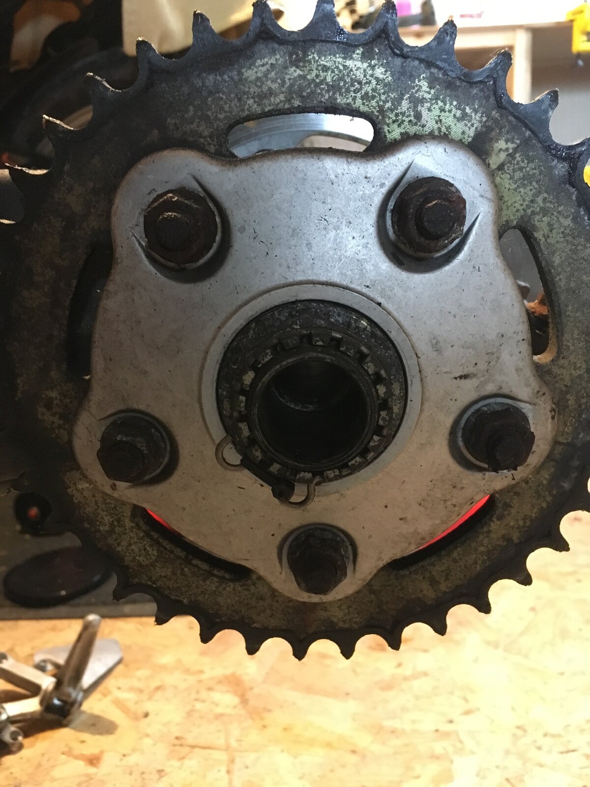

  2. After market. DID gold chain and Renthal or JRT sprockets, complete with a change of sprocket carrier so as the rear sprocket is quick release. No need to break the chain to remove sprockets, cush drives, rear wheel pins etc etc then.
  3. Hi thanks so with that I throw away original carrier with Cush drives etc and buy new carrier and chain and sprockets that then just bolt direct with no Cush drives is that correct ?
  4. Nope. You retain the cush drives, use them in the new carrier onto which the new sprocket and original rear sprocket flange bolt. The new sprocket can be removed without having to remove the flange and carrier.
    An after and a (very corroded) before below.
    On a 748 admittedly, not a multi, but Im sure they’re the same.
    D3A58937-86B1-41E3-B1BE-10362D0C00E5.jpeg 7AC490D6-CFF7-4D75-B62D-D3294188CA24.jpeg
  5. The difference is, on the original the carrier & rear sprocket are one piece, on the new, they’re two separate pieces.
