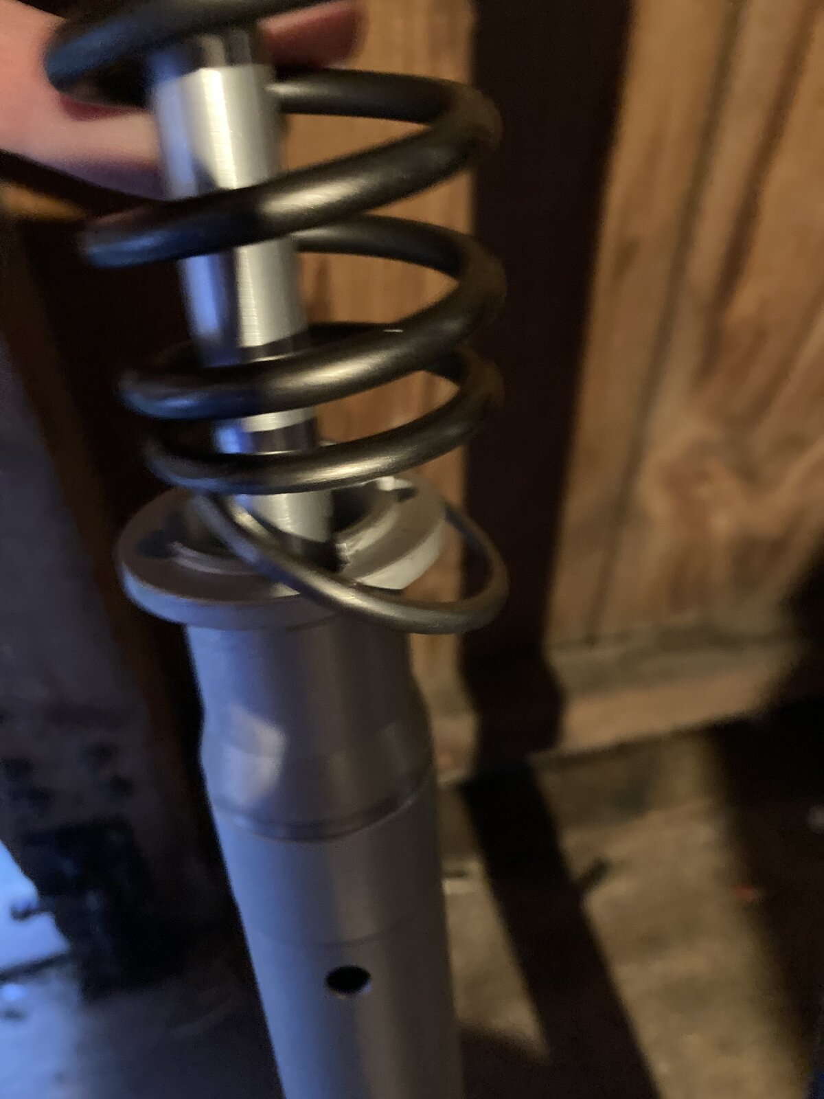

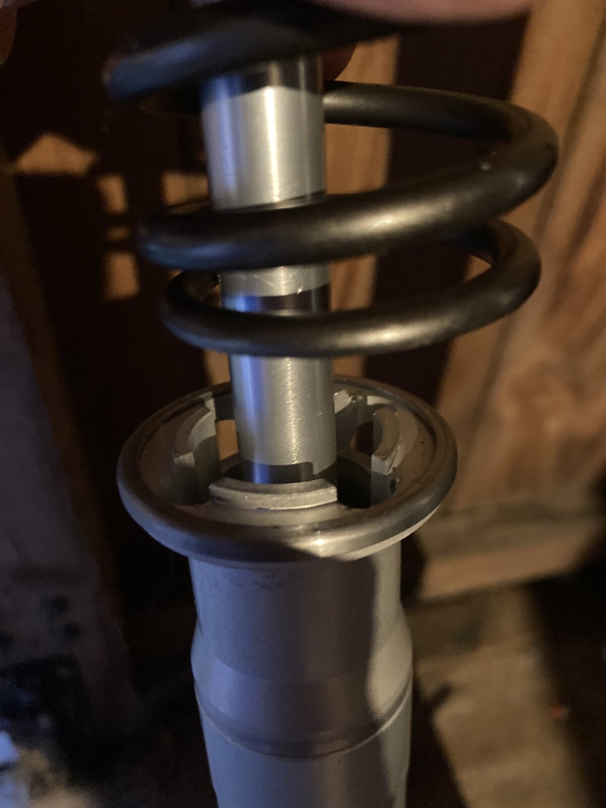

  5. Got the SKF KITG-48Z and look the same. Also ordered the bushes from Brook Suspensions – NOK bushes - Upper Guide bush GBS-033/15 (52x48x15x2) – lower Slide bush SBS-035 (48.7 x46 x20x1).
    Another issue now.
    Taken the fork apart according to the spare parts catalogue there should be a washer that fits under the spring -see diagram. There was no such washer on mine unless I dropped it.
    The workshop manual does not show or mentions the said washer.
    This is a bit worrying...
    Was this washer present on yours or not. Please let me know
  6. I’ve got a spare pair of skyhook internals, just looked at the non electronic leg, pictures below.
    B0CFD66C-C0CD-4EFC-B5B9-59736FB6916A.jpeg B0CFD66C-C0CD-4EFC-B5B9-59736FB6916A.jpeg
  7. @GTmorgan - you have saved me so much grief! Those pictures were of great help especially the last one. When looking for the washer shining a torch down the tube I couldn't make out the washer before but your photos gave me the answer. It was there but nicely stuck at the bottom and looked like a part of the rest-see photos. Removed it with a magnet just to make sure.
    Many thanks - I owe you a pint or two at least!
  8. No problem mate, glad to be of help.
    I didn't see it easily hence why I showed a picture of it in place and out of place, it's just there to protect the alloy inner from the wear of the steel spring.
