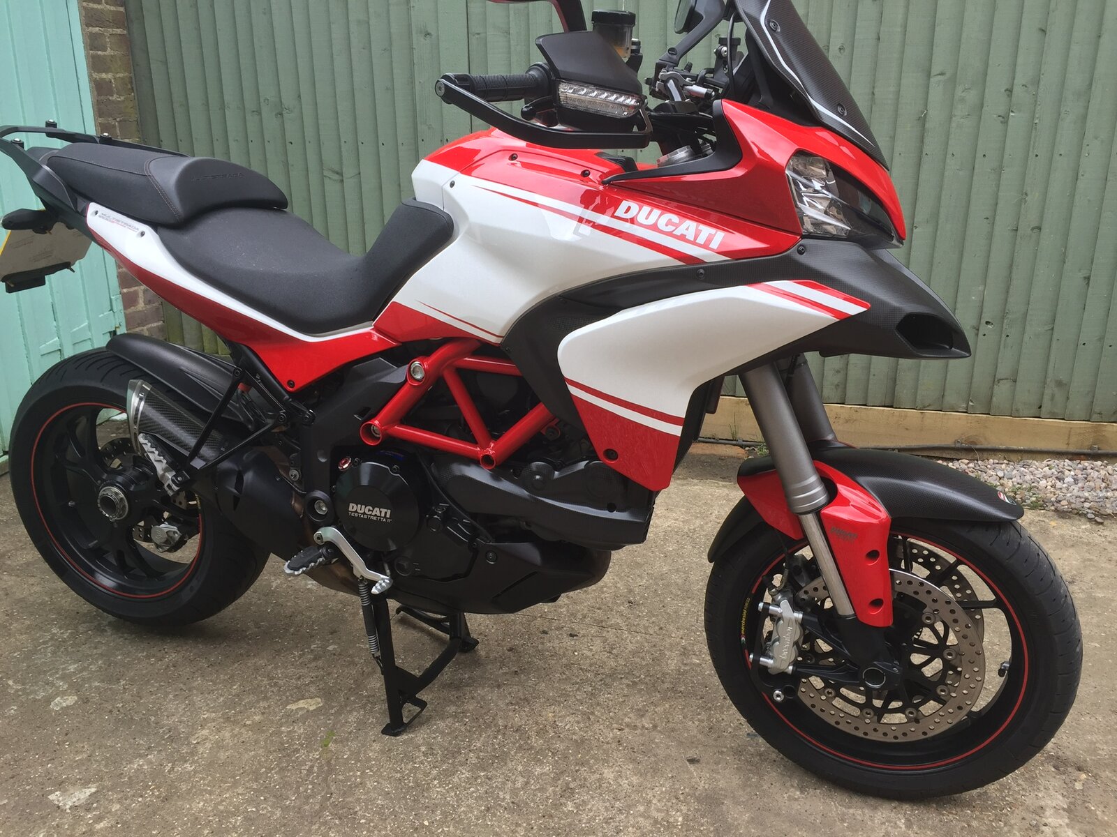

  1. IMG_5563.JPG having not owned this that long just wondering if anyone has adjusted the skyhook suspention
    And what settings are you running you only seem to be able to adjust front and rear preload
    Thanks in advance
