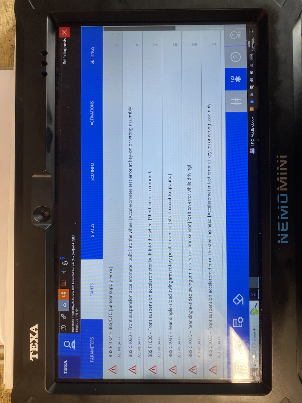

  1. this is occurring randomly and now more and more. I had the bike read on the cpu and it shows the errors{see below} I am located in Thailand. A ducati self owned garage says I need to replace the two sensors up front for the suspension. cost is 6500 baht each. any ideas on things I can do before I bring the bike to the ducati dealer here. The dealer has ordered me a new instrument panel display which is washed out. The gas sensor is the second problem... than the rear accelerometer sensor is the third... why is this happening... is it dirty? how do I clean the sensors {if possible}

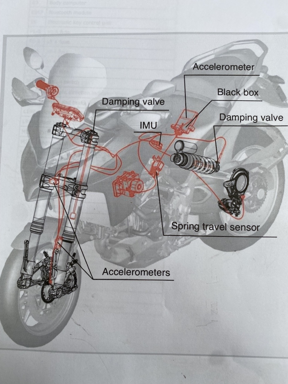

  2. I’ve just been through this on a bike, so have some direct experience.

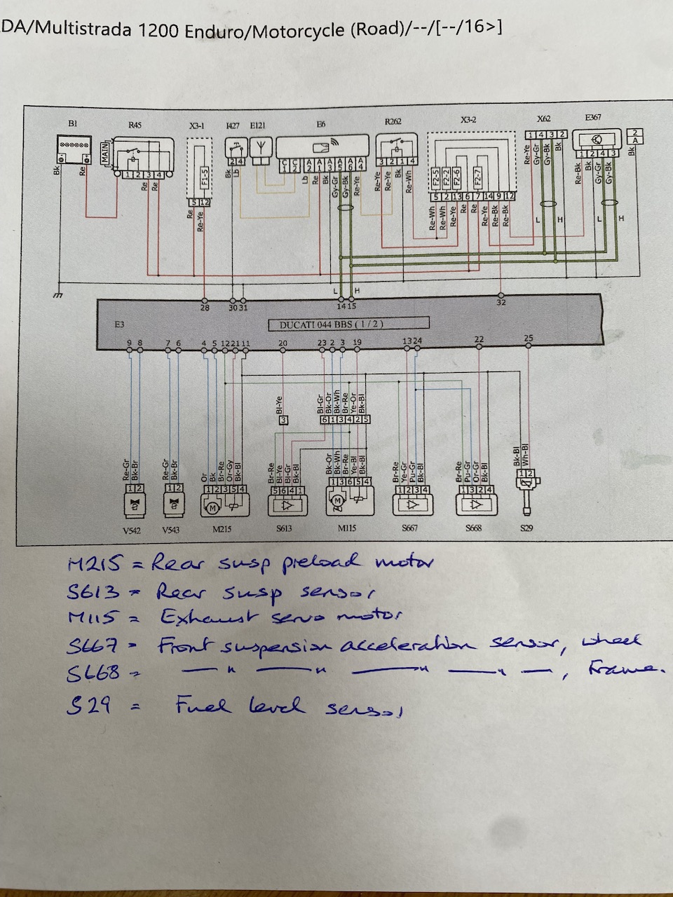

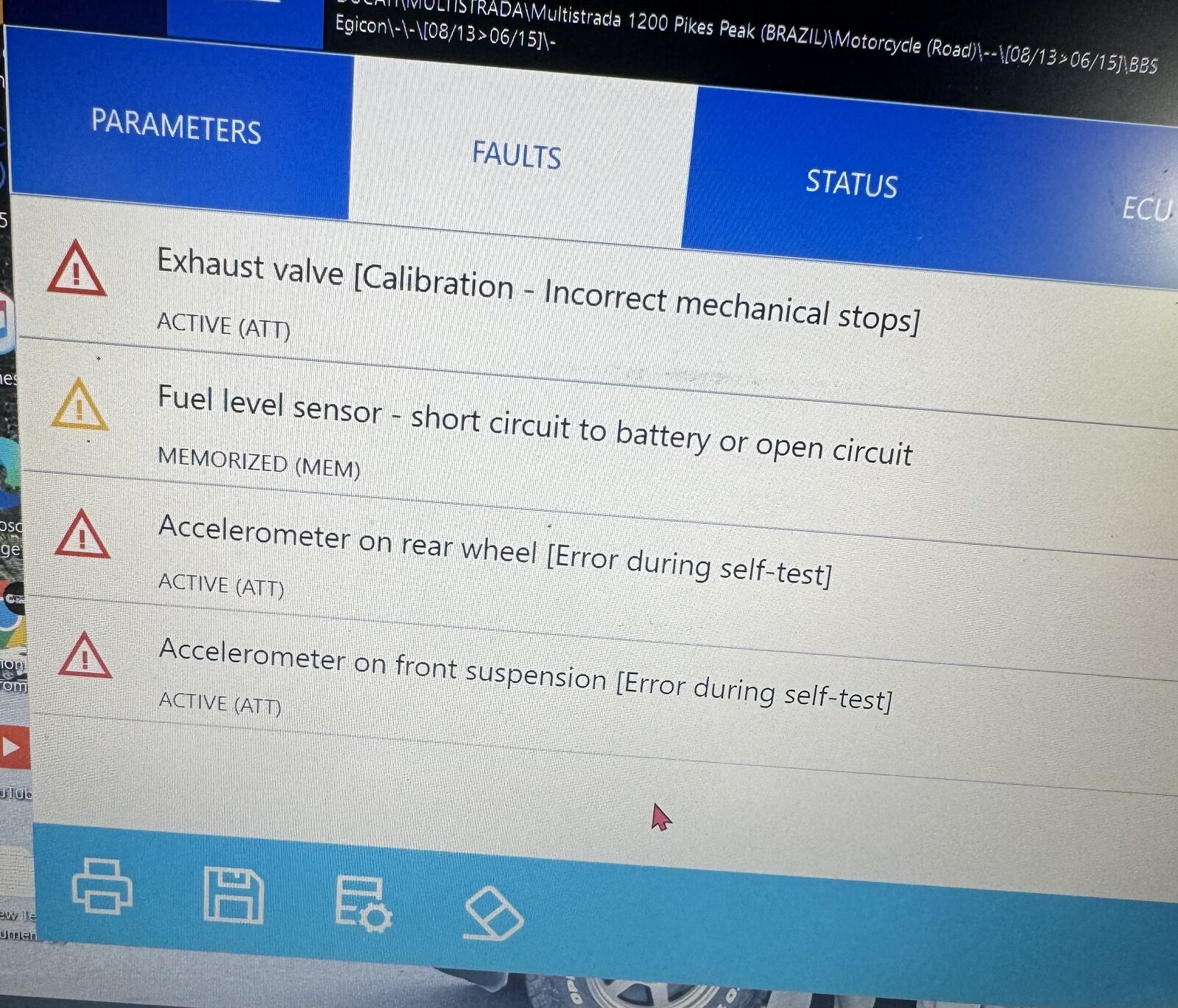

    Firstly, the fuel (or gas) level sensor is on the same circuit as the skyhook suspension, or to be correct has a shared ground wire, so when you have a fault in a suspension electronic component it tends to through a fault in the fuel sensor as well although there may be nothing wrong with the fuel sensor. There’s a high probability you fix the suspension fault and the memorised fuel level sensor ‘fault’ can be erased and won’t reappear.
    Secondly the actual issue with the suspension may not be in the items which appear at fault in the Texa display but could be an internal fault in the main suspension control board which is housed in the big metal cylinder under the seat. Hopefully not because that’s an expensive item to replace involving replacement of the entire rear shock assembly.
    Thirdly, it’s not possible to simply clean the sensors, the 2 front ones are accelerometers, small black boxes with minuscule internal components which measure movement, it matters not how dirty the outside gets. The rear swing arm movement sensor is a rotational sensor and again it matters not how dirty the outside of that gets, the actual work being done is all internal.
    Your Ducati technician should run some tests to identify which component is actually at fault rather than just throwing parts at it. In my case, see the Texa fault list below (and there were more on a follow on screen including the fuel level sensor unit) it transpires it was the only the sensor on the triple clamp which was faulty and (unfortunately) the main SCU on the rear suspension. Although faults were indicated on the lower front suspension sensor and the rear rotational sensor those units were in fact fine.
    Unless you want to strip down most of your bike, and are handy with a multimeter and Texa, the diagnosis is best left to the technician.

    On an aside, the Texa device you show should be giving more information than it is, is it up to date?
