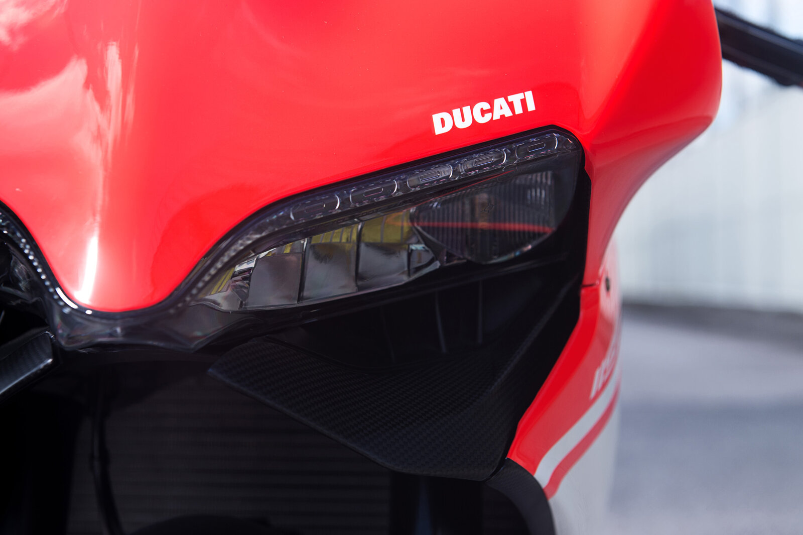

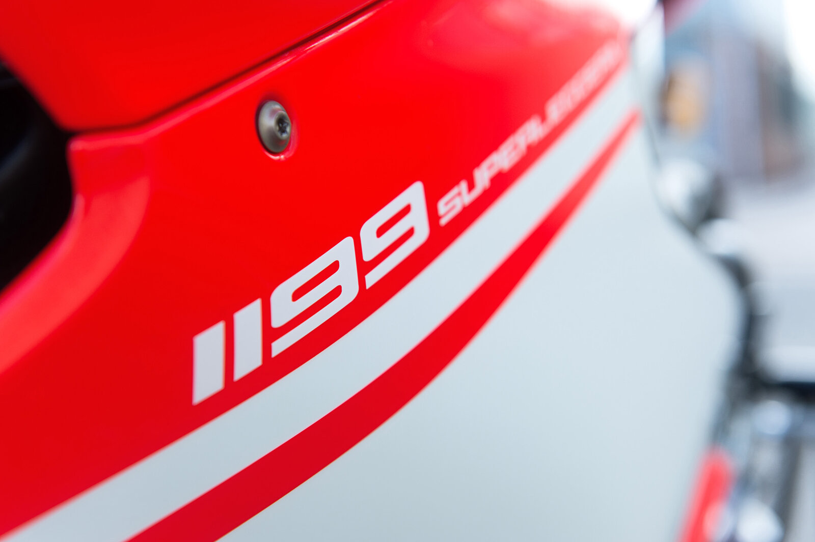

  1. Hello everyone hope youre well,i hope someone can tell me the finish on the2014 superleggera as i love the colour and thinking of spaying my 199s the same.is it a matt finish or a satin please
  2. Thread moved
  3. The 1199 Superleggera paint is a gloss finish, the 1299SL is a satin/matt finish.
    Not sure how it will come across in the pic but I'll attach it anyway. Hope it helps...
