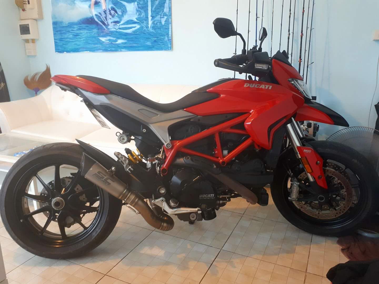

  1. Hey guys, my first post here. I just bought a Hyper 939 and rode it 1300kms home from the North of Thailand. The bike is incredible to ride, but it seems the throttle is insanely sensitive and I have a bad misfire especially around 4-5000 RPM that gets progressively worse the longer I ride it. Got to the point where I was cruising at 100kph and it just spits a flame every now and again. I changed the standard exhaust for a race pipe, it's just made it more prominent. Am I missing something? I was wondering if it was the fuelling, bit it was doing this when it was completely standard. Nothing else has been fiddled with. Any ideas would be greatly appreciated. Cheers

  3. Hey mate, yes the bike is awesome, but I'm sure I've got some fuelling issues somewhere? The throttle is very twitchy but the more I ride it the more I'm going to get used to it.
    I'm wondering if it's the air temperature sensor or something, it was bad with the standard exhaust, and I've only put a slip on pipe, so no dramatic change really...
  4. So I've just ordered a Booster plug, let's see if that helps things at all, definitely can't do any harm from what I 've read.

  8. Ok, go out and order a Booster plug immediately. What a huge difference it makes. So much better low speed control. I still have some misfire at 4-5000rpm though, but it's much much better. Fitted the SC-1, pretty anti social to be fair, but I live in Thailand so it doesn't matter. Now waiting for the servo delete plug, then onto air filter and fuel mapping.
