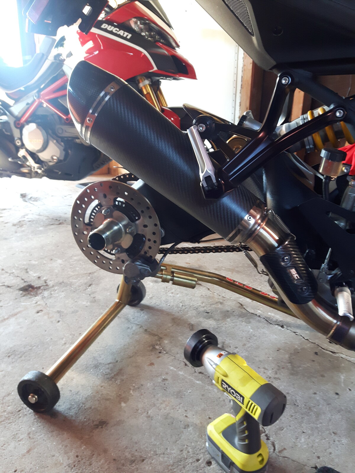

  4. 230Nm, long breaker bar, Impact wrench, big torque wrench. etc.
    At the end of the day, wasn’t that the easiest wheel to remove?
    Was for me.
  5. It is very easy.... If you have the tools
    You could not do it with the toolkit like in the old days!
