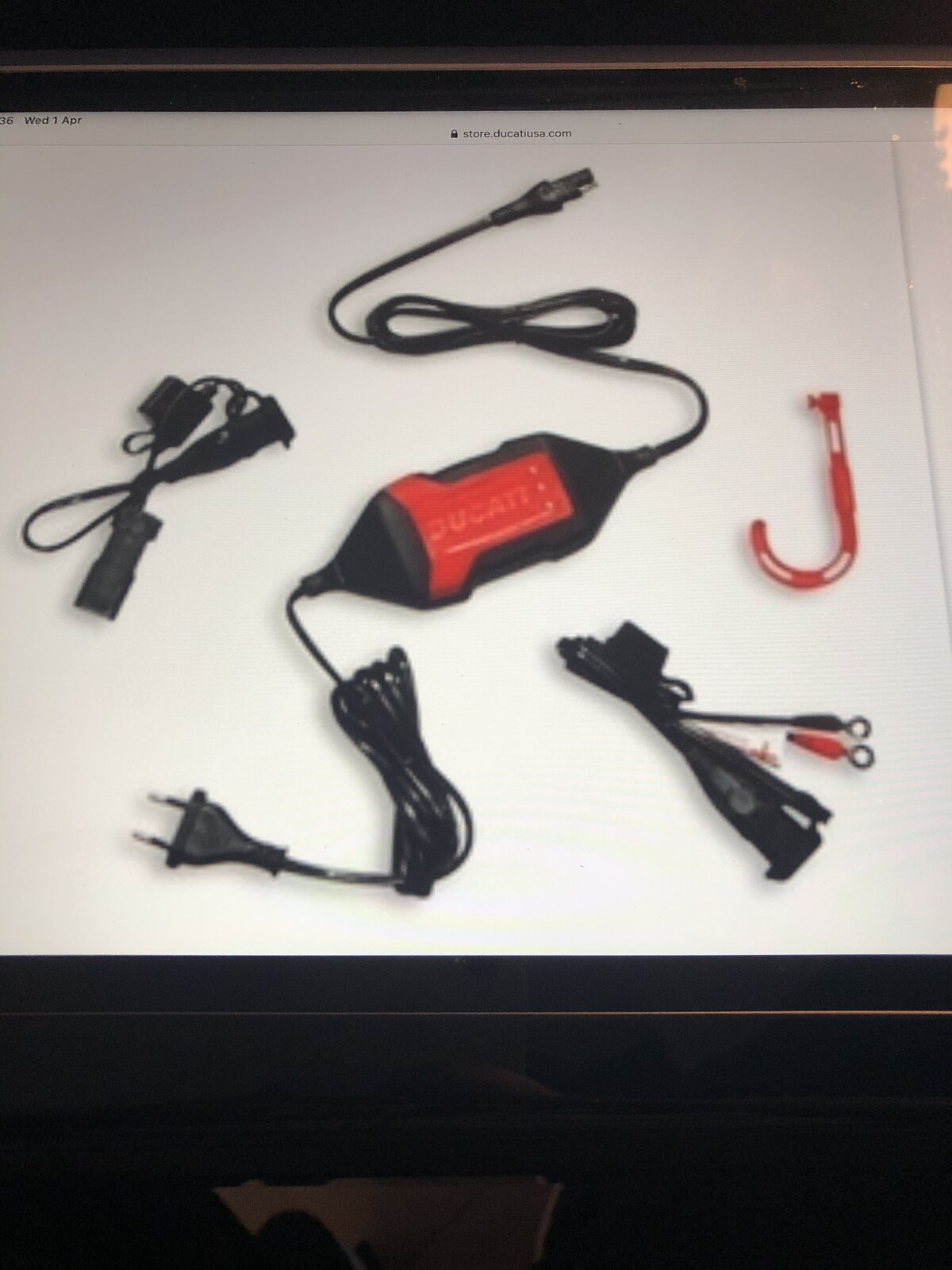

  1. My 2020 Diavel went flat in the recent cold snap..so rather that start taking bits off to get to the batter, I would buy the "Plus life battery" charger from Ducati, figuring that it would be a plug under the seat like the older Diavel's were, and as my previous Multistrada was....wrong! So i have no idea what the diagram refers to below, of where to plug the damn thing in!...anyone got any ideas please?

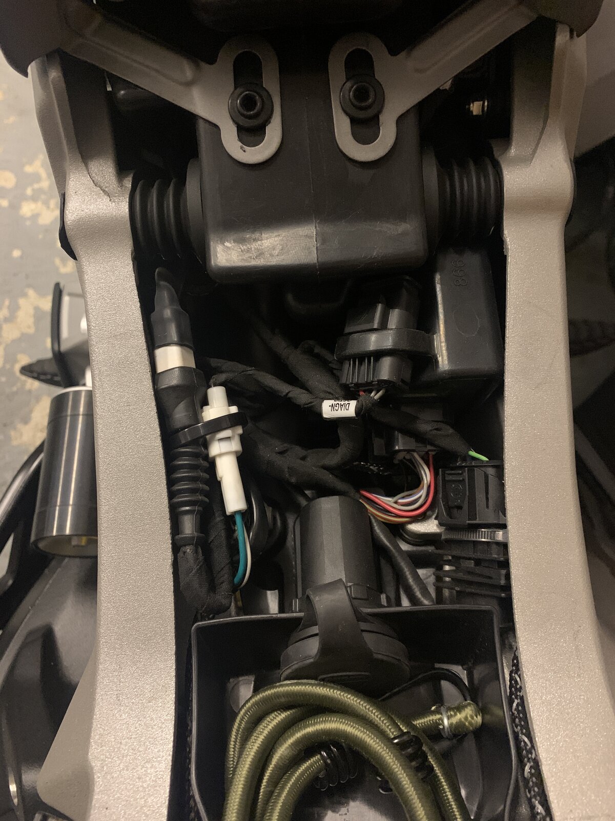

  3. Try the cable with diag written on it, I have the 1260 diavel and the plug was by the tank rather than back of the seat
  4. Agree the plug with diag written on it snaps off to reveal a port that should work , u just need the right connector on the trickle. The one on the left in this pic
  5. Thx, will do!
  6. Many thanks....will try tomorrow
  7. thanks...found it :)
  8. perfect...works a treat - thanks
