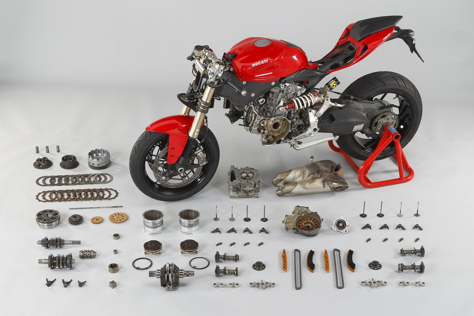

  7. good going - although the loss of 8bhp without tracked down cause is interesting. I assume it's lots of fractional losses.
  8. "Getting there wasn’t all smooth-running. At the 10,000km mark it started running on one cylinder on cold starts, a fault that wasn’t entirely solved with repairs to an exhaust flap valve. At 24, 150km the bike went back to the workshop, and while the exact cause of the problem was never determined, a replacement wiring loom and lambda sensor eliminated the issue."
    So was the bike running on one cylinder on cold starts from 10,000 to 24,0000km? I assume the second cylinder would come on when the engine was warm.
    I am not sure I would be happy, especially that it seems Ducati had no clue what is causing this.
    Good to see there is basically no wear on the engine after 33k miles.
  9. I ilke this pic, looks like what the streetfighter could've been!
  10. I'm almost up to 20,000 miles on my Panigale, not looking forward to a strip down as the cost is horrendous. I think I might just leave it to gather dust and get something else at that point.
