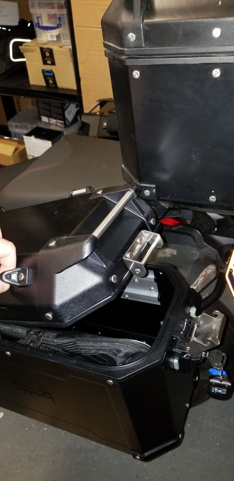

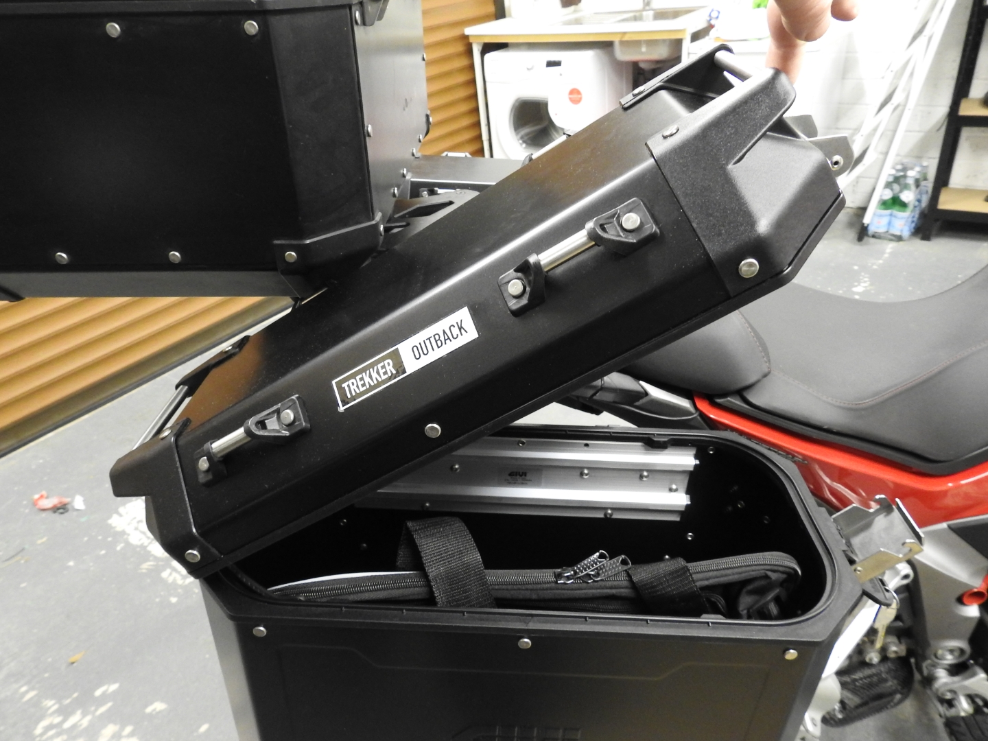

  1. Just a word of warning to anyone considering this combination, the pannier lids can't hinge up far before hitting the top box.
    Edit: They of course can be installed the other way round and then the lids are flexible enough to just graze the top box. Not ideal, but it works. Thanks 636mick! Doh!

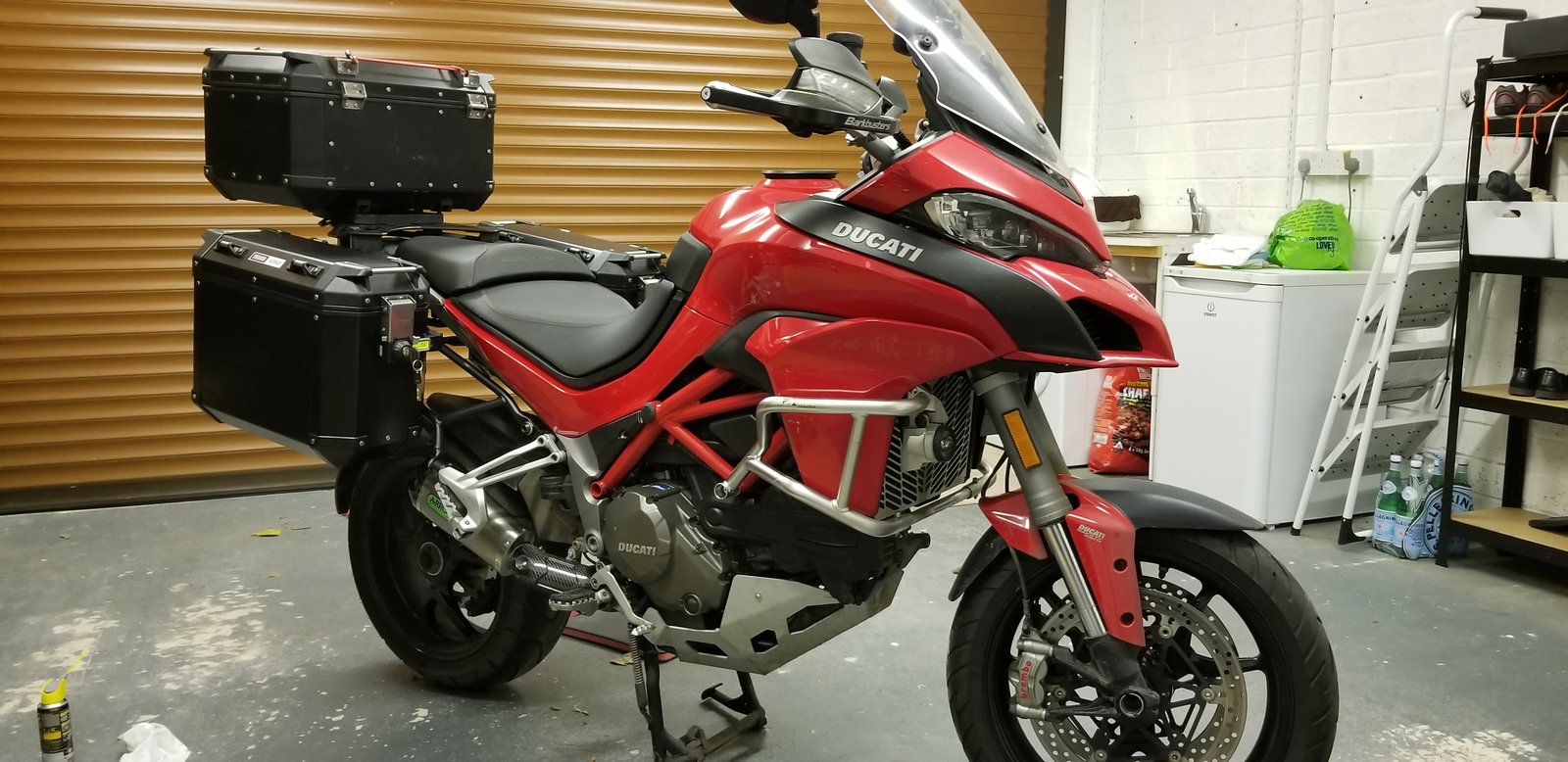

  3. They do look smart on the multi though don’t they :) much better than the plastic offering from Ducati.

  6. You may be able to turn the panniers round so the hinge is towards the front of the bike. As the lids are removable they will twist to miss the box and remain open and attached.
    That’s how I overcame it on my Triumph and I’m guessing the Multi won’t be too different
    Cheers
    Mick.
  7. Well spotted! It's not ideal, but it works. Thanks for that.
  8. out of interest, how have you mounted the top box? I have the sw motech plate and givi adapter, but i'm not impressed with how much the top box rocks back and forth
  9. Yes that's the setup I have. It does move quite a lot when you're on the road (and after having a Ducati OEM box fall off my 13 GT I was constantly checking my mirrors at first), but The hardware is rock-solid, and the rubber bugs are double the size of other Givi ones I've seen, and that's where all the movement is. I've done about 8,000 miles of heavily loaded touring and there have been no issues. The SW motech rack is pricey, but it's a really high quality bit of kit.

  12. Did you manage to get / make a bracket for this. What was the issue with the 950 bracket?
