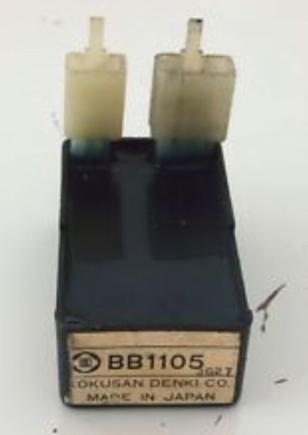

Hi wondered if anyone could assist. The two Igniters on my Ducati 400ss seem to get overly hot I have burnt one pair out could anyone advise what maybe causing this
Are the ignition coils the original fitment? Coils with a lower resistance than standard could cause this.
Thanks Derek, The Coils are are from a Guzzi Nevada so this could be the source. 400ss parts seem hard to come by
