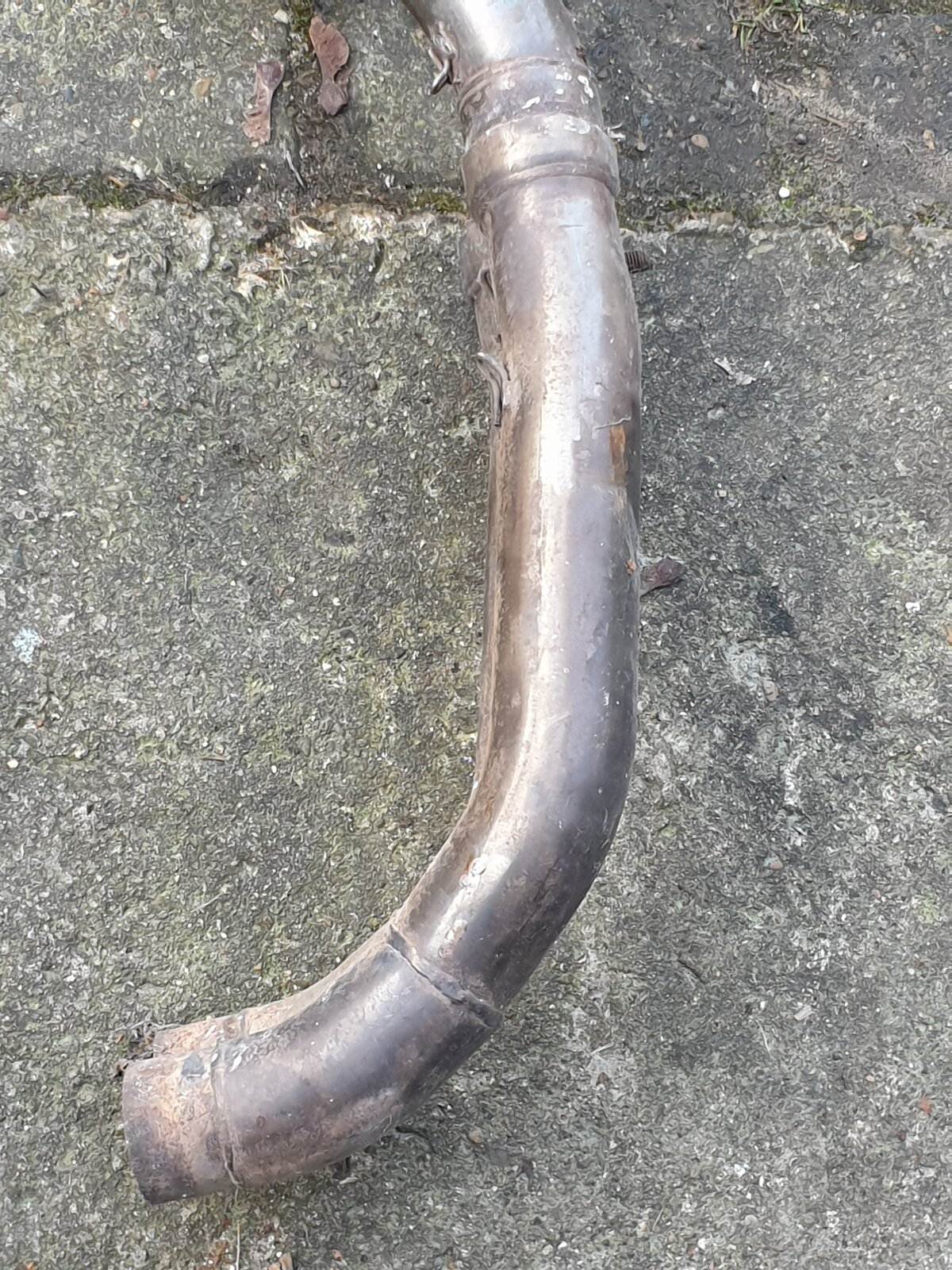

  12. I have a knackered one in the garage that needs some work on it. I will be in there later today so will photograph
    That looks like the later one to me
  15. Thanks mate I’ll check mine when I get home. Confused.com.
