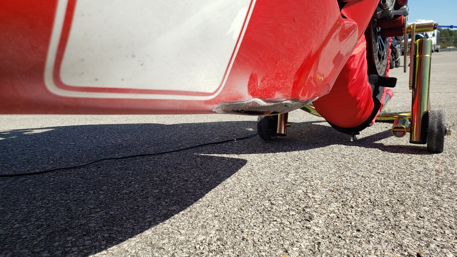

  1. Hello,
    I race a V2 at middle to back of the grid pro pace. Last weekend at Barber Motorsports Park I was experiencing clearance issues and edge grip problems (on a 180 60 17 SC0). I was, and have been, running the stock 5.5 inch wheels. I am debating trying a 6" 1199s wheel to shed a bit of weight and simultaneously gain a bit of grip and clearance by using a 200 65 17 tire at next weekend's WERA GNF. Does anyone have experience with this combo on the V2? Thanks!
