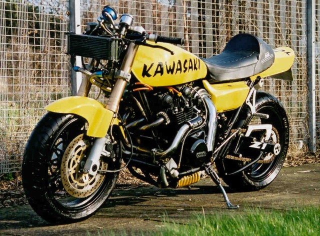

  5. Taking it too far with classic Z1's, what do you mean :Wideyed:
  6. Who the hell painted that KAWASAKI on the tank?
    Was it done in bitumen?

  8. It is old school - painted by hand by a pub sign writer :D
  9. Was he a five year old school pub sign writer? :wink:
    Looks like the broad-brush approach to me.
  10. It was a broad brush, and he has done paintings for Valantino Rossi, Max Biaggi and many others and knows them personally :)

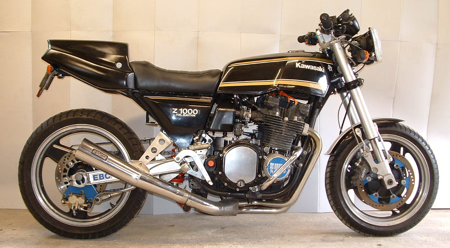

    And I forgot to add an image of the Z1000 I kept for 29yrs as it gradually evolved. Other Bikes came and went but I always kept this one.
    It broke my heart to have to sell it 2 years ago to pay some bills, but I managed to buy my M900 with what cash I had left over from the sale and am now completely obsessed with 90's Ducatis.
