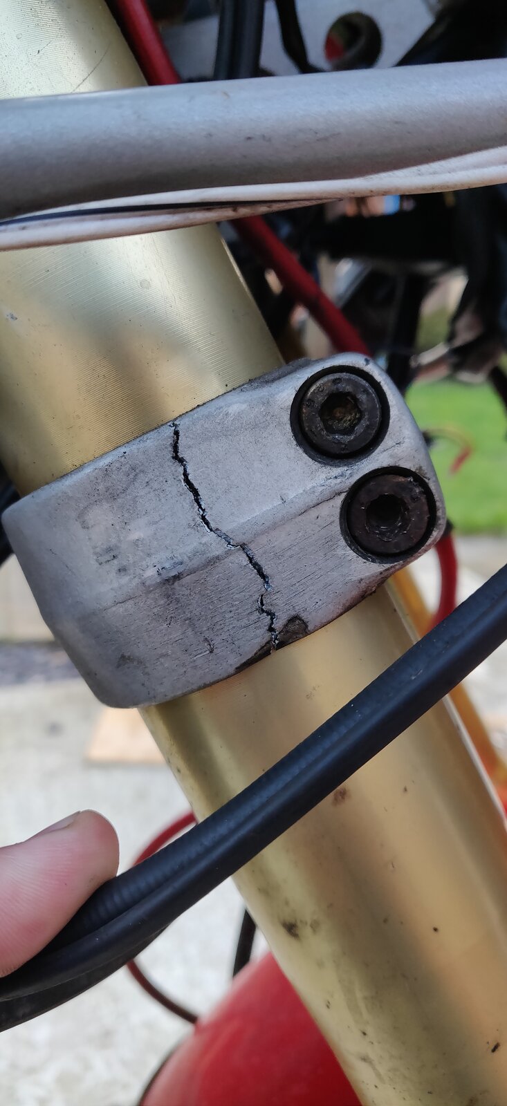

  1. Recently picked up a 600ss and finally managed to get around to taking a detailed looked at it.
    Bottom fixings to the fairings were completely seized so while I got them off, will need to replace them but biggest shock was finding a crack straight through the bottom yoke.
    Does anyone know if there are any after market replacements? Not sure if the stock ones were known for this issue?
  2. That looks like it's been over tightened to me.
  3. Shock fracture, one too many wheelies?
    How are the fork seals, head bearings?
  4. Fork seals seem ok. Same with the rebound but will be looking at those in detail as and when they come out. I think it's just been over tightened but don't know if there's a better after market yoke around or if I just need to trawl eBay for second hand ones

  8. Looking at the state of the Rounded hex bolts in your bottom yoke picture, your SS may have had a previous owner who was not quite up to doing his own maintenance.
    #9 Jon Wright, Nov 8, 2020
  9. Good spot! Hadn't even noticed the rounded bolt. Can see this being a pain in the a*** job.
  10. Should be ok. If you can’t get a hex key to bite, hammer in the next size torx bit that won’t quite fit and it will wind straight out.
    However, with the previous owner potentially more used to cast iron blocks and Whitworth spanners, I think I would go round everything on the chassis at least with a pot of anti-seize and then retorque everything to spec.
