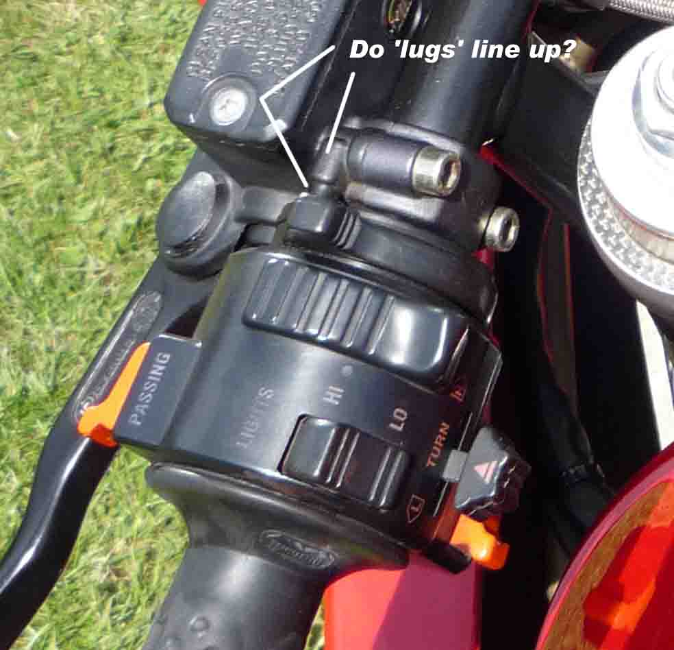

    Just to confirm, I have no problem starting her, she fires up first time and with a bit of throttle she will then tick over at ~1200rpm. If I do apply choke it seems to have to be all or nothing. So Arquebus, I have not halfway setting and it is difficult to set it slightly on etc or indeed halfway. I had a problem with the choke lever so I replaced the lever with a new item and hence my question as I think I may have fitted it incorrectly.
    Looks like I need to take it apart again and double check the cable routing etc to make sure it is OK.

    In the parts manual, there appears to be a screw which appears to go through a disc on the left side of the choke mechanism (disc is same diameter as the choke mech) and into the choke mech........
    There is also a 'lug' on the choke mech which is supposed to line up with a 'lug' on the clutch lever bracketry....see pic....

  7. I have a spare handle bar unit hear(good job I have I i broke the one on the 400 when I picked it up). There are 3 notches on the part that screws the the master and a sort of bit on the rotating part that drops in the notches. I take it the three are on, half on and off. Not sure if this helps, but both mine operate the same as Als, bout 4000rpm on 3000 half and 1400 rpm idle, idles with no problem, but dose need half to start then knocked off after a few hundred yards
