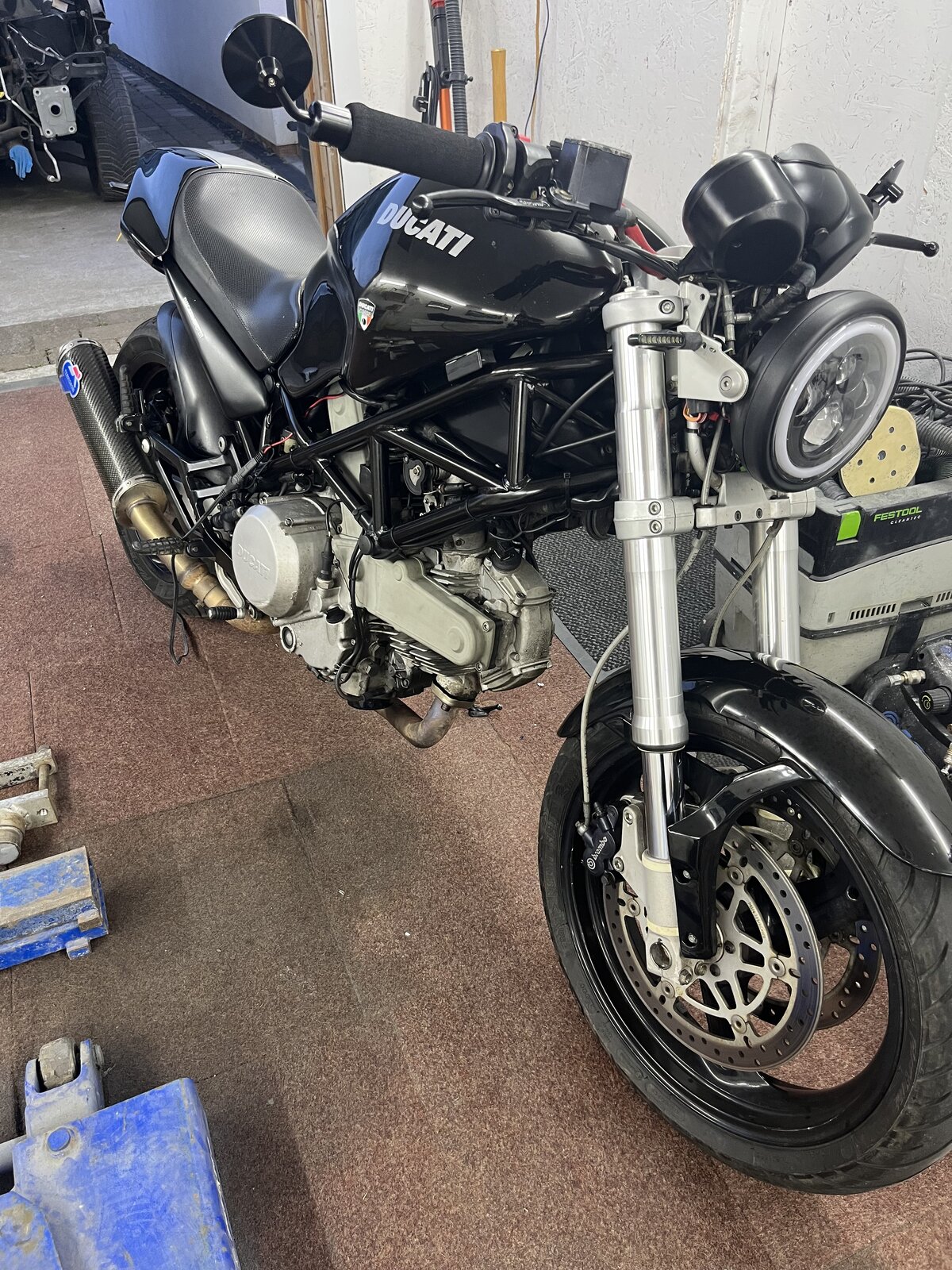

  1. Hi all, I’ve got a 2007 620ie monster with a seized engine. I’ve found another engine from a 98-03 600 dark injection on EBay. My engine code starts with ZDM620A2B the one I’ve found is RA22000583. Anyone know if this will work with no issues?
    Cheers

  3. Thanks. I’ll look into that. It’s more if the engine will work as a straight swap with my electrics.
  4. On mine, the key, clocks and ECU had to match , m800 into m1000 frame

    It could be fine but I would be careful in this situation as it isn’t a cheap engine (looked at the item on ebay).
    I thought that anything with an engine number that does not start with Z means it wasn’t made in Italy (unless someone knows better), so it could be a variant made in another Ducati engine plant for a different market. Nothing necessarily wrong with that but it could potentially have different compression ratio, valve lift/timing, gear ratios to meet local fuel and emissions regulations, and so may not work optimally with your ECU presets.
