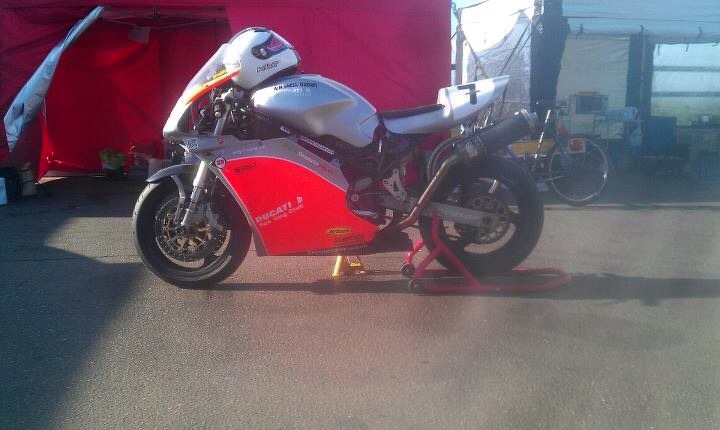

  2. IIRC the ST2 ones drop straight in, as do other adjustable ,monster and SS ones. Just cant use superbike (1098 etc, not sure about showa 916 tho) or Öhlins forks without yokes or some other adjustments. ST and SSIE ones may be longer but just poke out the top a bit, no problem.
    m620 with ST2 forks
