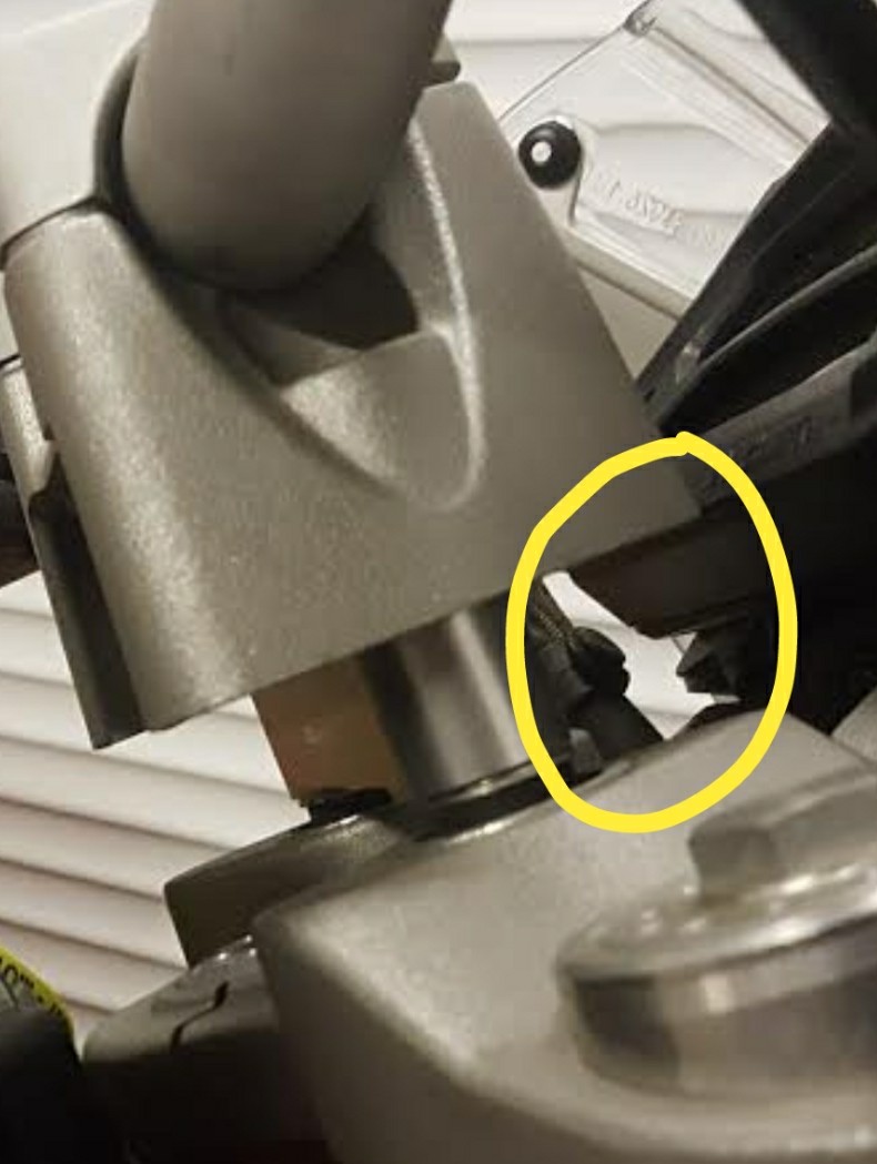

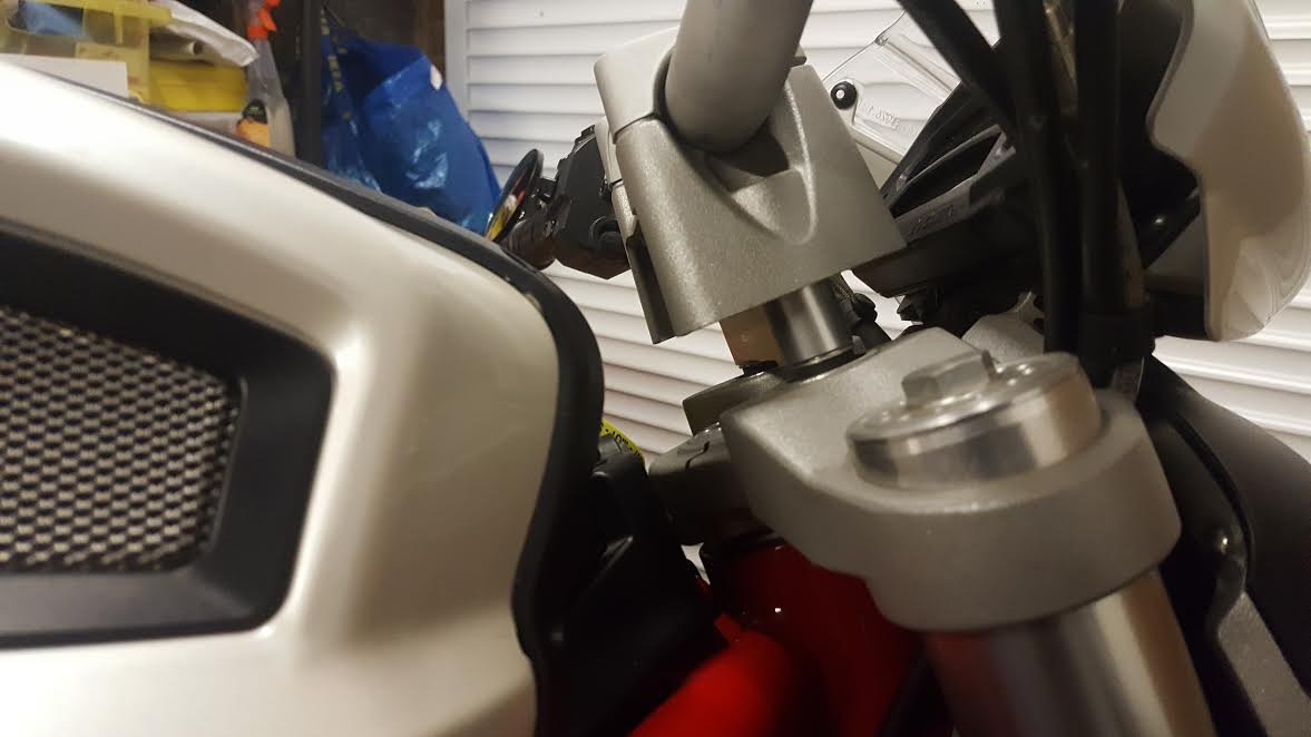

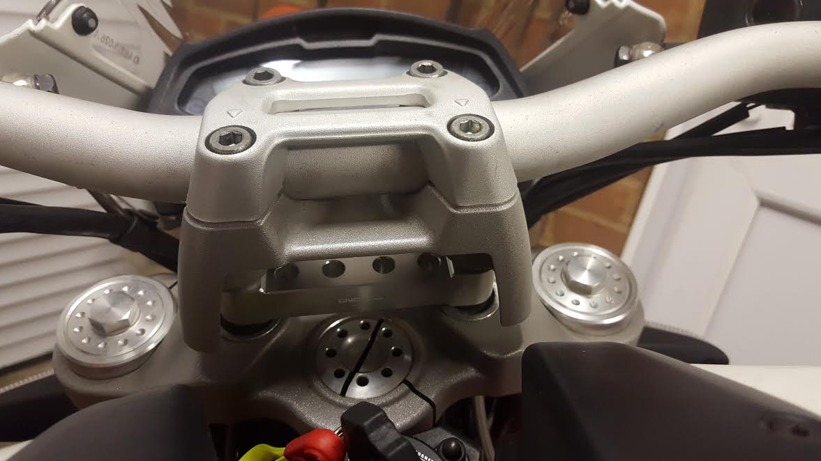

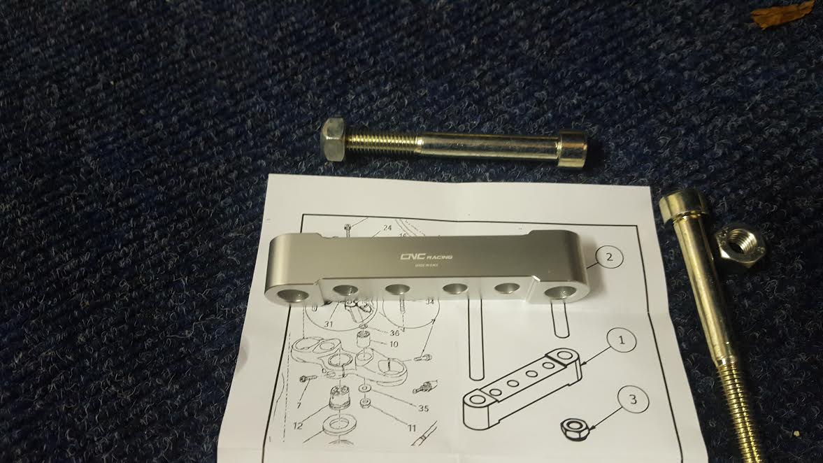

  4. I bought a CNC riser block for my 796 monster . It uses the original bars, just raises them up a bit .
  5. How’s the increased bending moment on the bolts into the yoke in an emergency stop?
  6. Agree - this bit's definitely not meant to be air!!
  7. Exactly.
    The original risers bear on the yoke directly so in a panic brake situation the overturning moment is reacted by compression on the yoke and tension in the bolts.
    In the case of the aftermarket risers, there is no ability to react that overturning moment apart from bending of the bolts.
  8. Looks like the usual anti-vibe stuff going on as well there for the two yoke bolts, but agree; all the moments, stresses, etc change when one fits non-standard (& therefore non-designed for purpose by the bike designers/engineers) stuff...
