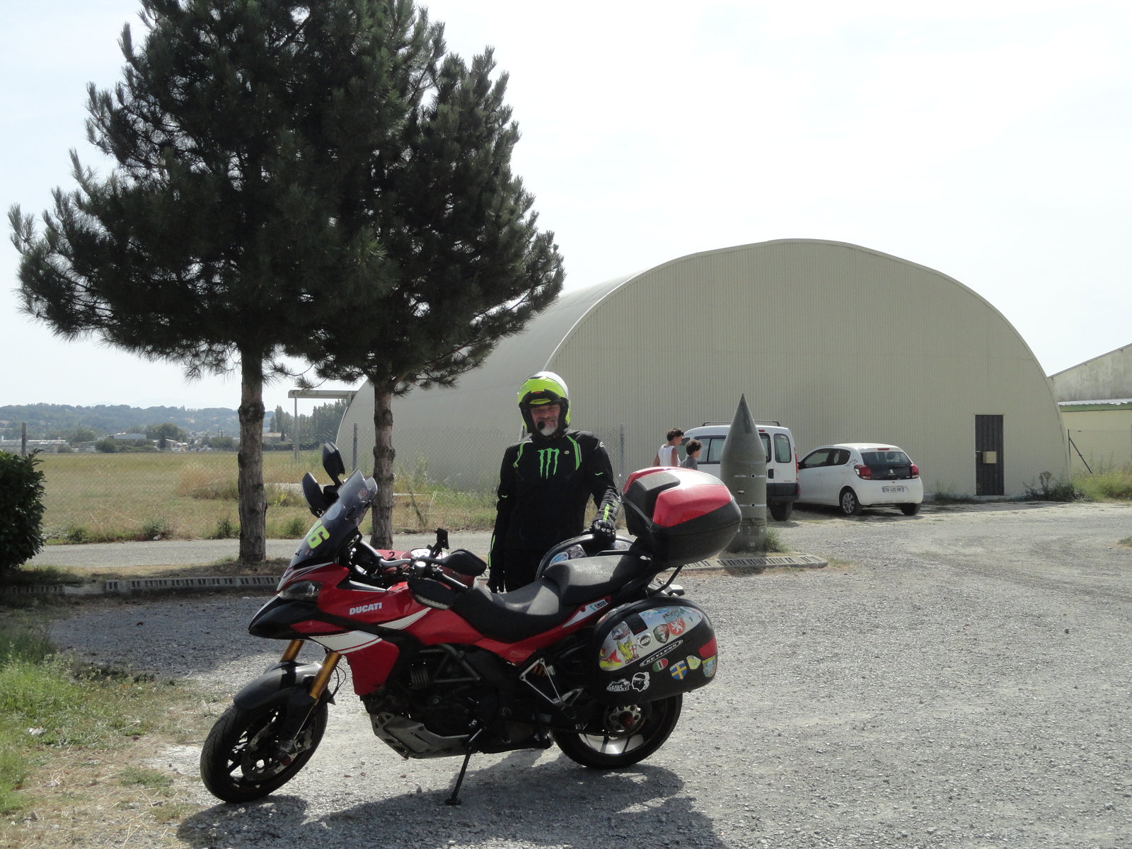

    My bike is a 2010 S with the touring parts added and the Ohlins semi-active SCU. I have a Mivv system but for the last couple of years I have just used the standard exhaust. My wife and I tour Europe 2-up for our holidays and this year having moved into semi-retirement we have had the time for longer tours.
    As I use my bike in km, I filled up the odometer last year and found that when it gets to 99999 it just stops counting up. I passed by Bologna so I dropped in to the factory to ask how to reset it. "Buy a new speedo" I was told.
    So this year with virgin clocks fitted we started this year's touring. New chain (the fourth since new) new belts and a check of the valves (one shim changed so far since new) and new for this year Garmin bluetooth valve caps to talk to the Zumo 660 on my left bar. I also have a Tomtom 430 front and centre for primary navigation.
    I use Michelin Pilot Road tyres but the Road 4 front does not suit the MTS (good grip but slow steering and weaves at 180 km/h). Luckily there are good stocks of the fabulous Road 3 front tyres and the Road 4 rear works well with it.
    After our first leg to Jerez and back to Le Mans I fitted a new rear tyre while in France before heading to Mugello. We took ferries from Italy to Barcelona via Sardinia and came back to UK at the end of June. For our second trip we rode to Brno and then Warsaw, Vilnius Gdansk, Szczecin, Berlin, Bautzen and back. New front Pilot Road 3 fitted and off to the Rhone Alps, Carcasonne, Lyon, Switzerland and then Misano before back to UK via Mayenne.
    That is this year's 28,000km or 17,500 miles in a paragraph. That is also 14,000 miles on one rear tyre which is one of the reasons I like these Michelin so much.
    The bike is still fabulous. Comfortable when ridden all day and day after day. We lived off the bike and the 40kg of luggage for weeks at a time (we do stay in hotels and B&B's) and the bike shrugs off the load. After seven years the bike still feels like the high speed extension to my arms and legs that it did back in 2010. The fourth chain is still good and it's on the second set of sprockets. It has never used any oil, or none that I can see between changes.
    I have had only one component failure. One of the bolts holding the side stand bracket to the crankcases sheared off flush. Maybe a few too many enthusiastic strappings down by Brittany Ferries. This left the bike leaning over a bit too far on the stand until I could get back my garage. The drilling out of the remains of the bolt was a bit awkward.
    Best add-on is still the Ohlins SCU. Adding the semi-active operation to the already wonderful suspension was a revelation four years ago and it still is. If you are lucky enough to have own an Ohlins equipped MTS1200 it should be on your bike or on your shopping list. MRA touring screen with an MRA X-wing added to the top (not a recommended fit) keeps the wind noise below where I need earplugs.
    Givi E42 panniers on SW-Motech rails with a Bagster tank bag and the DP top box carry our gear. Muc-Off PTFE dry chain lube every 1500 miles or so gives me plenty of chain life.
    I could go on and on but suffice it to say I still believe my MTS1200S to be the best bike ever made and I cannot think of another bike that could replace it. I'm planning next year's tours.
