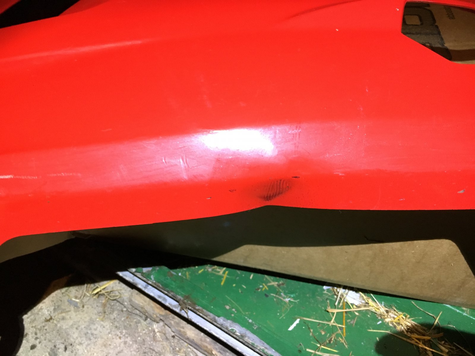

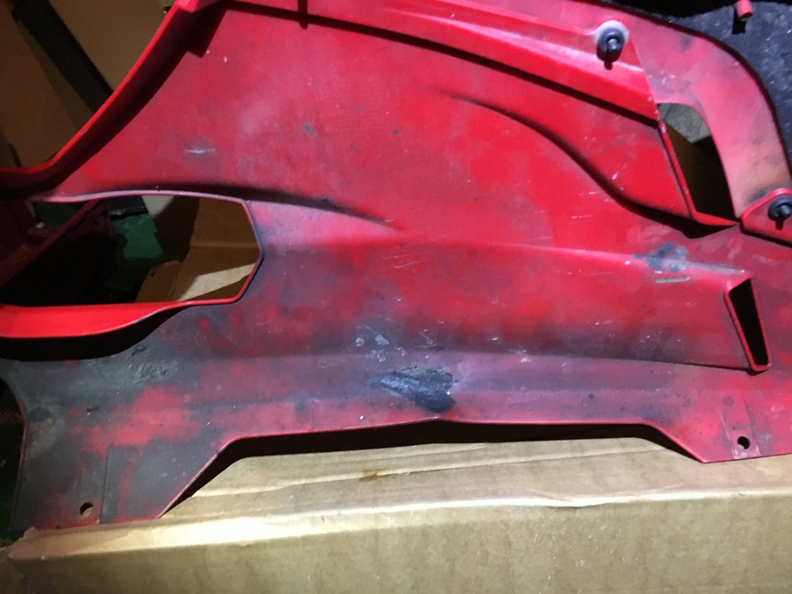

    Pics are of right hand side if looking from the front of the bike I m running a full EVO 70mm exhaust which is melting the lower fairing eek
    Has anyone else had this problem ?
    If I bought carbon ones does anyone know if they would melt as well

  5. It looks like it's been whacked upwards Wazza? Has this not caused the system to touch? It's a strange place to touch in the middle of a straight run. :Wideyed:
  6. This is the first time I ve had the fairings off since getting it in the summer so you think the fairing may have been already been damaged I never thought of that...
  7. It shouldn't have that kink in it. They are flat bottomed.
  8. I thought the burning caused the kink
  9. I don't know Wazza, but it shouldn't be like that.
  10. I agree mate thanks

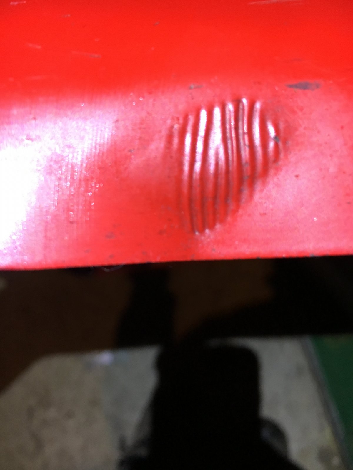

    Looks like melted to me
  12. Yep, it's definitely been touching. But the indentation is very sharp and I think is more the cause than the effect.
  13. Looks like the rubber bung which spaces the panel away from the exhaust, and presumably acts as a bit of a heat shield has gone missing, allowing the small bracket attached to the exhaust, that the bung fits into, to come in contact with the panel and subsequently melt it, had the same problem with my 1198.
