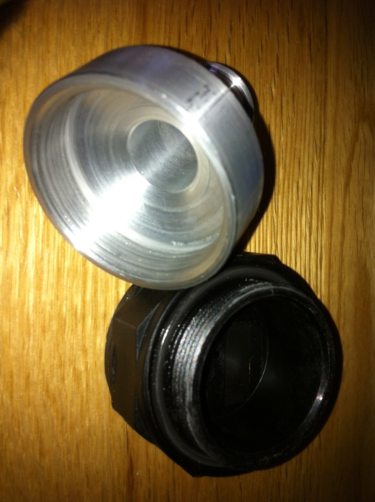

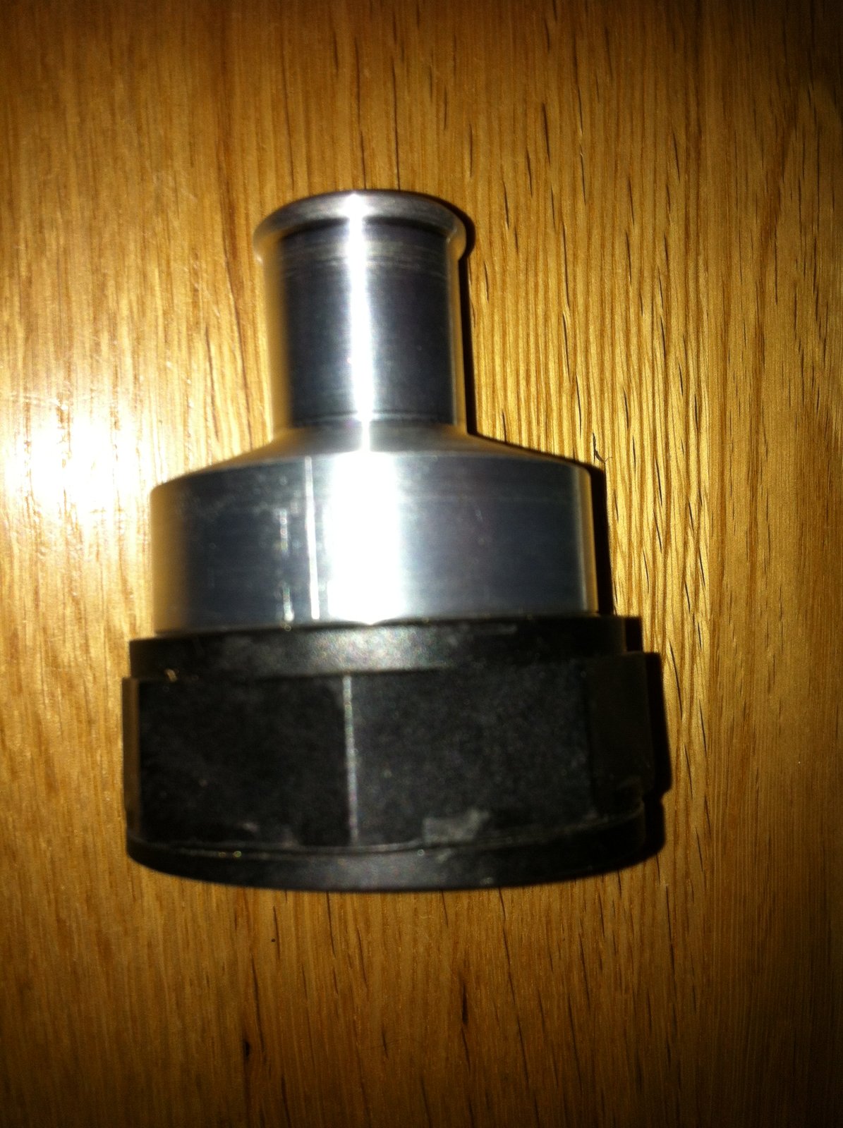

    the original valve inside the airbox is hard to find i used a crankcase breather from a 999, cut it in half turned it around and turned a alloy piece for the pipe mount

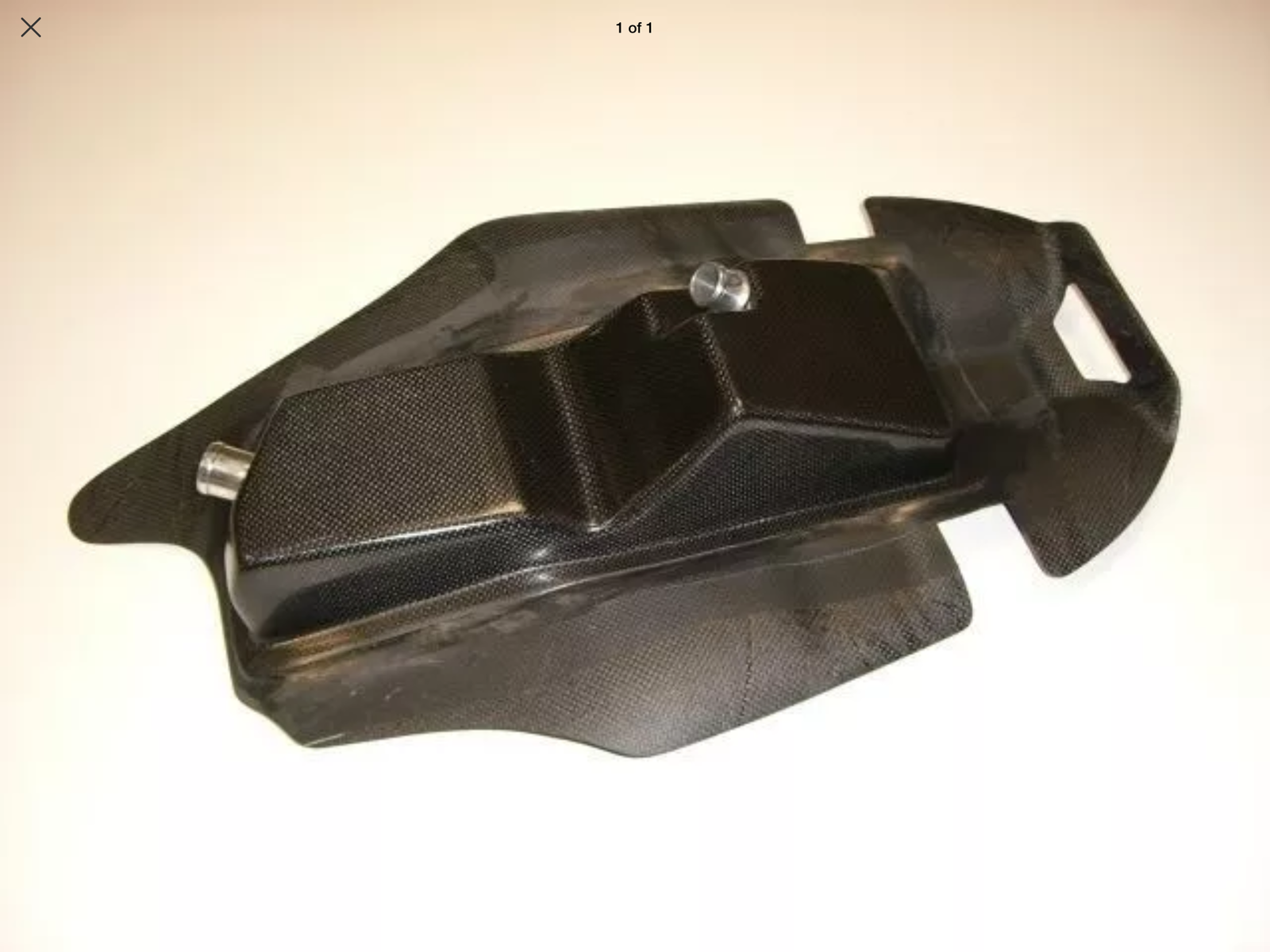

    This is the box in question...
    Thanks.
  4. I use the angled RS connection, my friend uses a straight connector, no probs with either.
    As said don't bother with the correct RS tubing as it's stupid money.
    Take it the shallow box means the computer can stay where it is.
    My friend has the shallow box, I have the deep one meaning huge problems moving the computer in front of the steering head....

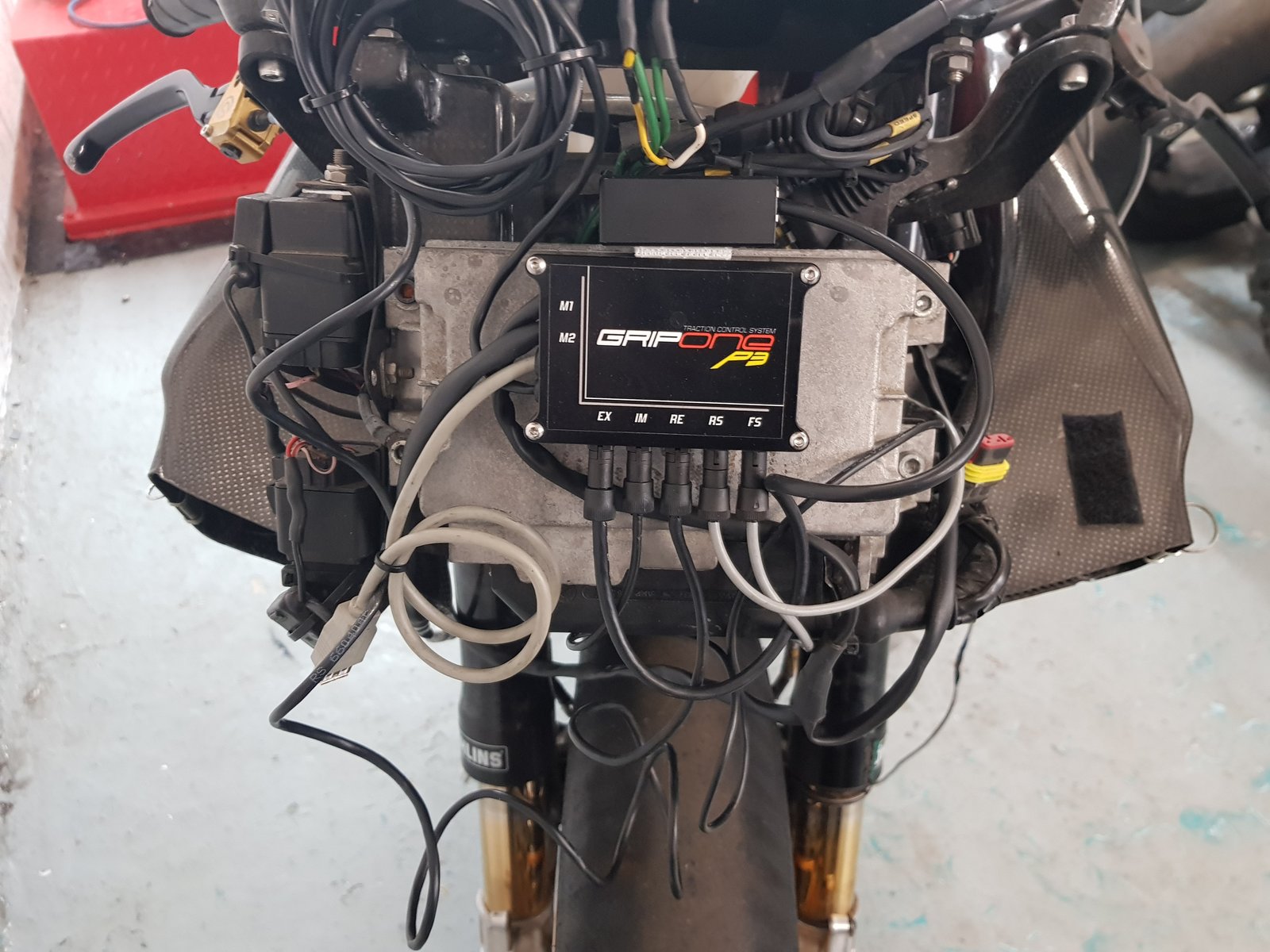

  7. wait til you add traction control....:eek::eek::);)
  8. Can a 999 breather be used on the engine, with the internals removed?

  10. 999 crankcase breather cut back to expose reeds then a alloy adaptor turned to fit breather pipe new 043.jpg

  15. @andyb, thanks for the info. Back home now and have had a look at the std crankcase breather and how you did it. So, the alloy funnel you made is a mirror image of the top bit you cut off?
    Clever, as this way both halves are screwed together either side of the air box and fixed into place.

  18. that way the breather works the other way around lets pressure vent out of the crankcase but keep the airbox pressure in the airbox.....simples
