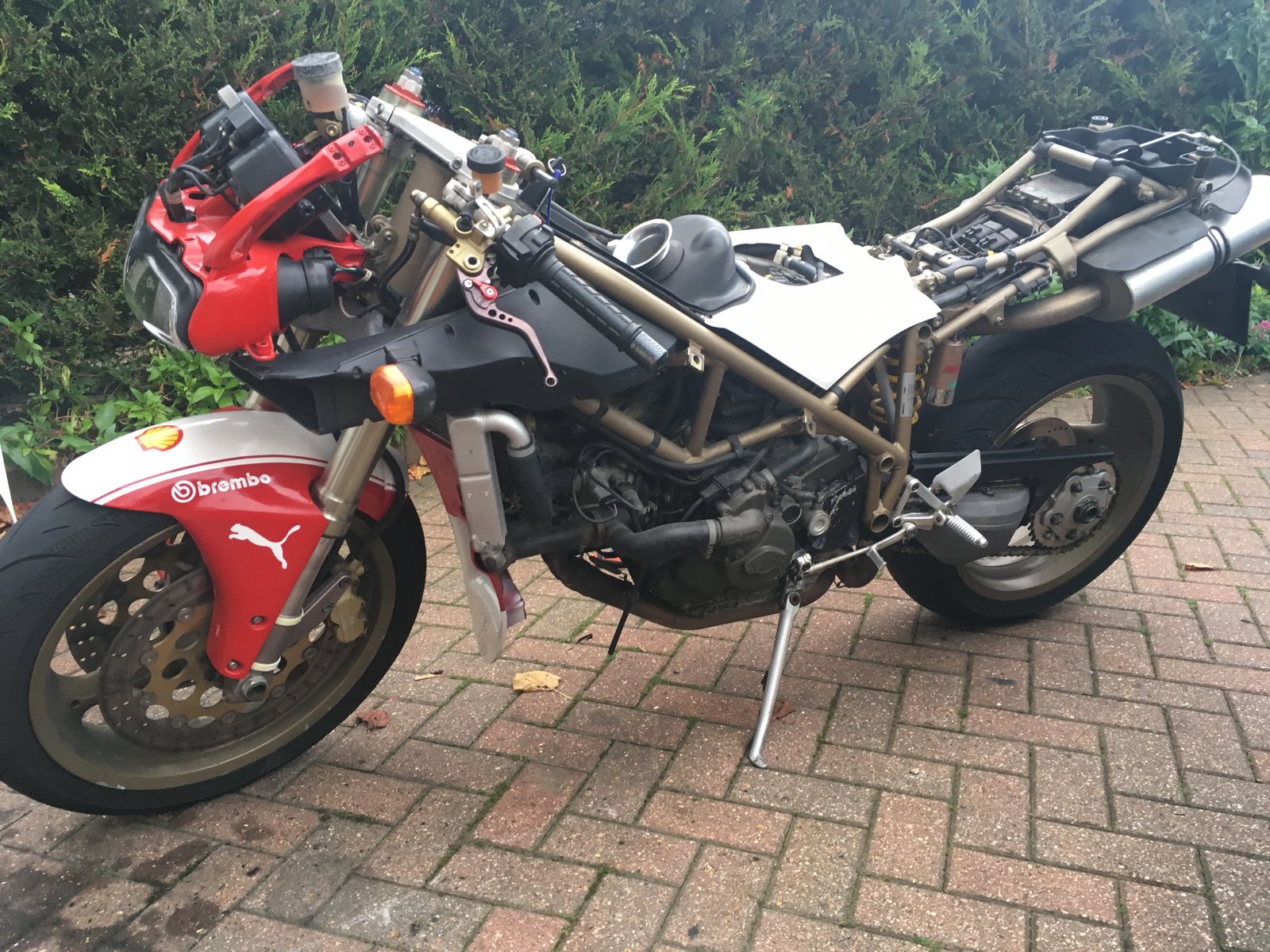

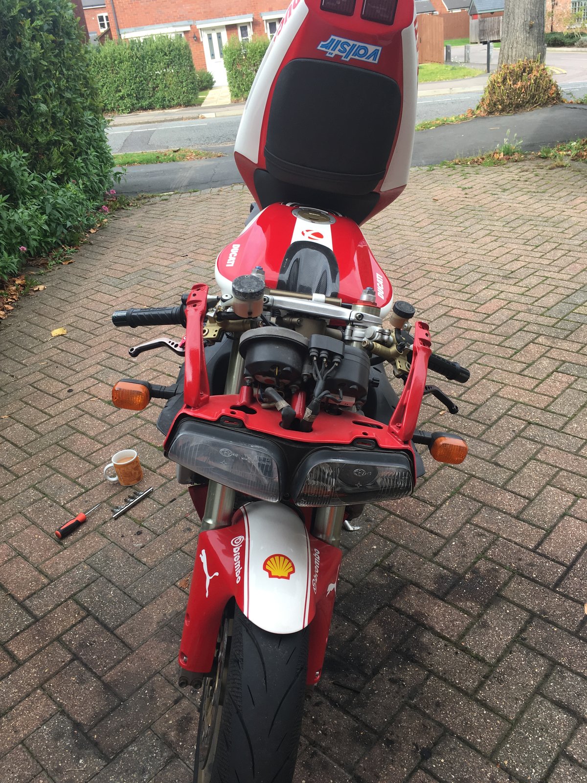

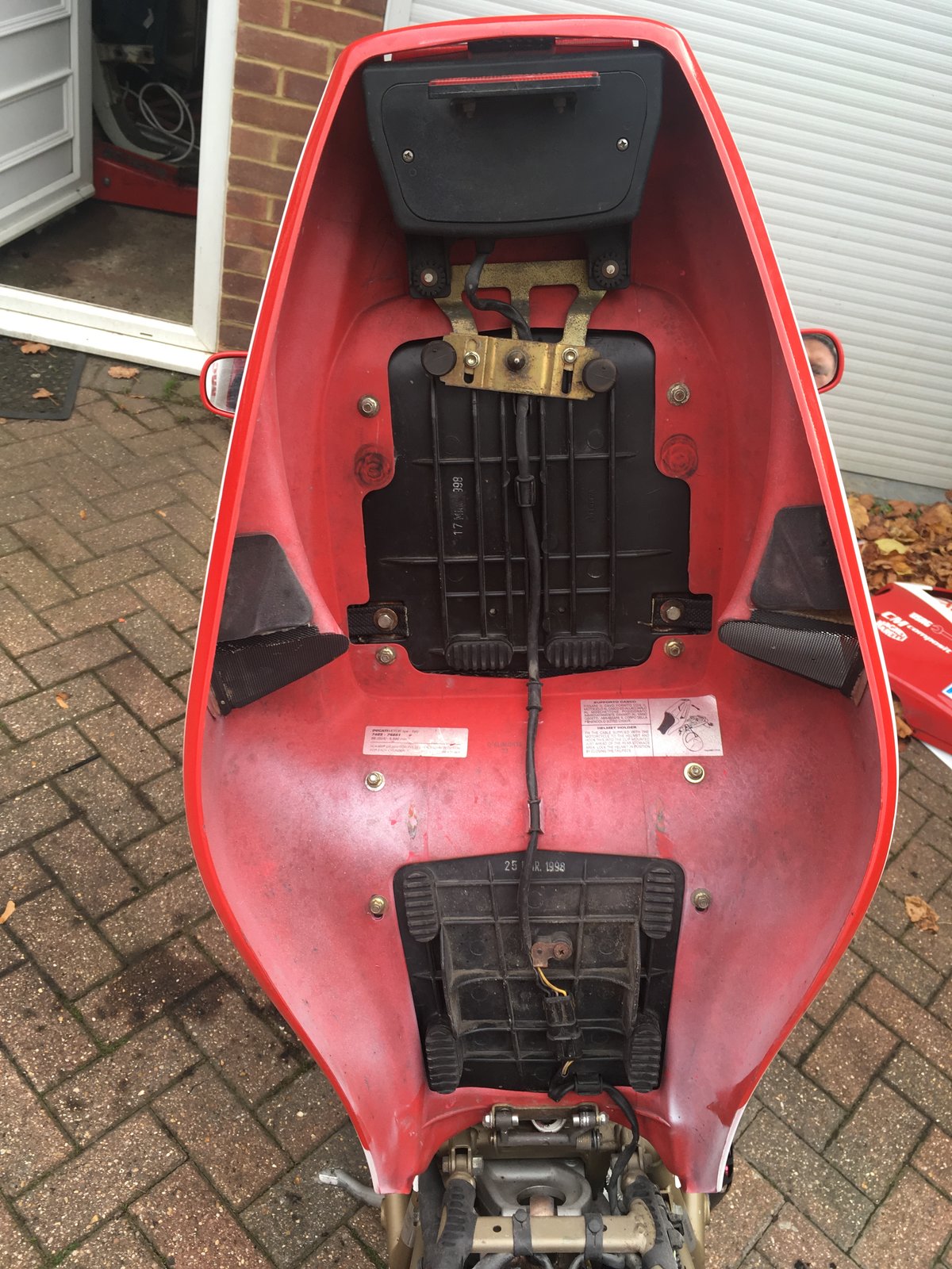

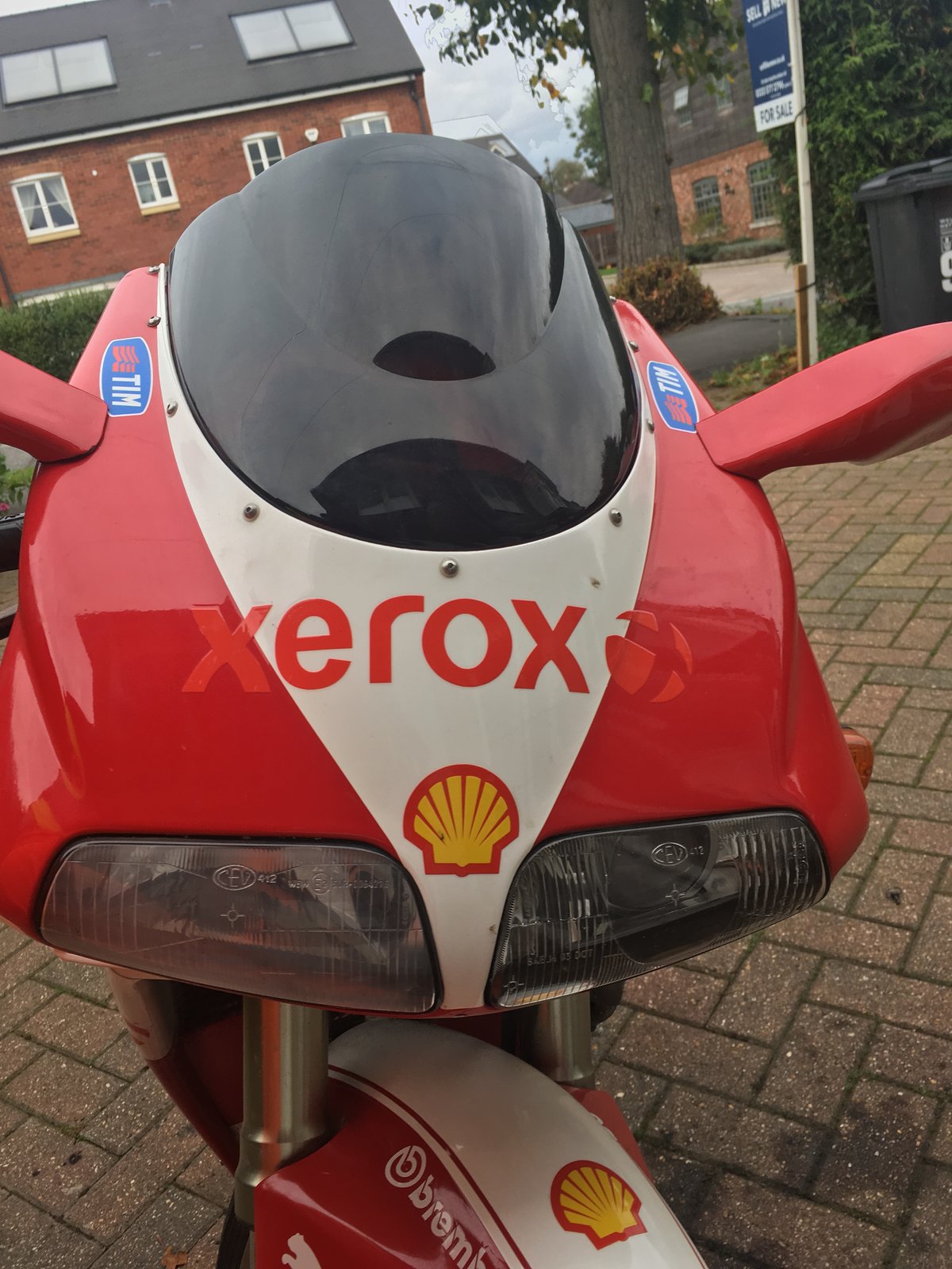

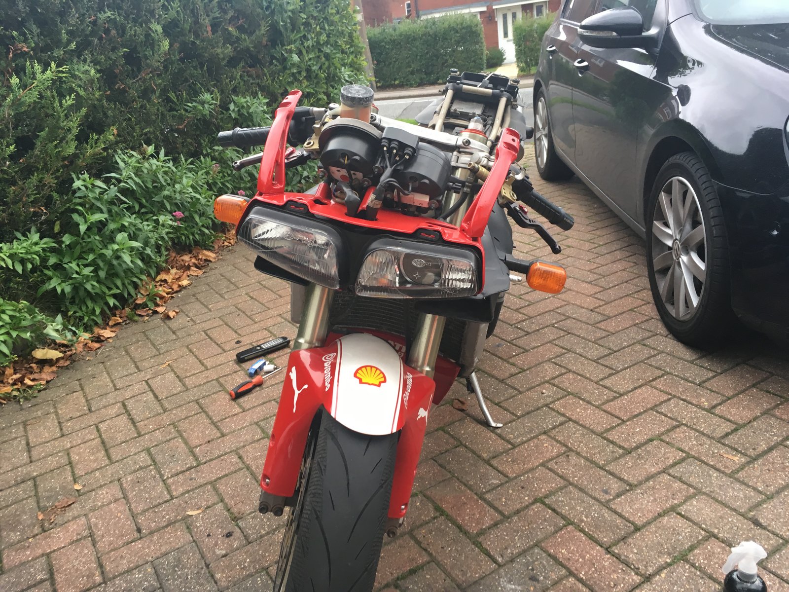

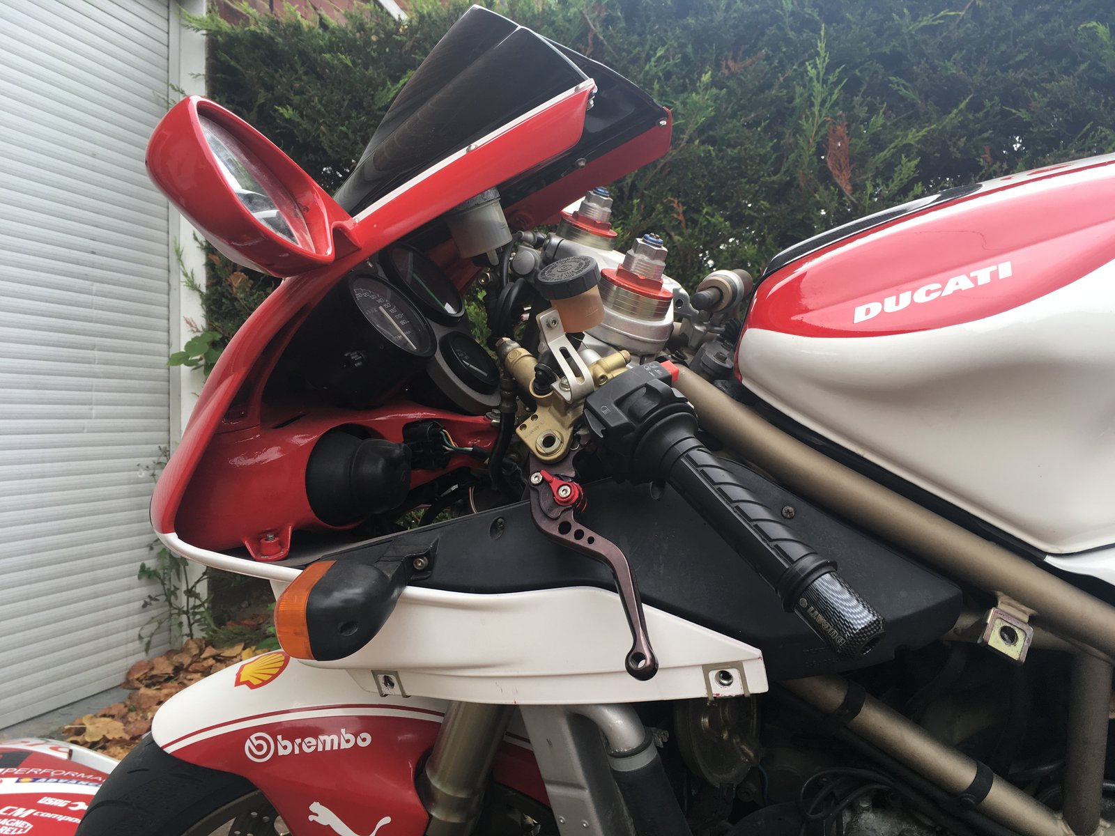

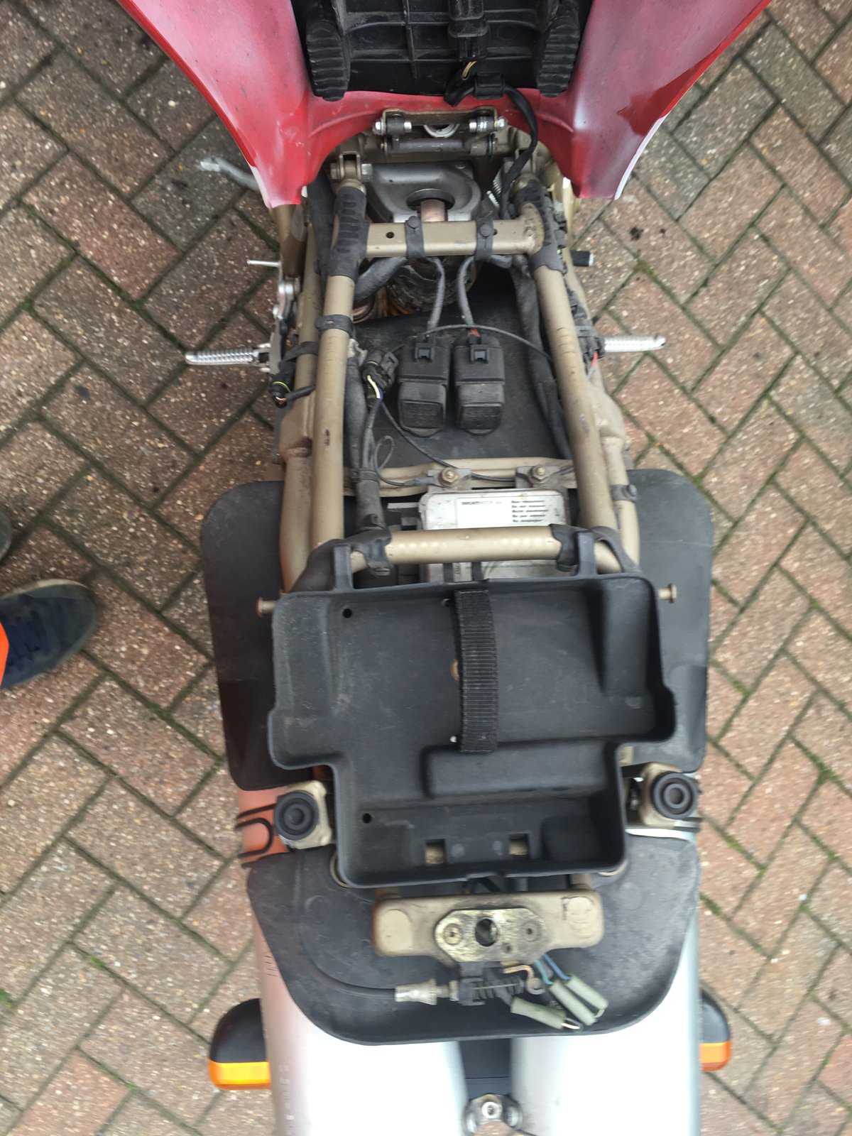

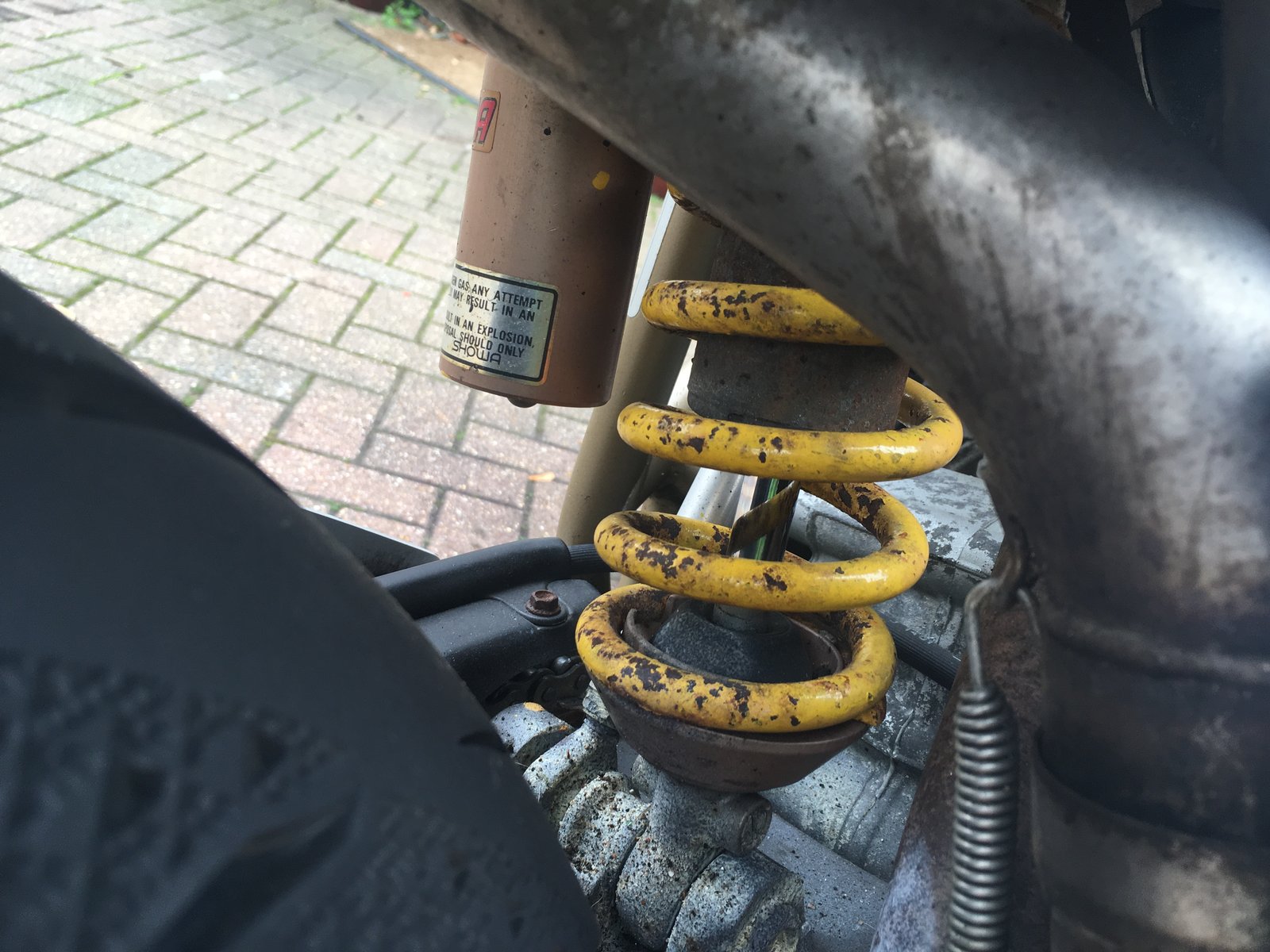

  1. IMG_5127.JPG IMG_5130.JPG IMG_5132.JPG IMG_5134.JPG IMG_5127.JPG IMG_5130.JPG IMG_5132.JPG IMG_5134.JPG IMG_5136.JPG IMG_5137.JPG IMG_5140.JPG IMG_5148.JPG IMG_5149.JPG IMG_5150.JPG IMG_5152.JPG IMG_5153.JPG IMG_5154.JPG IMG_5155.JPG IMG_5157.JPG IMG_5158.JPG IMG_5159.JPG IMG_5160.JPG IMG_5161.JPG IMG_5162.JPG stripped the fairings off for a good clean down , bike was very dusty from being sat in a kitchen , plus I wanted to check it over
    Really impressed with what I found
    Really original bike (bar the paint job)
    Rear shock needs refreshing as the salt has got too it ,
    The fairings although painted are all genuine ducati panels ,

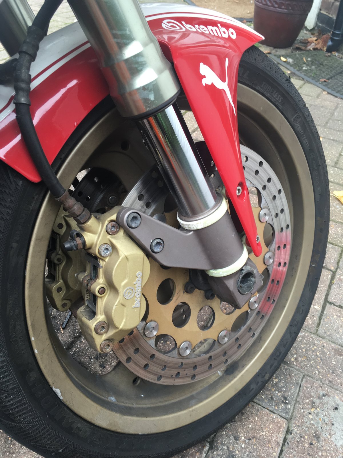

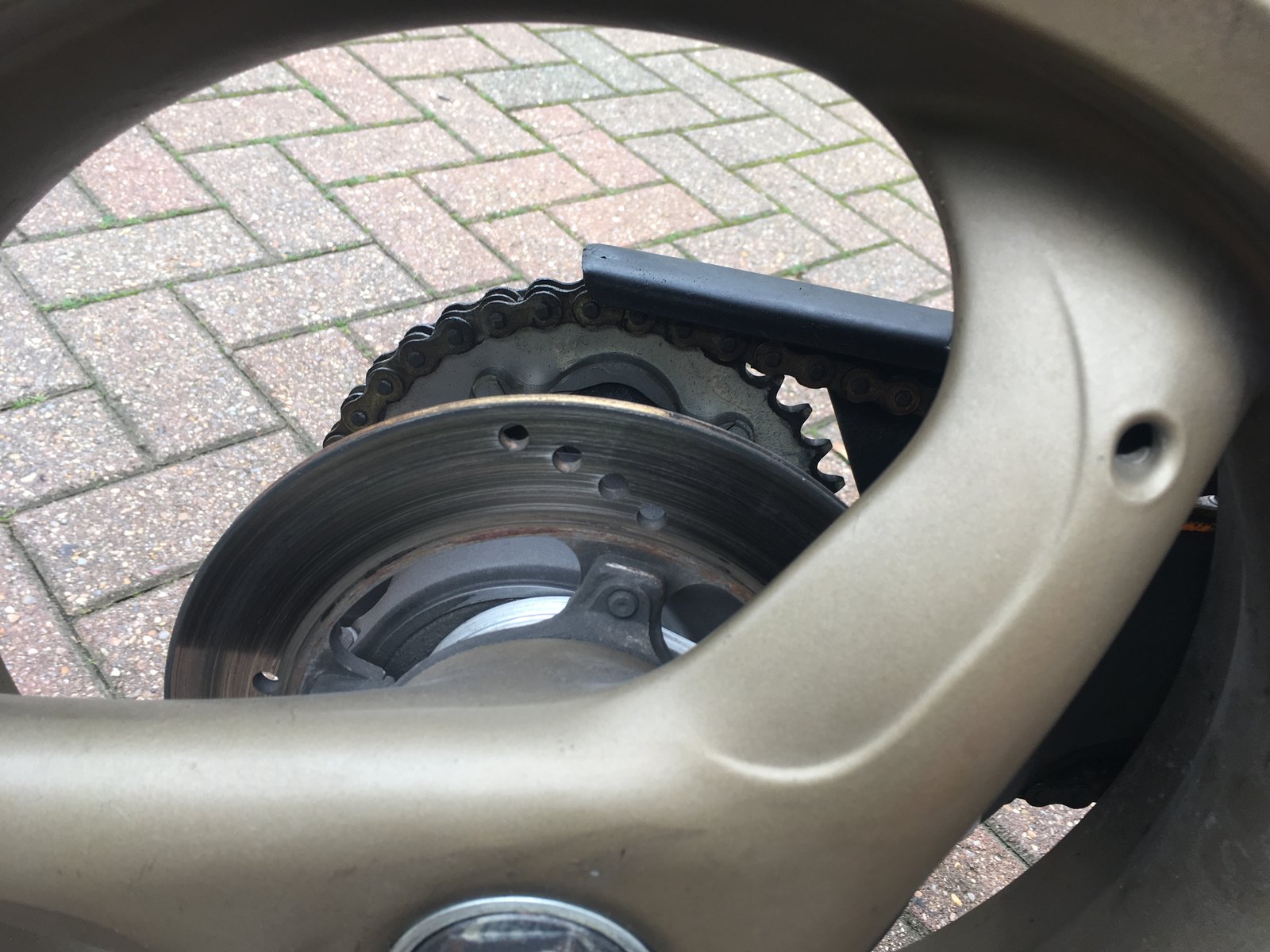

    The wheels are damaged and look like someone fitted the tyres with a bread knife ,
    Chain sprockets and tyres are all bang on ,

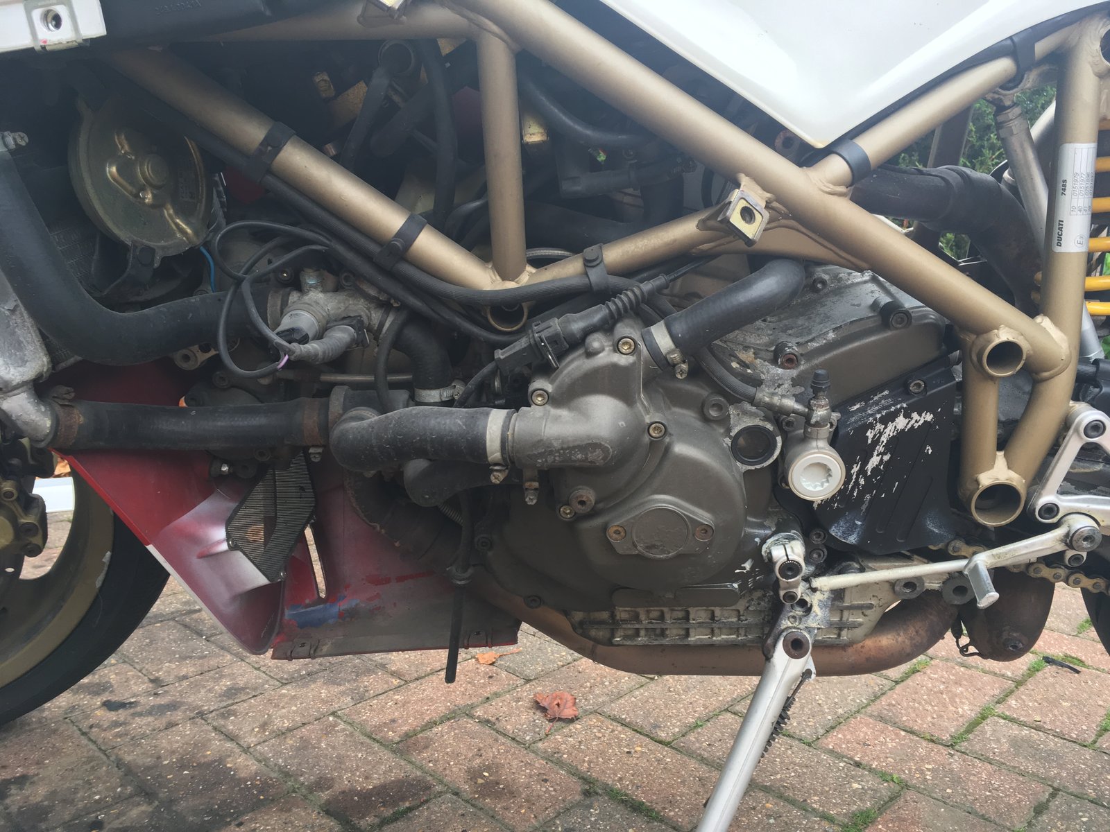

    Engine paint peeling and the odd bit of rust appearing on frame round the welds but only surface nothing to worry about ,

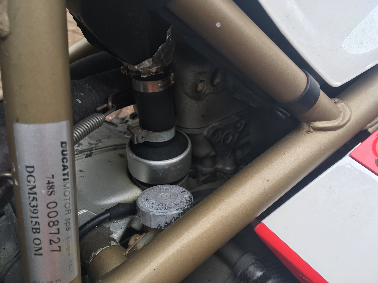

    Airbox seal is knackerd I'll order one of those
    and air filters are crumbly so orderd some piper cross ones ,
    Gear leaver rubber also on order
    Amazed it still has the standard rubber brake lines on it and clutch line so I'll change them for braided and new fulids
    Better recoup some cash for belts plugs and oils then I'll powder coat frame and wheels over winter and save up to respray the bike to original red

  5. The headlamp holder would look better if finished in the correct colour, in your case Gold.
  6. Yeah soon as iv found a paint code I'll do that gold , I plan on going back to complete original with period mods (brake lines termis etc )
  7. ICI have a paint chip for the Gold as also the matt lacquer required. Cheaper than going to some bike paint specialists.
