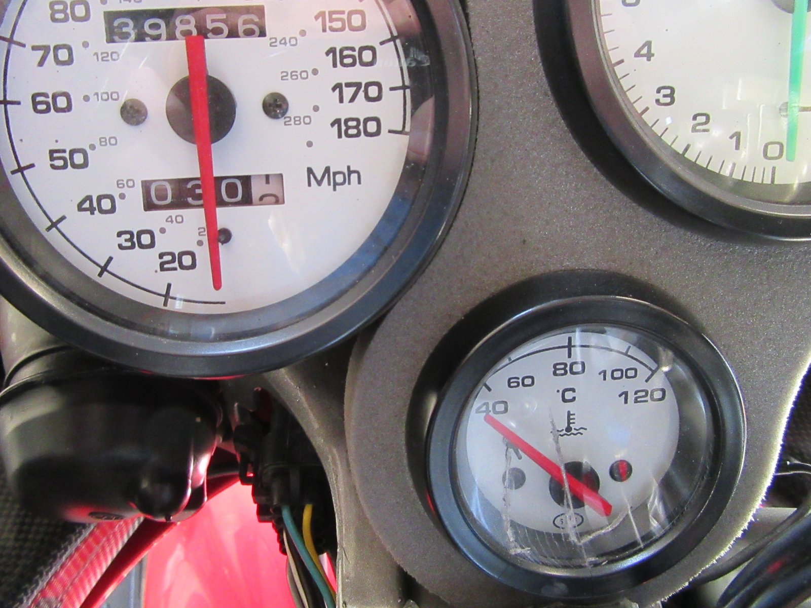

    I may have a plan B as I was mainly trying to get a replacement temp gauge ( cracked lens).
    I think I've found a complete new set for reasonable money and am thinking I can strip out the temp gauge and sell the remaining parts to make some of the money back.

  11. Gauge part numbers are
    40440061A for Centigrade and 40440071A for Fahrenheit, I wonder how much just the gauge is new? If you ever see a white one let me know, I have the same problem but I've never seen white clocks on any other 916/748 and never seen them for sale
