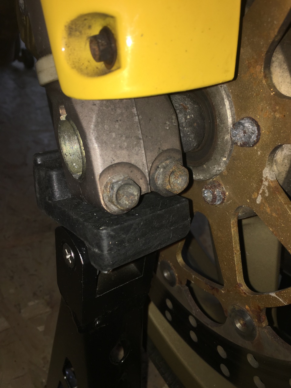

    The state of the fasteners is just diabolical. The zinc galvanising has long since vanished, taken by the elements, there's also 20 years of muck in the recesses a quick clean never got to. There's corrosion on the disk rotor holder around the bobbins - although the bobbins all turned freely and weren't seized as I'd gone over them as part of the recommission last August.
    Having read all the horror stories on here about seized bolts and rounded heads due to the arguably sub-expected standard bolts used by Ducati in the 90s I have to admit I was relieved when they all came undone undamaged (not without some effort and use of penetrating fluid mind you). The wheel dropped out, the spindle was knocked out and the rotors came off the wheel (this was the hardest part, undoing the rotor retaining bolts).
    There's a bit of corrosion on the front spindle but nothing that can't be removed with fine grit emery cloth and wire wool.

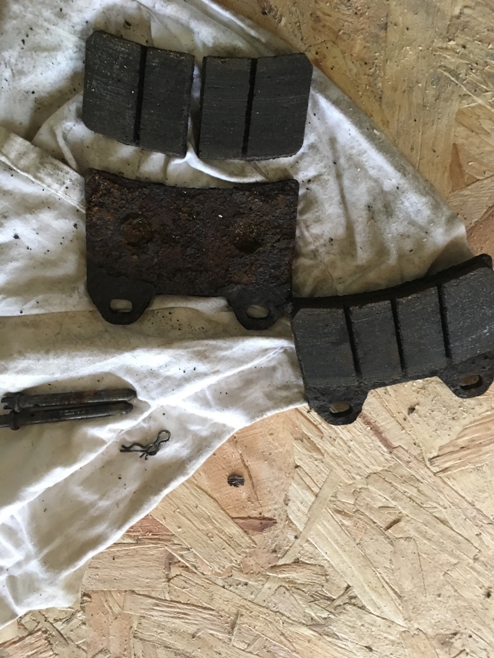

    Remove the brake pins and spring and pop out the pads :scream::scream::scream::scream: O M G ....... and I'd ridden several hundred miles with them like that last year! Surprisingly they still worked. I know as I'd been
    a) testing them when I first put her back on the road, and
    b) practicing my emergency stops - just in case I ever had to do one.
    As you can see, after 20 years - yes these are the original pads, it's a low mileage example - corrosion has caused the pads to come away from the backs, the pads to break in half and on one side the metal back had even corroded through:scream:

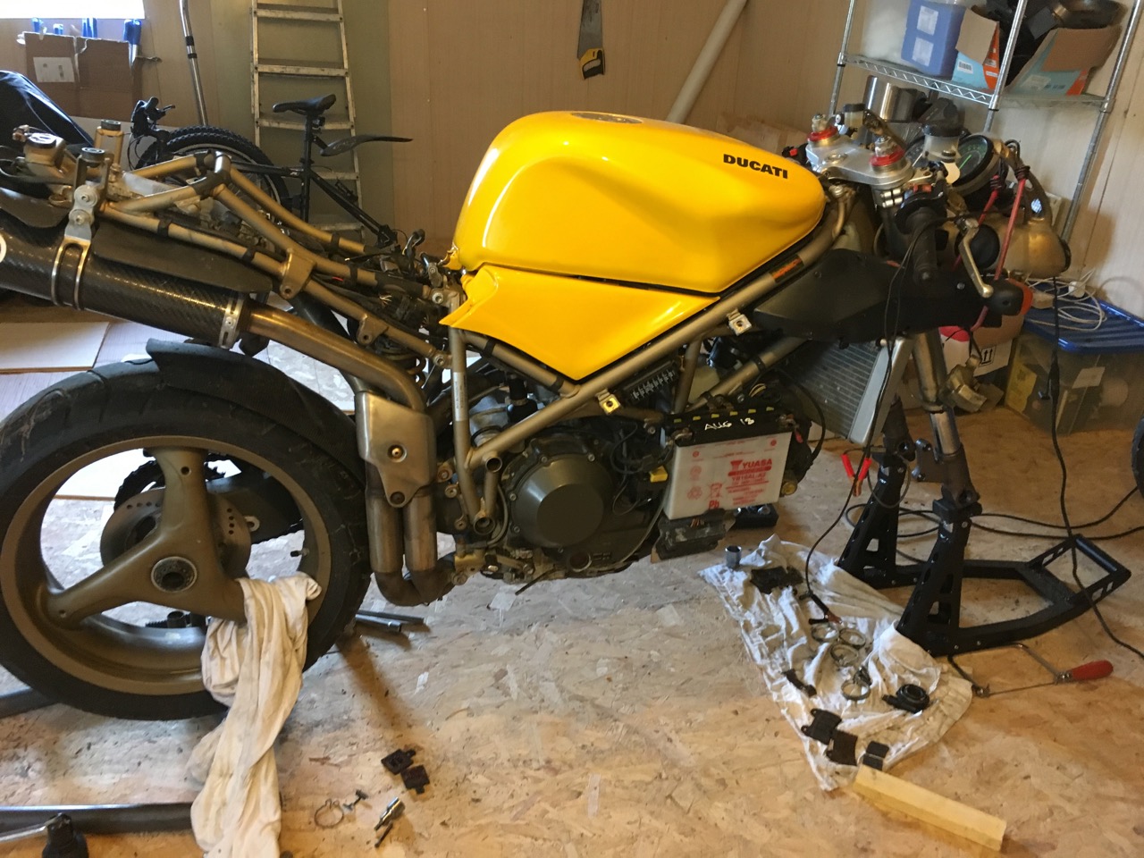

  3. Sell probably. I can't justify keeping it as a work of art, although that is tempting, it's just not the right sort of bike for around here and would continue to be massively underutilised. My M1100S is my go to bike at present although that's hardly surprising as the 748 is in 500 pieces all over the garage with no front end, rear end, crankcases, rocker covers etc etc, just an engine in a frame suspended from the ceiling by straps like some in some S&M dungeon

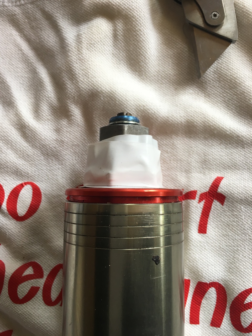

  8. Next job, drop out the front forks. First, the fork tops got loosened while the forks were still held in the headstock, then pinch bolts undone and twist & slide out the forks. Relatively easy, no stripped bolts or heads either :):upyeah:.However, what I should've done was to wrap the fork tops in insulation tape before applying the wrench. They came undone, eventually, but were bloody stiffo_O. The first one got ever so slightly damaged. The second one I wrapped in tape so no damage.
  9. You are supposed to undo the top clamps before undoing the fork tops as it releases the pressure on them. You just leave the bottom ones done up tight.

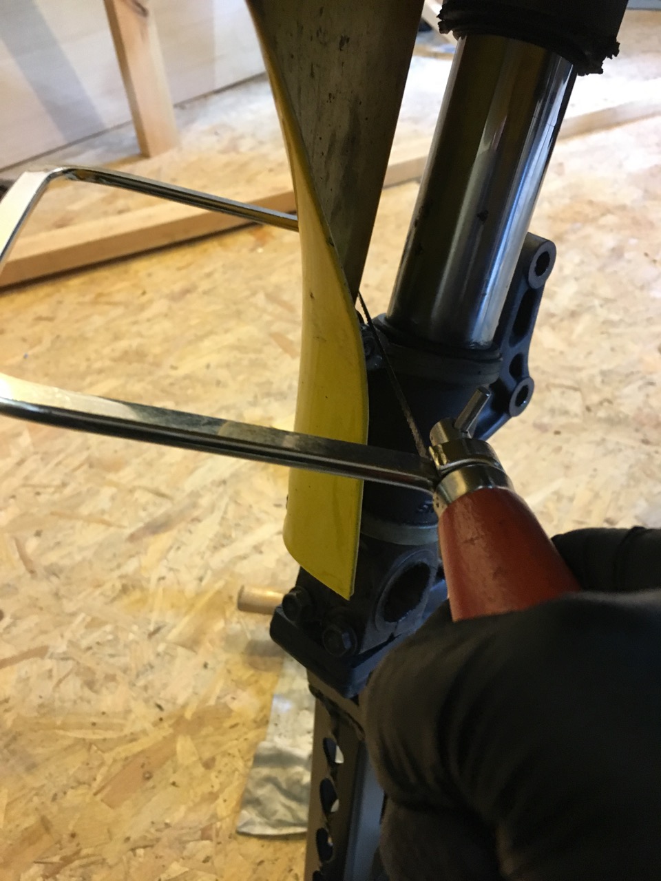

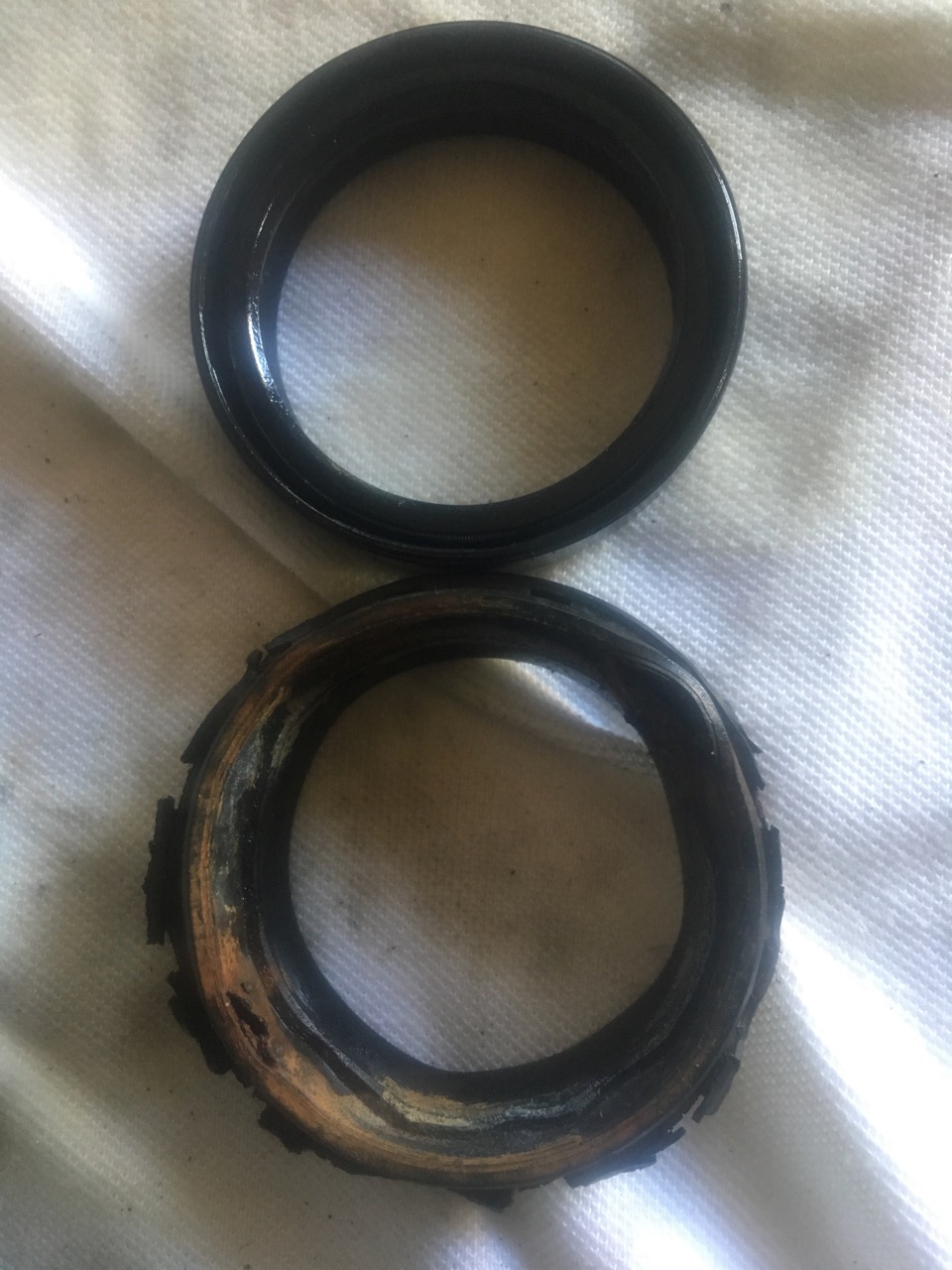

  10. Then strip them all down and replace the seals and bushes. The oil seals weren't leaking but the dust seals had corroded. At least the wire in the dust seal had corroded which, as it expanded, caused the rubber to split, so the forks had to come apart to replace those so I may as well replace the oil seals and bushes at the same time. Oh, and change the 20 year old oil :blush:

  12. And torque them back up without the top clamp pinch bolts tight.
