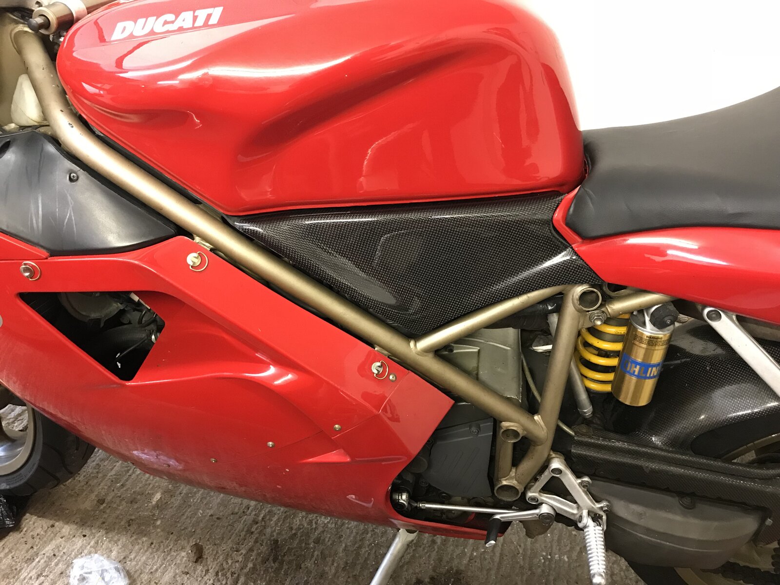

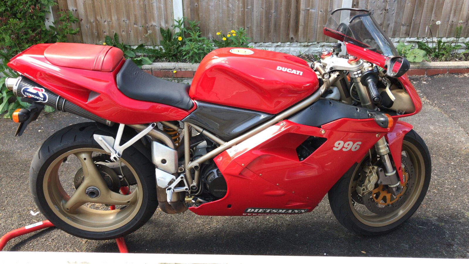

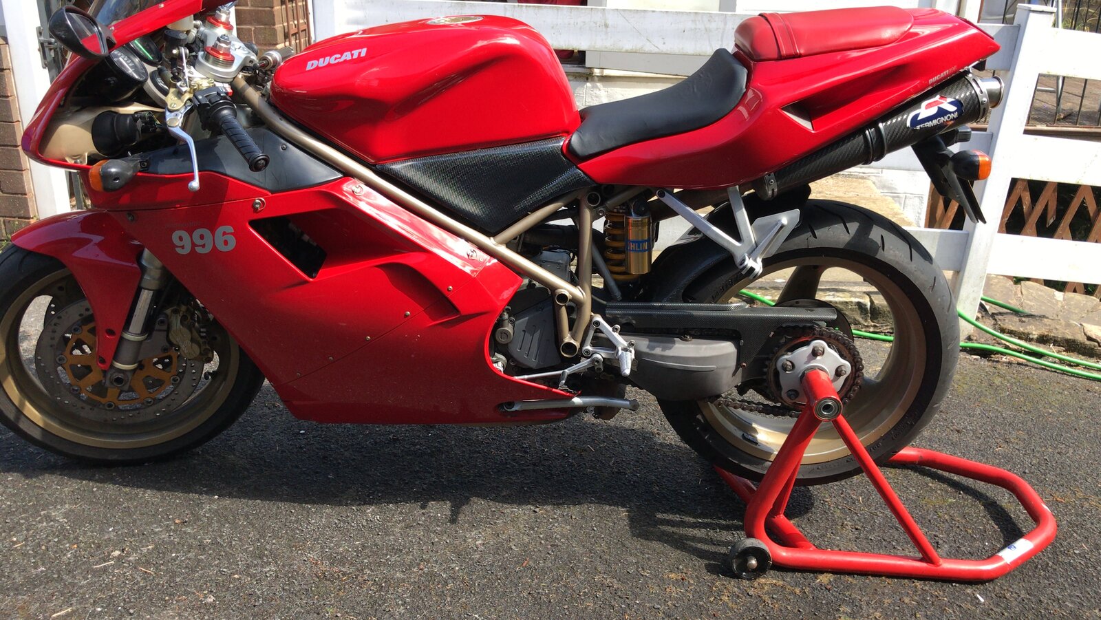

  10. FD6A47C0-9FC1-4F91-9675-F4F1DEA4FE8B.jpeg 92636242-57ED-4B39-8A39-7334F9A147A1.jpeg 09AEDCA3-7B96-4EE9-BE72-7ACE99C11595.jpeg I’ve some of them carbon airbox covers mine are carbon panels which just stick over the existing airbox looks ok I put mine on as some one had painted the airbox black so without repainting it I couldn’t get the black paint off and it wasn’t a good finish
  11. Glen, on yours the panel fit is correct and the lines follow through so it works. The line, curve and detail of the 748/9x6/998 is one of its key aesthetics, if its not retained with aftermarket bits they look out of place.

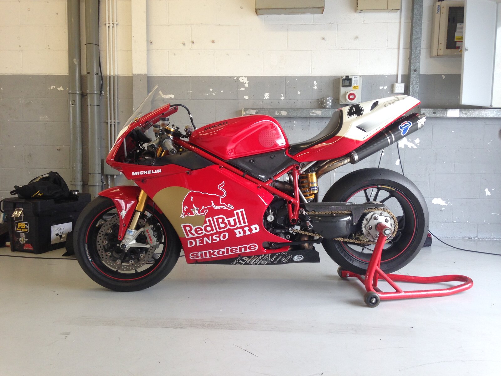

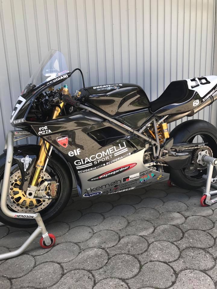

  12. I had them on my old bitsa. I cut the oem sides off, leaving just enough to add the fasteners.
    Remember the original 'race' CF air boxes where in three parts.
  13. My c.f. race airbox is in 4 parts
    Main body
    Two sides
    Front nose section
    :bucktooth:

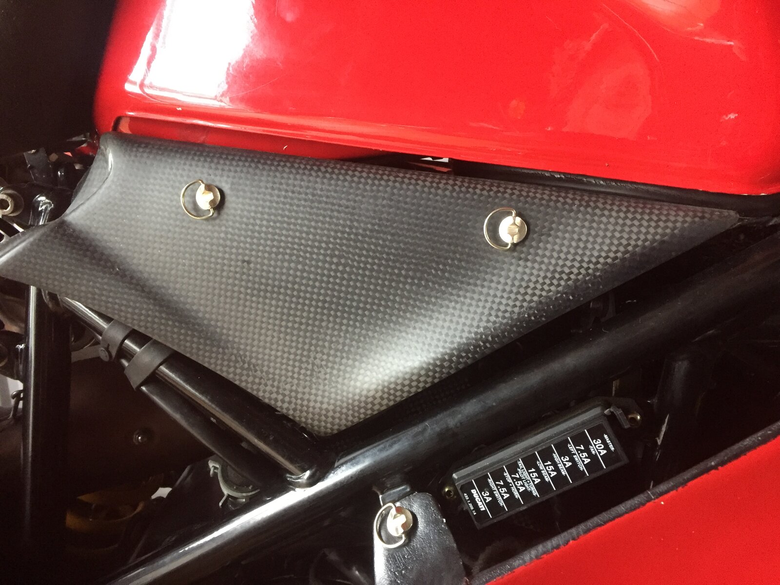

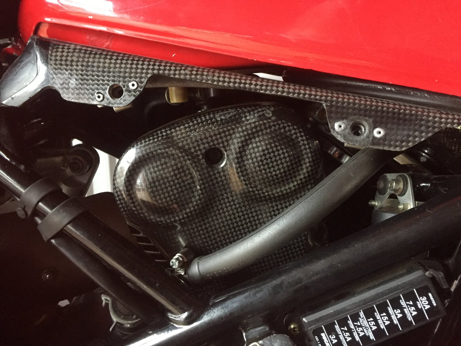

  14. My aibox sides. The aibox originally was all in one so obtained a pair of sides and with a pair of fuzz fasteners and a bit of cutting job done. As said above ease of access especially when I can change the rear belt without having to remove air box and ancillary stuff.
