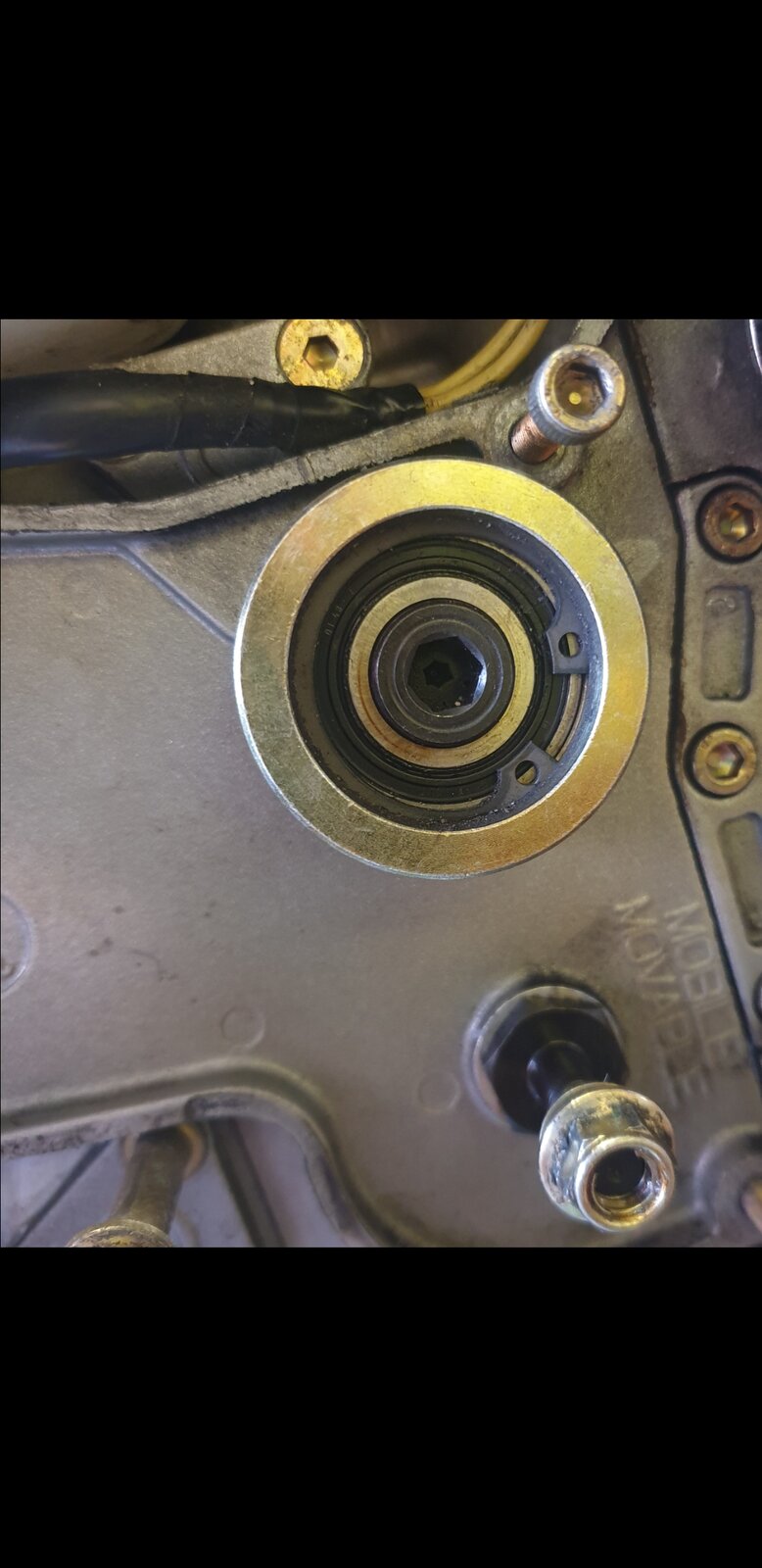

    Was hoping to change the idler/adjuster bearings whilst on with the belts change.
    Both adjusters have come off easy enough but I've hit a bump in the road.
    Both idlers have two circlips visible. I have removed the smaller, inner clip hoping the roller would slide off the shaft with the hex head. It's not budging. Is this how it's meant to come off or is the removal of the hex bolt . Haven't tried anything serious atm.
  2. Not clear but have you removed the pulley from the head?
  3. No.
    Engine in frame doing belt change. Nothing else. I bought the bearings anyway.

  8. Just double-checking here
    I haven't yet touched the hex bolt in the centre of the pulley and I wasn't going to.I was thinking the pulley (inc bearing) slides off the the hex bolt when you remove the inner circlip -the smaller one.
    Is that correct or not ????

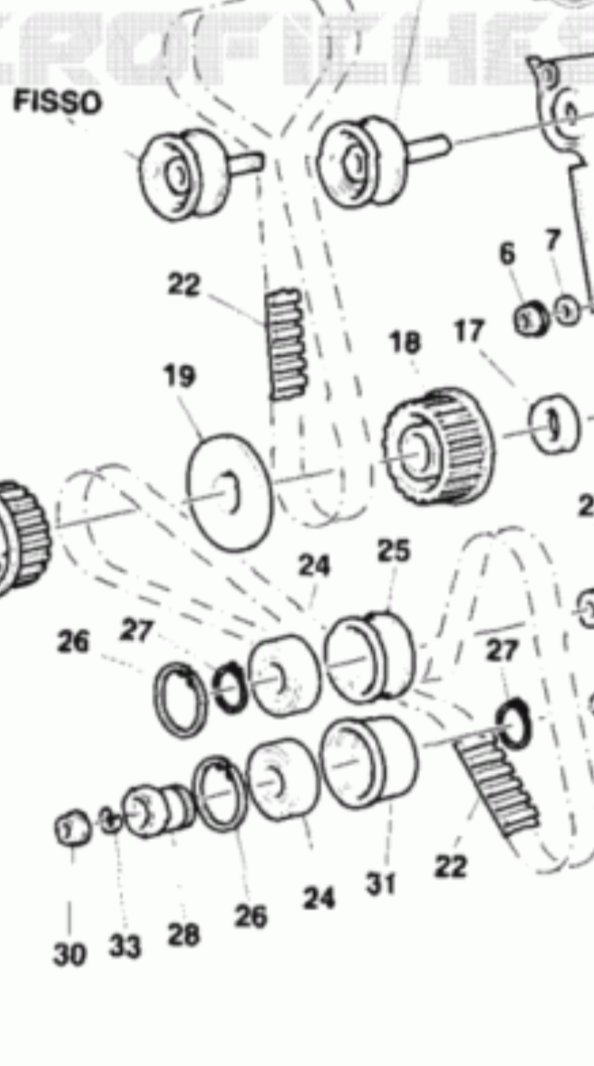

  10. This may help a bit from parts-ducati.com
  11. You need to take the idler off! You cannot change the bearing when it's on the head. The circlip holds the bearing in place, the other side has a shoulder. Take the idler off, remove the circlip and press out the bearing from the opposite side of the circlip.
