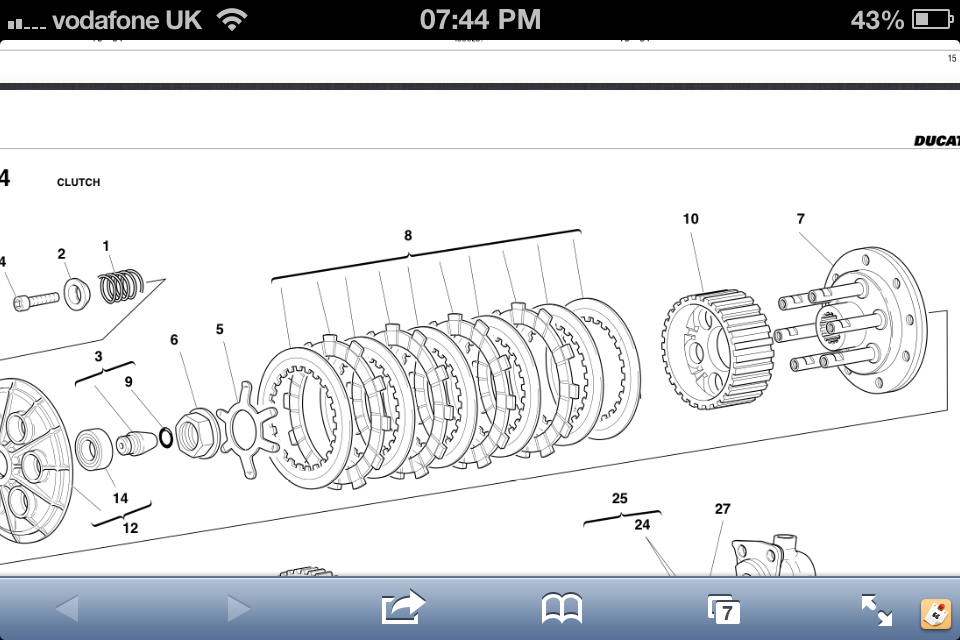

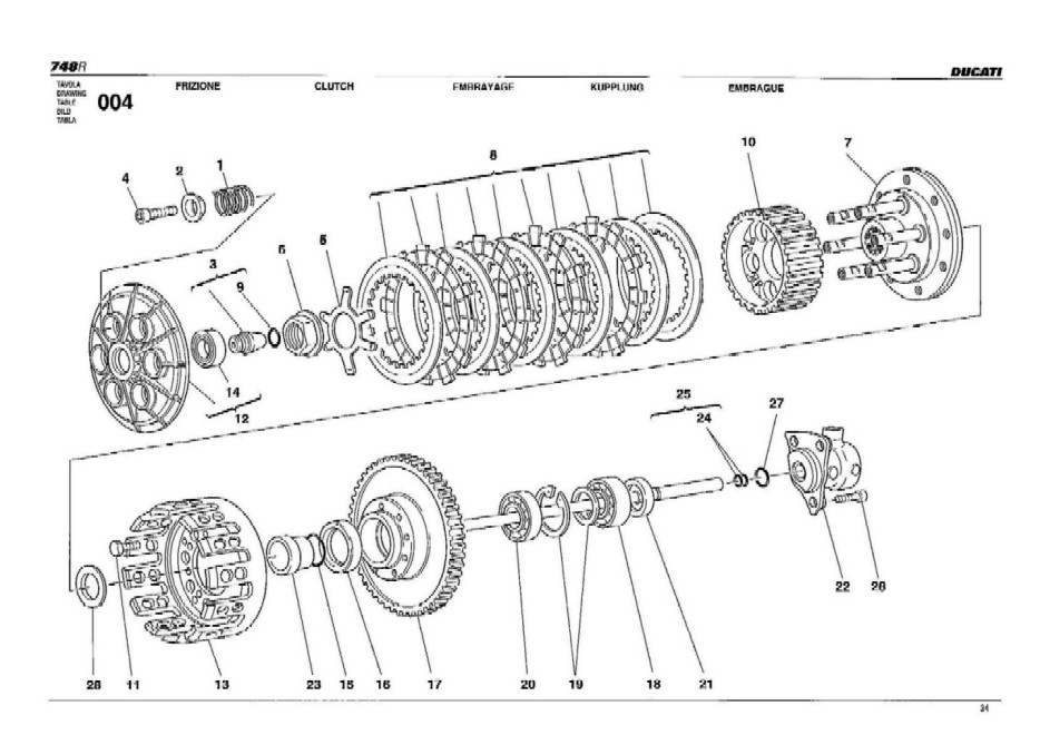

  7. HELP- Just trying to fit the ducati clutch kit in my 748r
    Anyone kno correct order??
    There's 7 fibres & 8 steel
    Exploded diagram shows 2 steels in 1st then alternate fibre/steel and finish with a steel? But with 8 & 7 this doesn't work out??

  13. Ok a slipper does set up the stack differently to a std non slipper. As you may be able to see and worth a check whilst you have it apart the centre hub will rise and fall against a centre spring......this does this on ramps that need cleaning and lubing with the appropriate high temp grease.
    you can also check that the spring is in good working order
    once this is done then you can rebuild the the plate stack.
    start with a friction as if you start with a steel then the first time the slipper slips the first steel will drop behind the centre hub.
    so fibre steel fibre steel etc until you get them all in then measure the height with a vernier from the centre hub down to the final plate this want to be 4 to 5 mm nearer 4 is better..........( there is a picture of this if you search the site to clarify.)
    this will give you the best shot of it working .....hth
  14. I've gone wit 1 steel 1st as there appears to be a steel plate screwed in with Allen bolts tha isn't shown on exploded diagram and therefore I've got a steel in 1st and 1 in last before the pressure plate?
    Will take bike for spin sat and see how she goes??
  15. ffs i dont know why i bother.
    Go for it....hey ho.
  16. No need to get shirty!
    The exploded diagram clearly shows steel 1st?

  18. Have to say it does show a steel plate first. Maybe because its not a very sophisticated clutch compared to aftermarket ones
