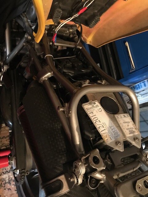

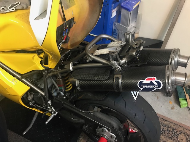

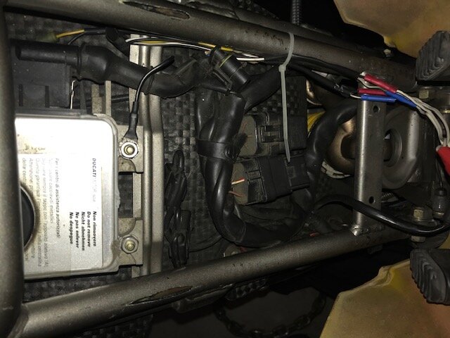

    I own a 2000 748R here in New Zealand and bringing it back to former glory - for the previous owner it was 'just another bike' & used to commute to work amongst other things..
    It has a Biposto rear subframe currently fitted (by previous owner, as he wanted to take his wife for rides as passenger!) and I have sourced an original Monoposto alloy subframe but unsure if will fit so hoping you will help before I purchase (as not cheap).
    Bike has been verified by Ducati in Italy as a genuine 'R' via engine/frame number, and has all other factory correct parts so no dramas in that regard.

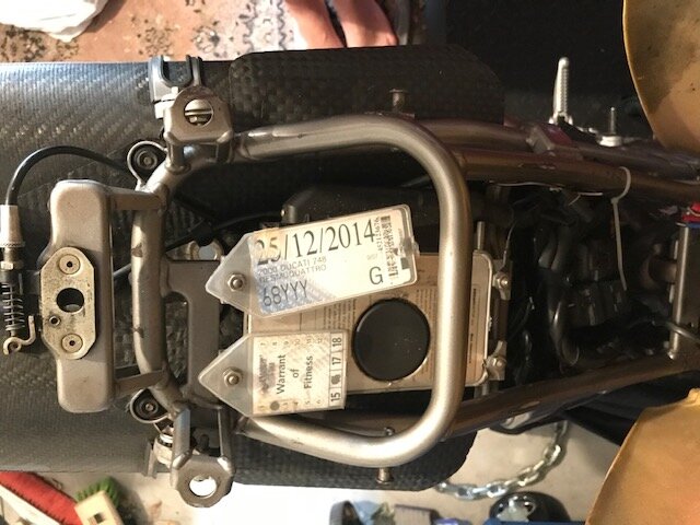

    Aware that possibly the 'R' ECU's are mounted sitting across the frame via the 4 x bolt fixing points & are not mounted front-rear as set up currently?
    Hopefully the wiring loom is still as per original so will be long enough to return to position (you guys may tell in photo).
    Thanks for all your help in advance,
    Nick
    Current rear subframe & ECU set up:

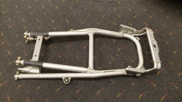

    Monoposto subframe for sale:
  2. Welcome Dave. Why don’t you introduce yourself properly in the newbies section too please :)
  3. Looks like the original wire loom mate as it's bent round in the bp sub frame. Looks like you shouldn't have a problem there.
  4. Looks good to me too. I'd seal up the ECU bung when you get a sec too. Don't need the original sticker but they do look nice. I'd be inclined to check that the ECU Eprom hasn't been changed or fiddled with and also just check that the engine has all the original R bits (cams, heads, injectors etc.)
    Why wouldn't the PO keep the original subframe for refitting later?

  6. Is that an SPS subframe for a P8 ecu?
  7. Does this help?
  8. i think Ricky is on to something..
    SPS
  9. other type...
    might need a photo from someone with a 2000 748R
  10. This is the P8 style subframe, the one with the 4 holes should be correct for the ECU as shown in the first post.
    I've got this type (P8 style) of subframe on my 916 and I had to get creative to fit the ECU.

  12. Thanks guys, a good help.
    From what I can tell the frame offered is correct for the year & ECU style.
    Will suit the ECU no problem (ie not P8) due to the mounting points & loom length due to it being routed around as suggested.

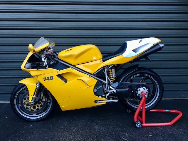

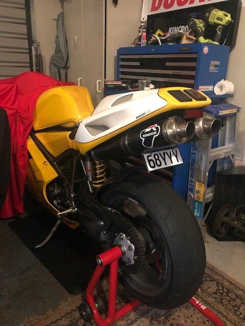

    Full pics of the bike as requested
    (tank is sitting up as have had it off due to fuel connector leak. Also re-fitting the original rear light, indicators & number plate holder onto bike too - previous owners work to fit LED set up & number plate under mufflers etc etc)

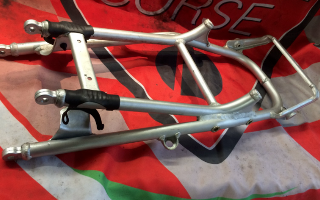

  14. That’s an RS/Corse subframe as made by Pierobon (as are all the others, aluminum alloy), it doesn’t have the lock fitment. I have one of those on my 998.
