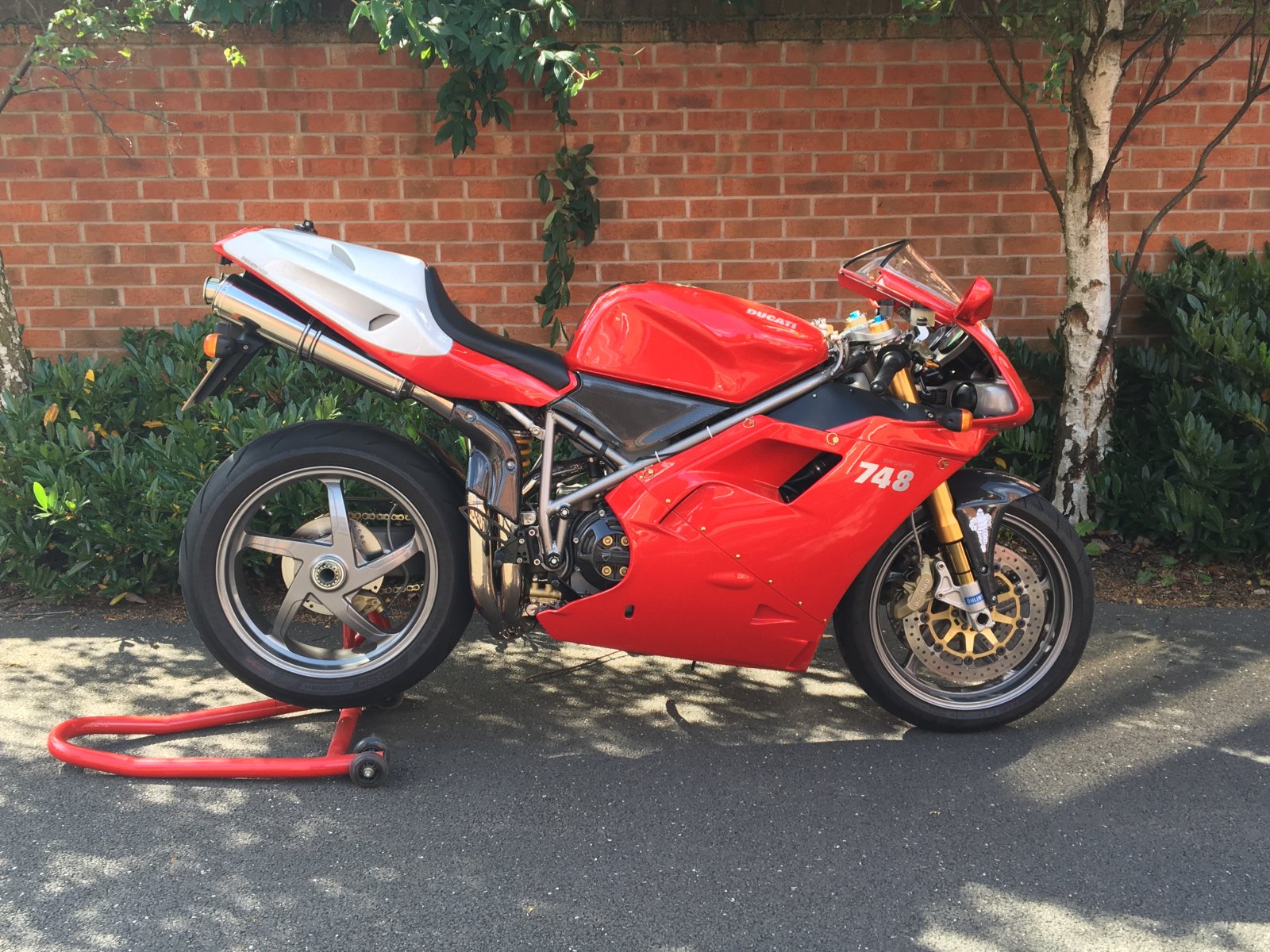

  10. Great post @Android853sp Not sure about the yellow bit though ;) IMG_9742.JPG
  11. 748r's should all be yellow.
