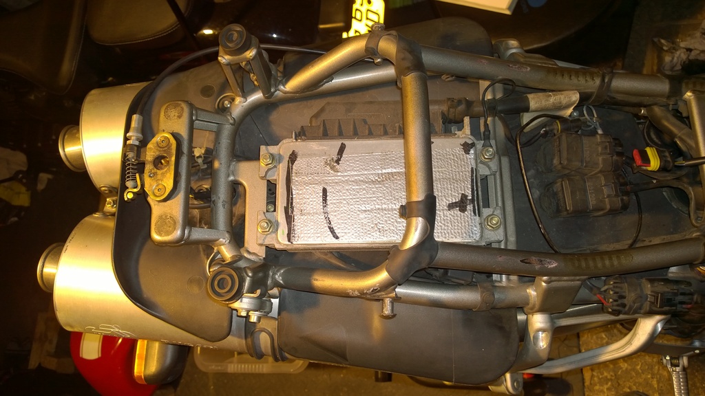

    Last but not least the ECU, which doesn't really look like it's stock to me, althought I've only seen this one

  3. Looks like a stock P8 with gaffer tape over it. If the performance is noticeably better than a standard 748s, you could be looking at an 853 conversion. Not sure that sp, sps or R cams on their own qualify to make it "closer to a 996". Andy

  6. It's a stock 1.6m ECU but you could peel the tape off, remove the bung and check what Eprom is fitted, may give a clue to what has been done to the motor.
