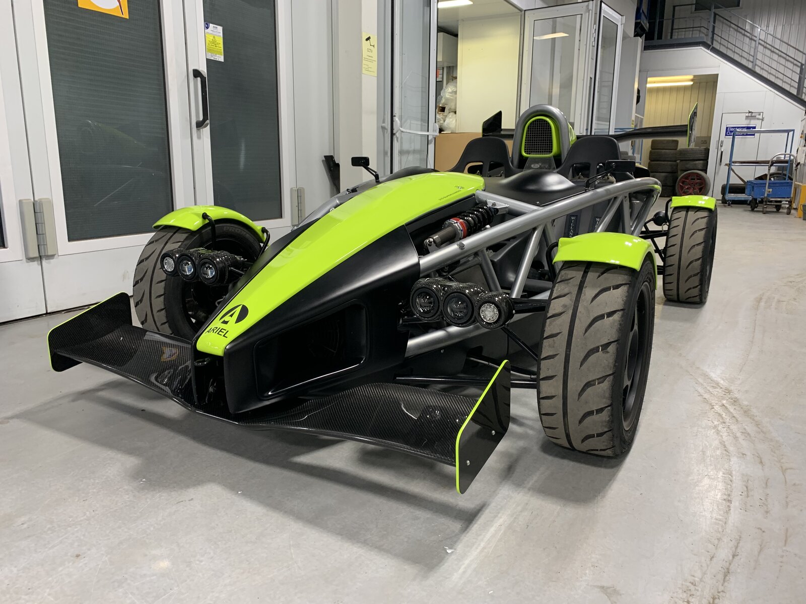

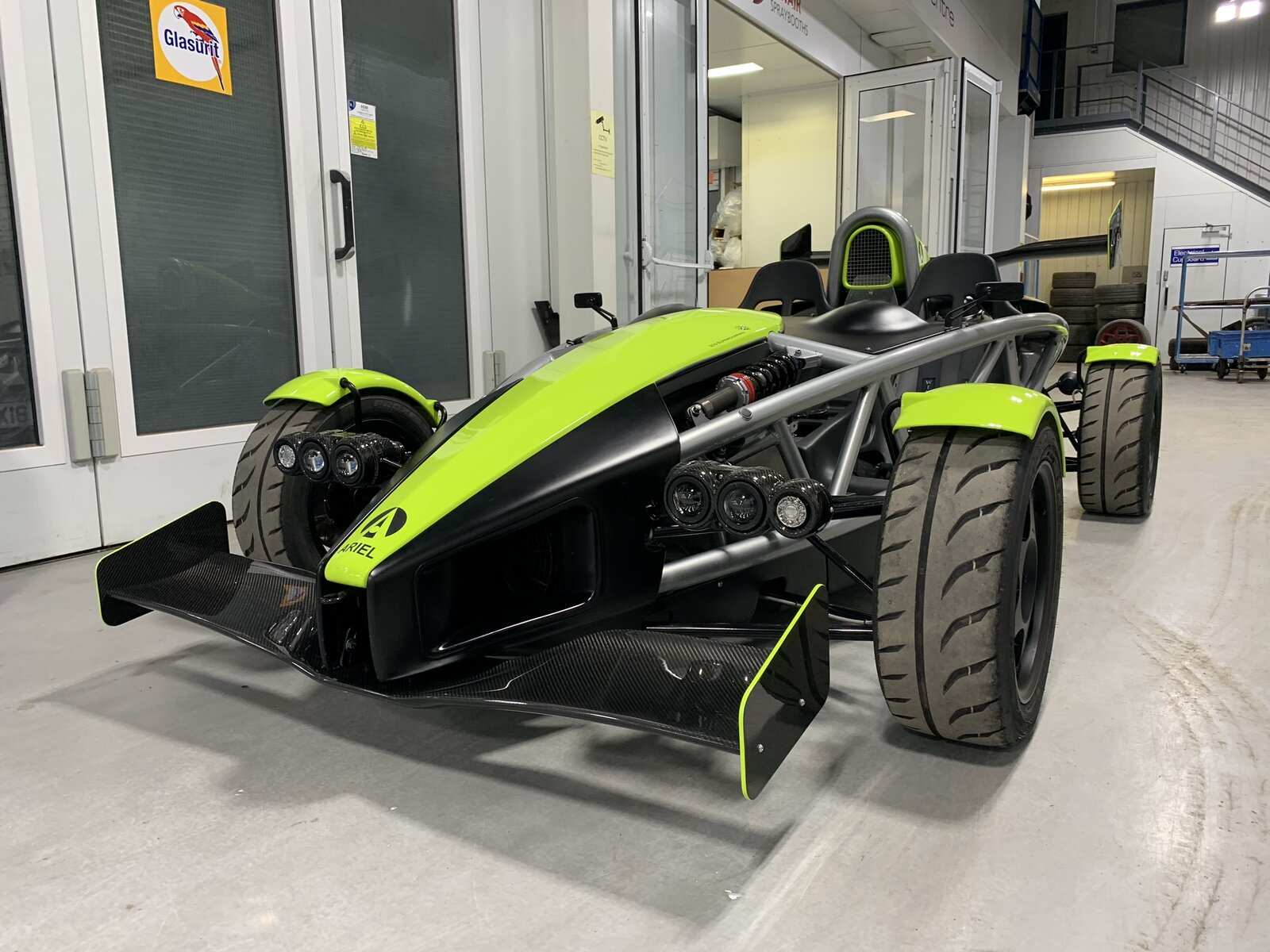

  6. I work in a prestige bodyshop & seen it done a good few times, wether its as good as matte laquer from the off i dont know BUT my boss has an Aerial Atom, and all the gloss black parts, he just had them scotched down & matte laquered, Looked very good indeed.

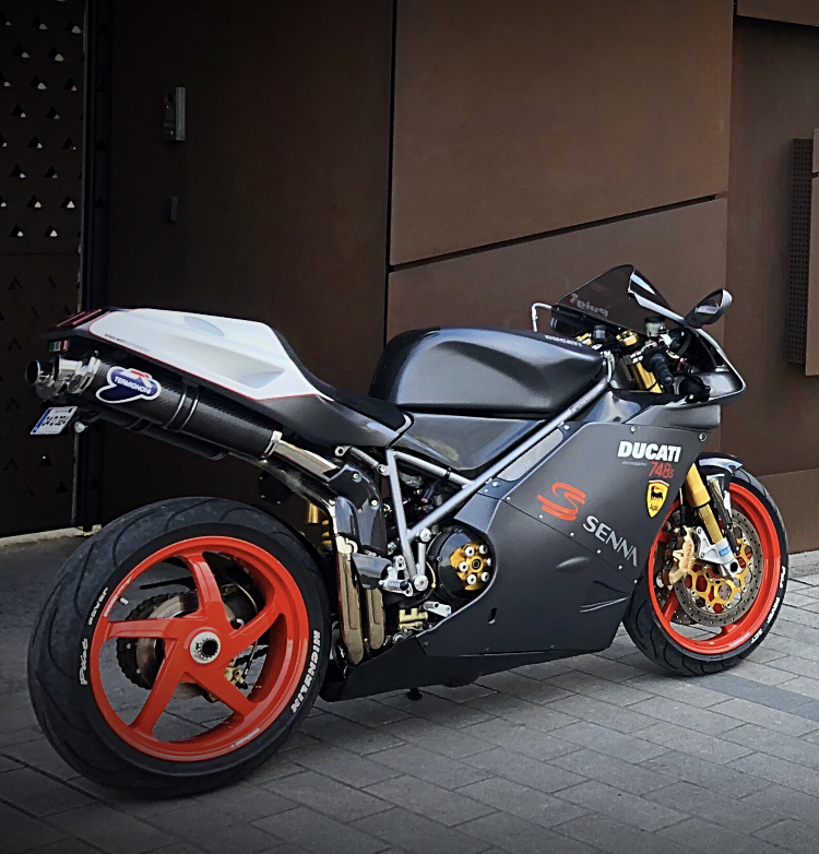

  18. Rub it down with a Scottish pad and use Matt lacquer it should be ok even do the bottom side panel and see how it turns out. Are the decals lacquered over . Any pictures of the bike. This is my one I’ve owned from new , 2004 .
