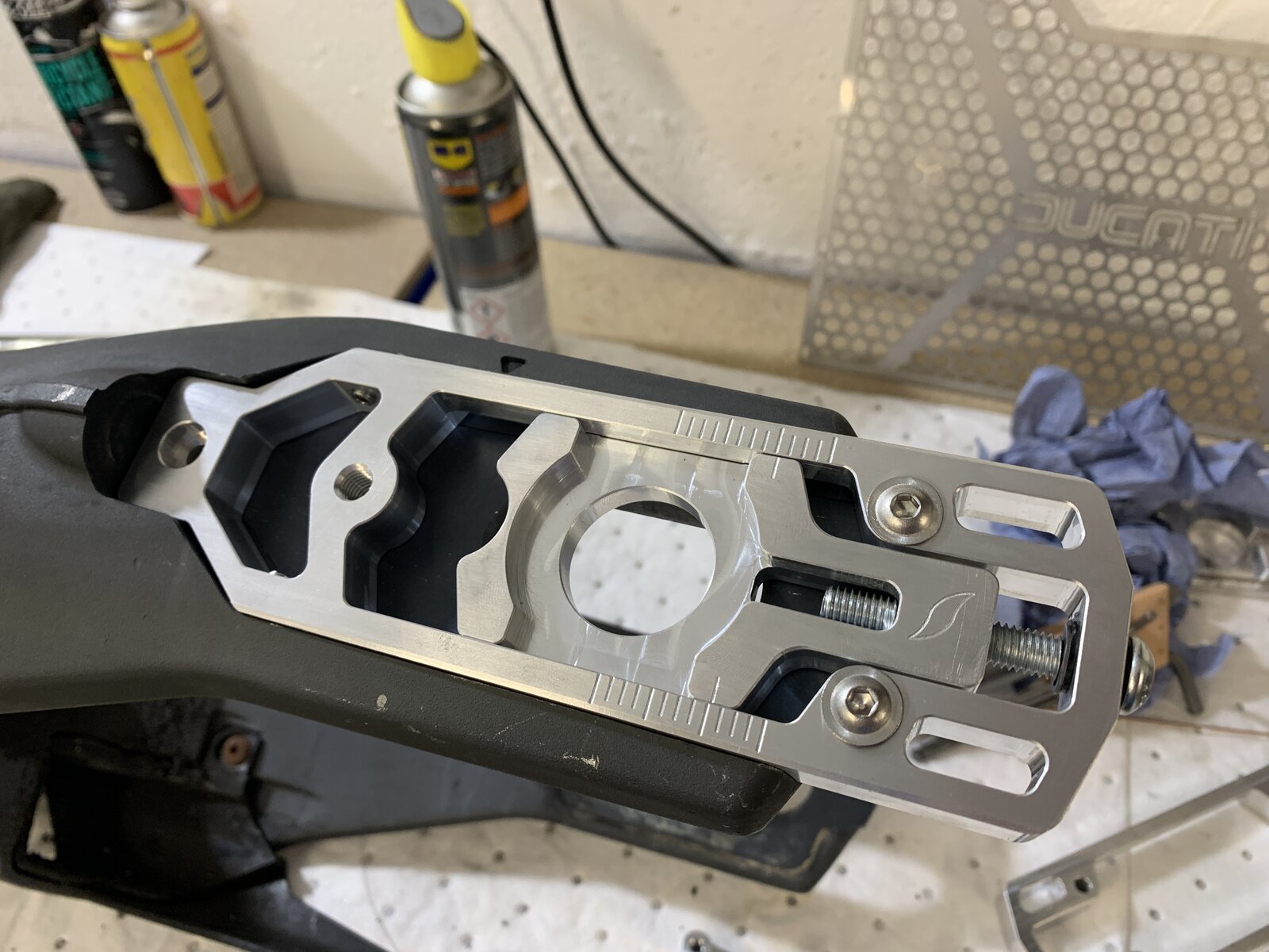

    After a really impressive uptake on the fabricated swing arm chain adjusters, we have bought a cast swing arm in so we can design a similar style adjuster...
    I'm basically looking for initial interest... No commitment at the moment just seeing how much of a market there is. If you are then please raise your hand.

  3. What Sev said. I've got the Pit-Bull 999 rear stand for the cast swingarm. It actually works quite well and feels very secure but is a bit fiddly to align. If a set of Gilles-type adjusters could be fitted without any drilling, would accommodate GP-style lifters, and would stay in place with the axle removed, I'd more than likely be in.
  4. You will have to drill one hole near the front to hold in place. We can do a clamp to go round the back. Any ideas on how to secure them, I’d gladly listen
  5. The stock hole at the front of the recess for the threaded adjuster seems like an option rather than a bolt parallel with the axle through the swingarm.
  6. Just looked at my bike closer (bike was new to me this winter) and realized the adjuster doesn’t thread into the swingarm itself. It’s just sitting in a well on the swingarm. So that’s not an option!

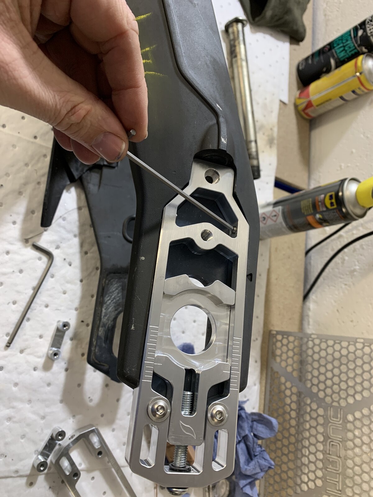

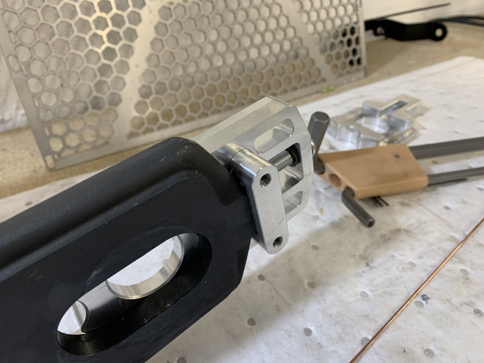

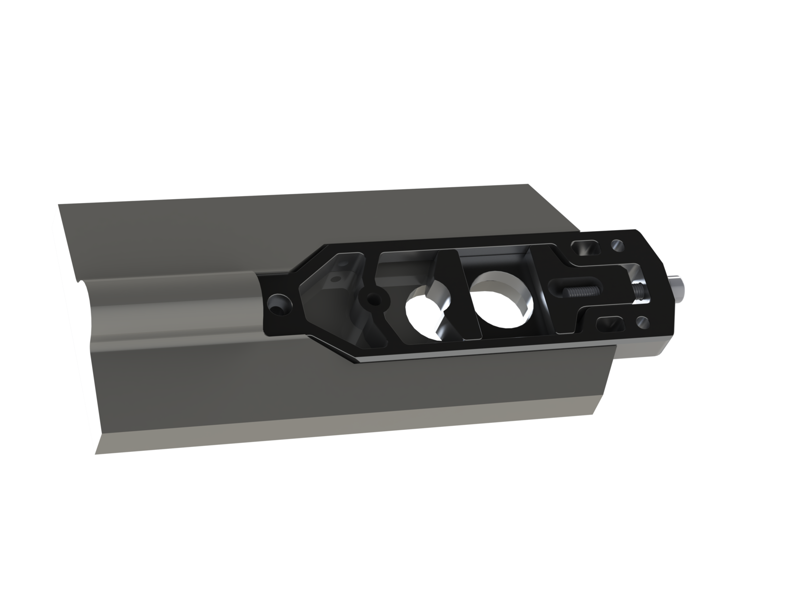

  7. The initial concept... you can drill the frame and screw down or there are grub screws acting up and down to pin the part in the swingarm. We will also make a wrap-around bracket to hold the rear end in place too. There is also a threaded hole for the lifter bobbins
    comments welcome

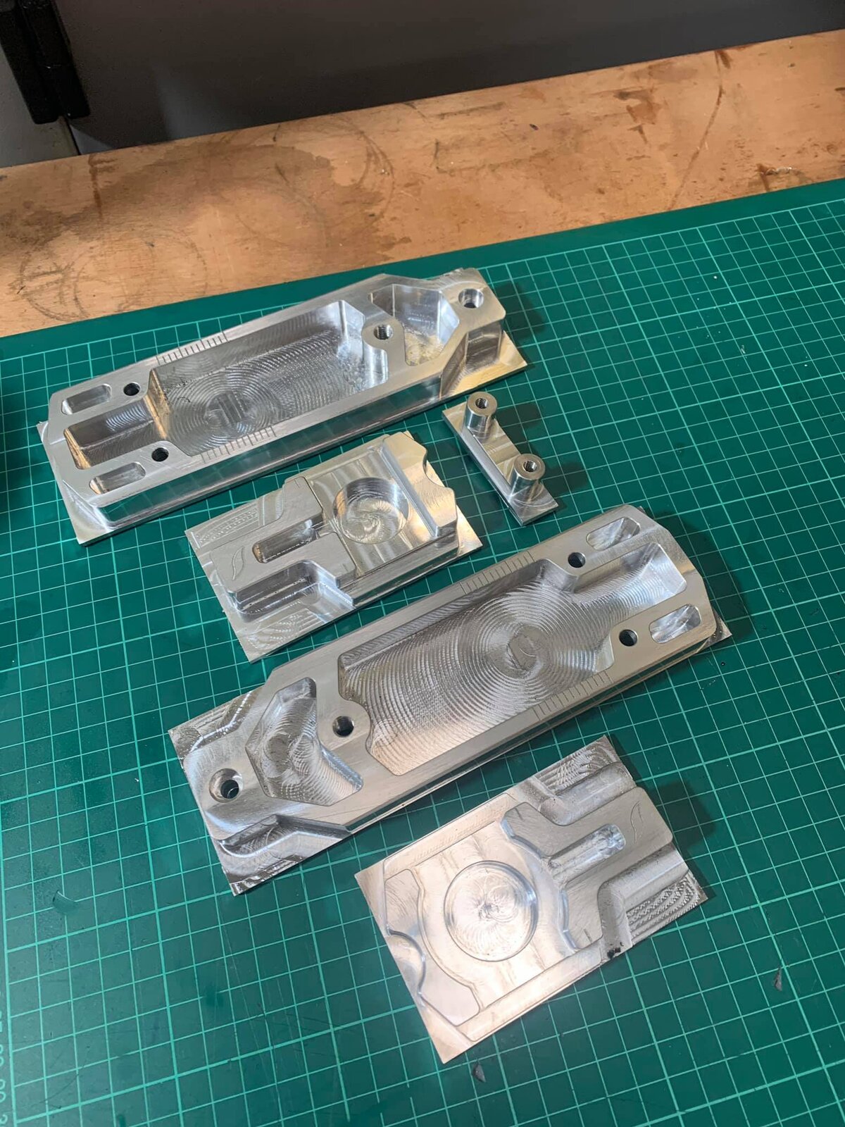

  8. outers off the machine today should have a working set to show off later today
  9. nice

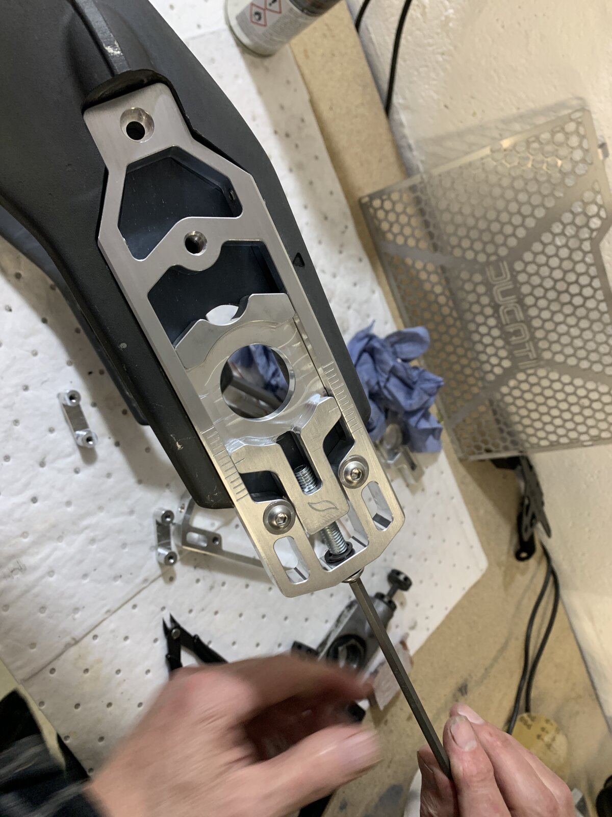

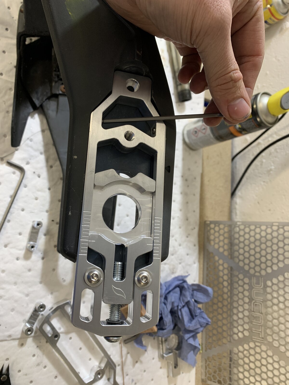

  10. so here you go. the finished design... at the front, you have two opposing grub screws to pin the adjuster in place. you also have the option to drill and tap the swing arm to secure the adjuster with the counterbored bolt hole we have included.
    The empty threaded hole is for an m8 thread to attach a cotton reel style lifter bobbin and you also have the option of bolting lifter plates through the rear two holes where the rear clamp plate is located.
    The price will be £199.99 for what you see here as a pair either anodised in Black or Natural finish.
    Will ship worldwide for an additional cost.
    https://iconicparts.uk/shop/ols/products/ducati-749-slash-999-chain-adjusters
