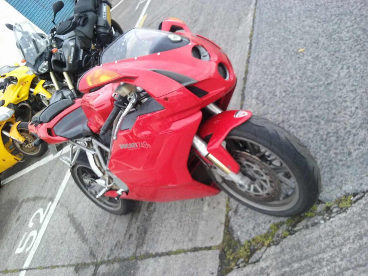

    Here's a barn find 749s I just picked up couple of days ago, looks ok but dog rough...

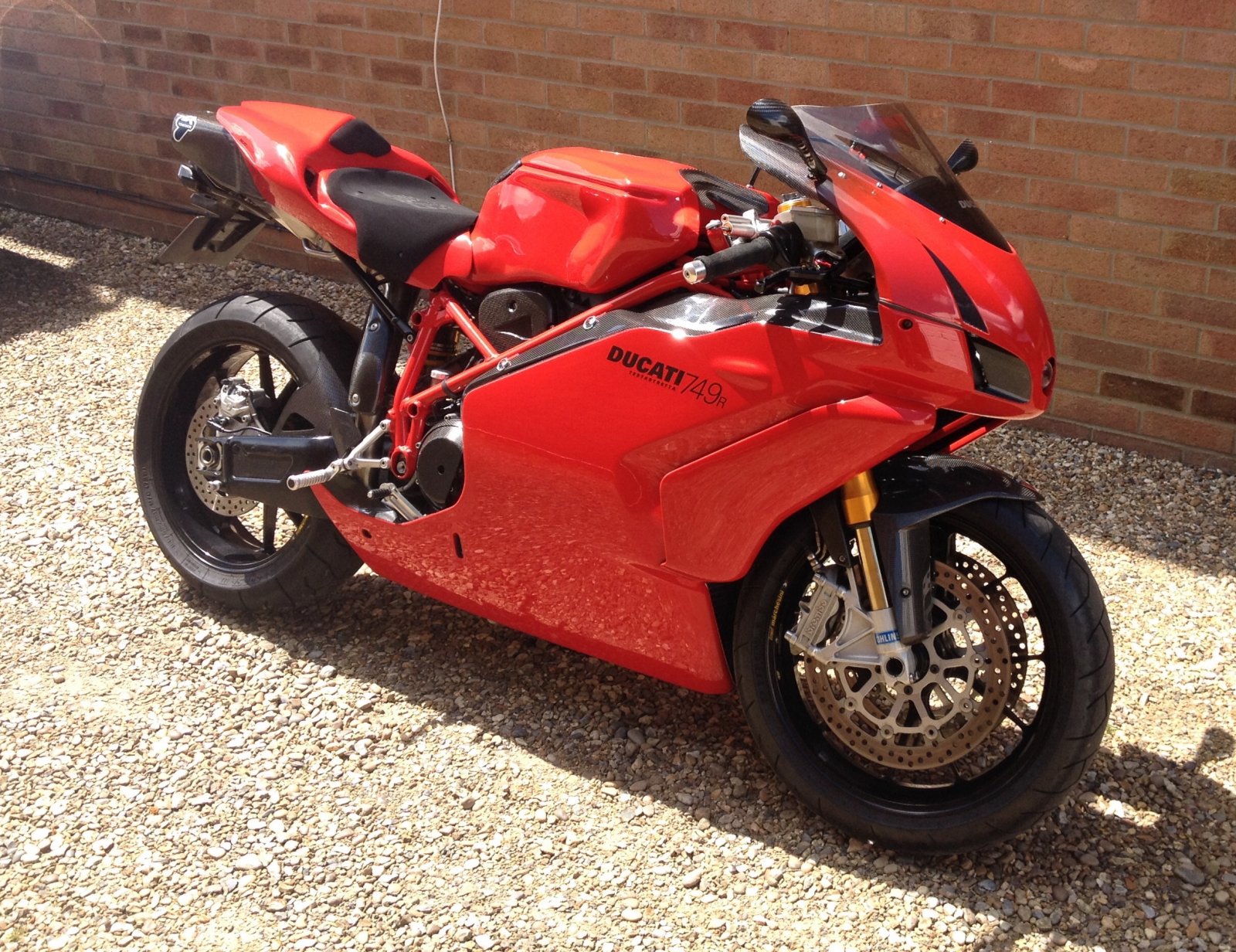

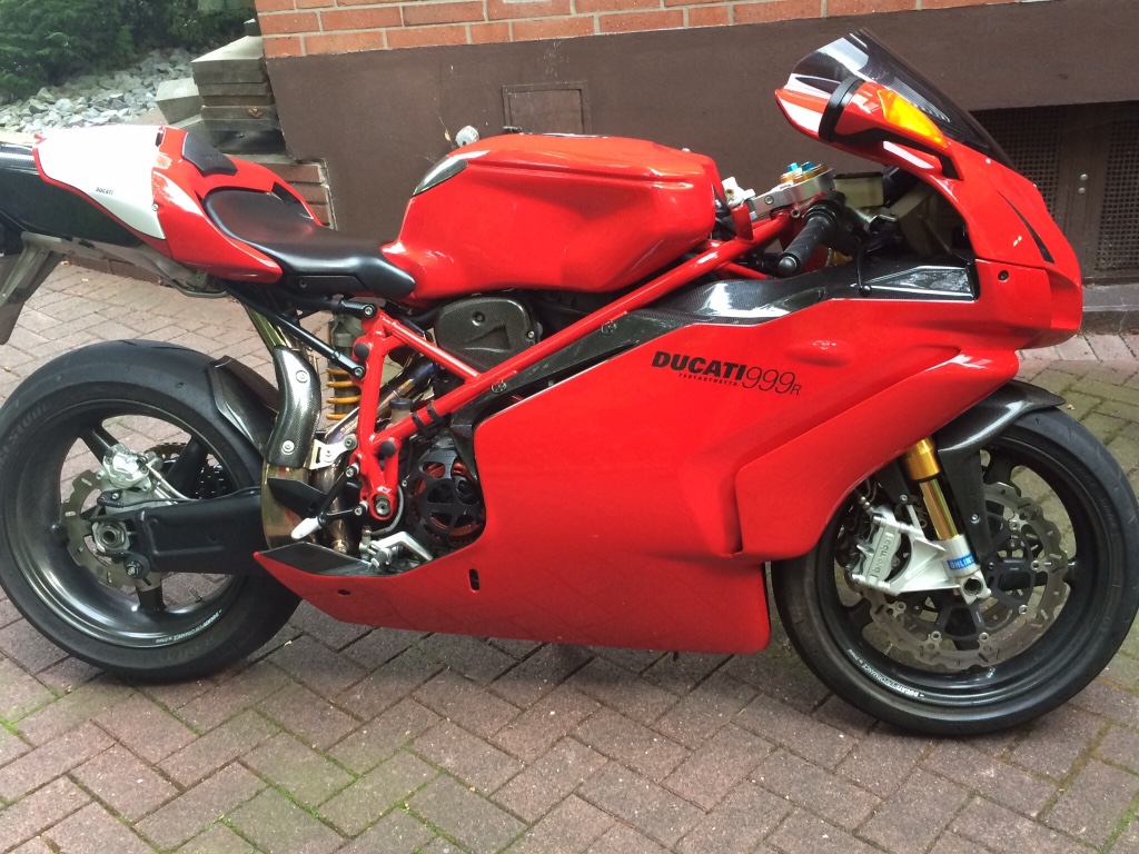

  8. [​IMG]
    -Brembo M4 Monobloc calipers with titanium bolts
    -Fren Tubo Carbotech brake lines from 1098
    -999F06 Brembo narrowband full floating rotors 320x6mm with 5mm spacers and titanium bolts
    -ABM Synto levers
    -Oberon reservoir covers
    -Gilles Tooling chain adjusters with titanium bolts
    -titanium front and rear axle nuts
    -Supersprox 520 conversion with titanium sprocket nuts
    -DP billet steering damper bracket with titanium bolts
    -DP forged Marchesini wheels, repainted and with new decals and tires
    -RCM Racing 999RS replica rearsets with titanium bolts
    -aluminium swingarm bobbins with titanium bolts
    -original blue Öhlins decals removed all around, replaced with black decals
    -full 57mm Termignoni system with titanium mounting bolts, slightly polished
    -Pipercross filters
    -oversized carbon air runners by MS Production
    -DP ECU
    -Shorai lithium battery
    -TSS slipper clutch with titanium pressure plate bolts
    -EVR 48t basket
    -Oberon clutch slave, new version pushrod with titanium pin
    -Samco hoses
    -DP magnesium valve cover (on vertical cylinder only for now)
    -Ducati Corse 999RS04 sandcast, vented and numbered clutch casing with titanium bolts
    -999R 2003 full carbon tail with carbon seat pad cover
    -DP magnesium headlight housing
    -DP magnesium mirror brackets
    -DP carbon silencer cover, vented with black mesh and new decals
    -DP carbon air runner covers
    -DP carbon front fender with titanium bolts
    -DP short carbon hugger with titanium bolts
    -DP carbon mirror covers
    -DP carbon/billet tank cap
    -DP carbon V piece with titanium bolts
    -DP vented carbon belt covers with titanium bolts
    -DP carbon tail tidy with titanium bolts
    -DP carbon clutch cover with titanium bolts
    -DP titanium front sprocket cover with titanium bolts
    -DP windshield without parking light, with titanium bolts
    -DP billet preload adjusters
    -MS Production carbon tail light heat protector
    -carbon swingarm protectors
    -carbon ignition switch protector with titanium nuts
    -carbon tank front & rear protectors
    -carbon seat side pieces
    -carbon rear brake m/c cover with titanium bolts
    -more titanium bolts around the bike, about 180 in total
    -Motion Pro coolant recovery tank
    -horn moved from belt cover to under the headlight
    -front fairing vent meshes painted black

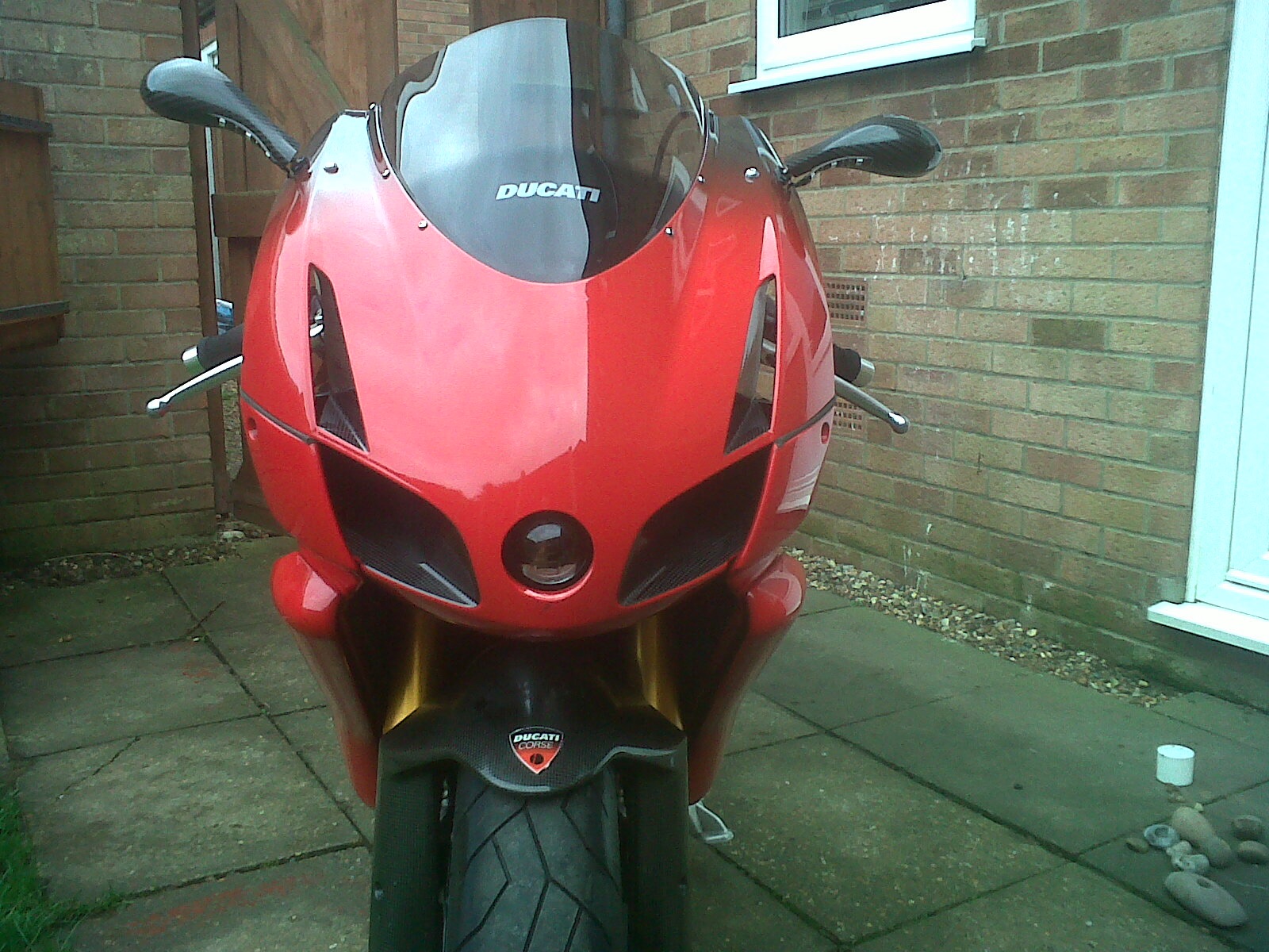

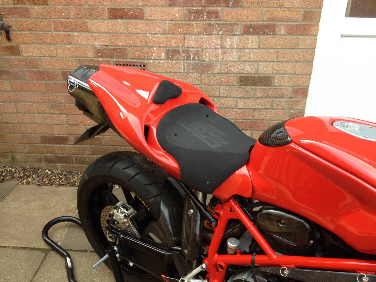

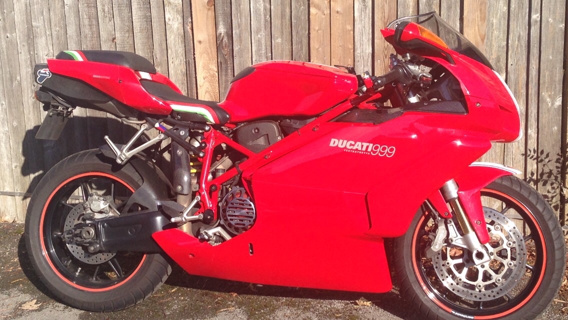

  10. My 05 base 999 bip came with asymetric termi, DP hugger and pretty clutch, and was an absolute bargain in Oct 07 just as 1098 came out with 4200 miles on it. My best mod is cyclecat clipons that are about 20mm higher, and really improve comfort on long rides and also help with room for tankbag. I do have to keep my hands to the outside of the grips on full lock to clear the fairing but I do that by instinct now.
    Over the 8 years Ive owned the bike Ive repaced most of the plastic with carbon inc DP vented belt covers, heel guards and fairing infills.
    I got an ohlins damper cheap so thats nice to see from the riding position along with the carbon fairing supports. Gilles rear wheel adjusters make life easy. Carbon q.r fuel cap to replace the ford cortina std item and DP screen minus nipple. Chinese fold up levers that are changing colour from black to bronze. Grippy seat covers with italian flag, black frame plug kit, tail tidy/small plate. I replaced all fairing and screen screws with black. I got a damaged nose cone and had the top headlight filled in and respayed with a corse stripe on mudguard, nose tank and seat panels to give it a bit of a sporty look. Last year I got DP filters and ecu flash to suit. I want to get the footrests anodised black then I think its finished. Over the years Ive spent about a grand on bling, every bit from ebay. image.jpg
    #10 900streetfighter, Aug 12, 2015

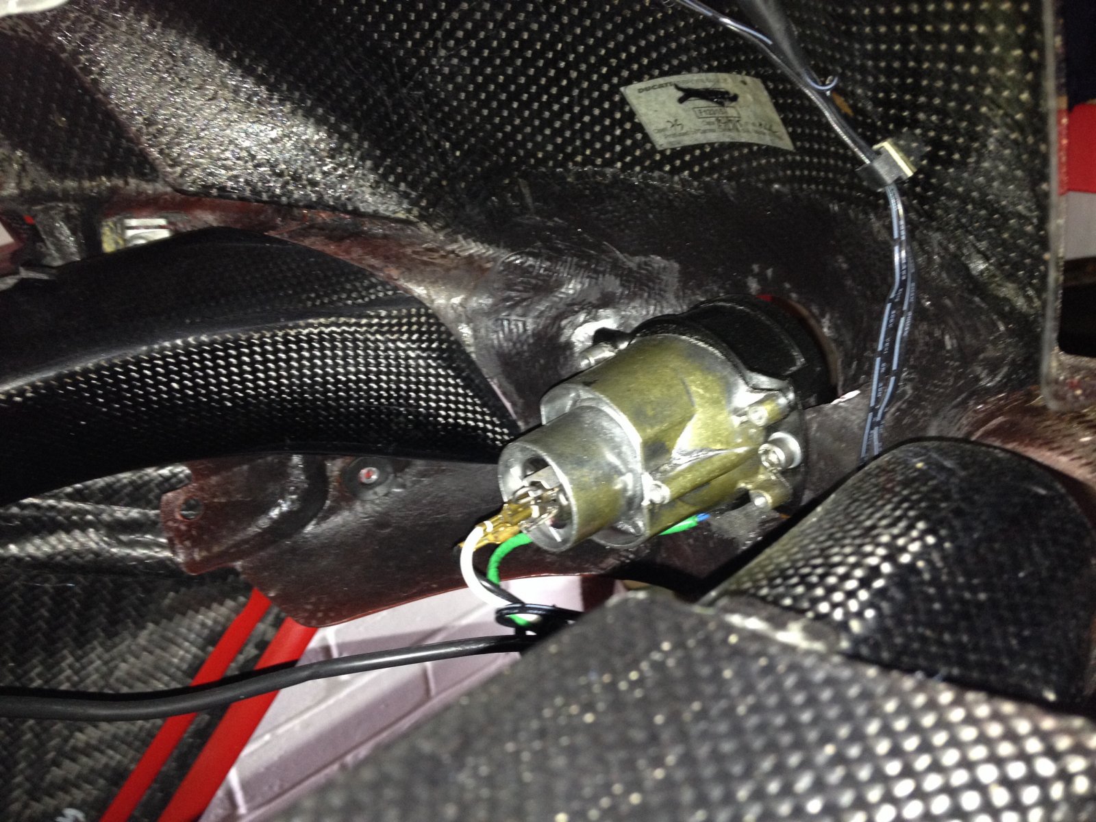

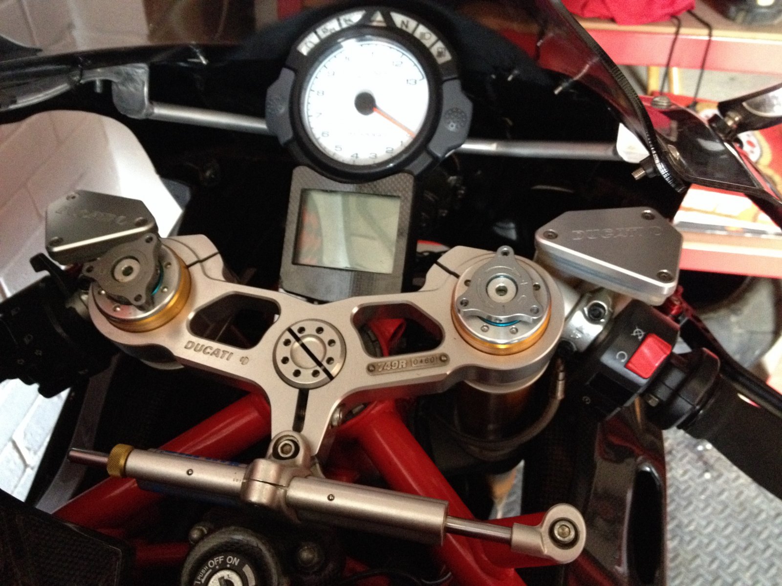

  11. I have been continually dropping weight of the bike, the loss of the headlight bucket and headlight themselves replaced by SES brace and mini projector light. A new seat unit made a difference at the rear. Still have the battery tray and airbox mod to do. I have the usual corse items like runners and such, and titanium bolts/filler cap/windscreen/engine protection but some things you have to do yourself!
    #11 Chris.King1, Aug 13, 2015
  12. @Chris.King1 do you have any photos of how you connected that projector to the frame please?

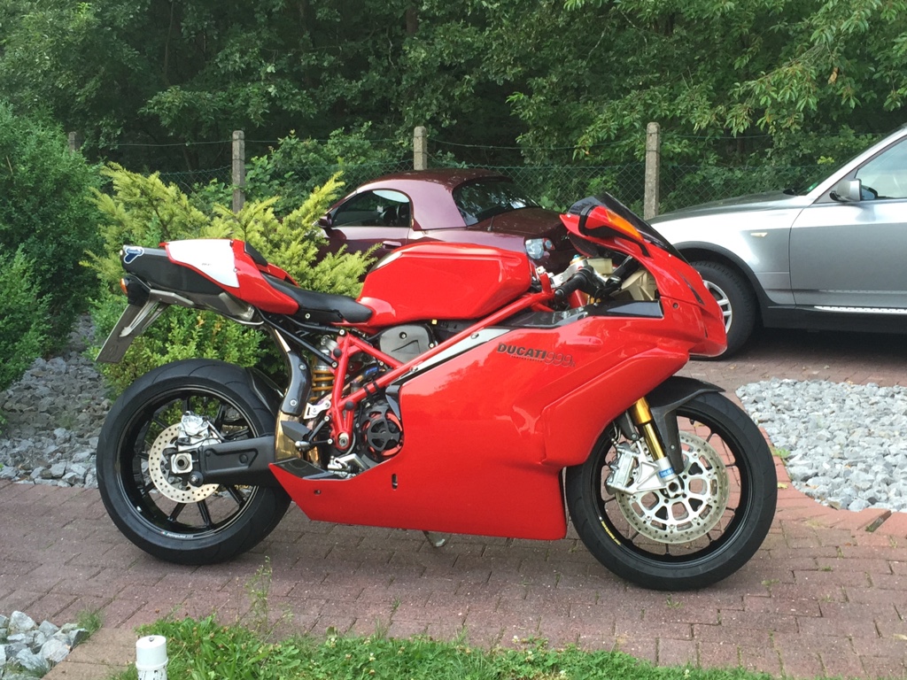

  15. [​IMG][​IMG]
    Mods so far-
    749r tank with Dp tank filler
    Dp quickshifter ( looking to change soon)
    57 system
    Stm Evo clutch
    Ecu reflash -147 bhp and runs a lot smoother
    Dymag carbon wheels and braking discs
    Set of carbon air tubes waiting to be fitted
    Renthal sprockets 15/39

  17. thanks Air Duck, I did a search but didn't find his username djcalix91
