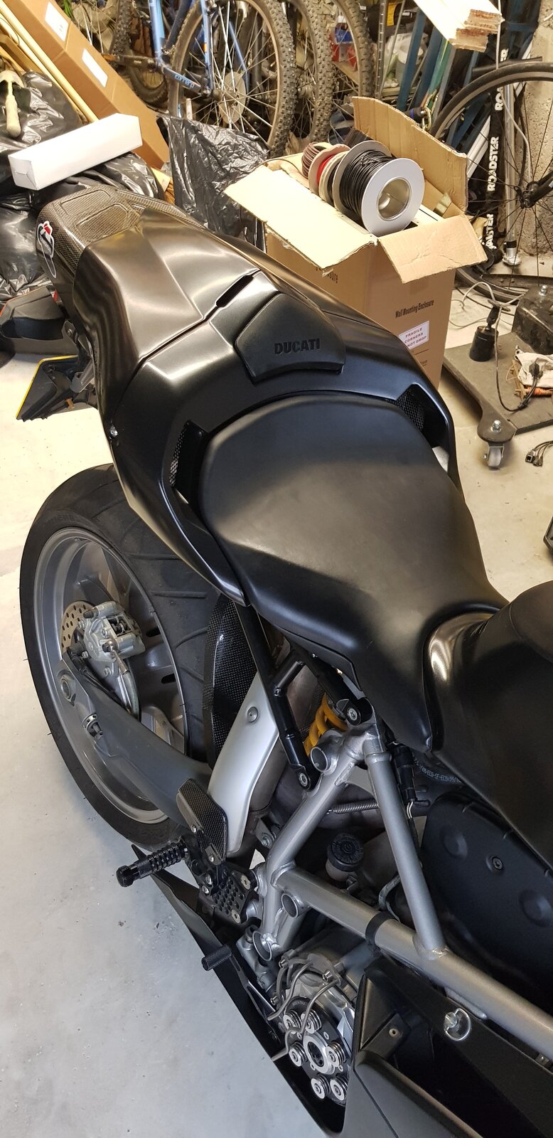

  12. Dark was only a bi. I've just converted mine to mono.

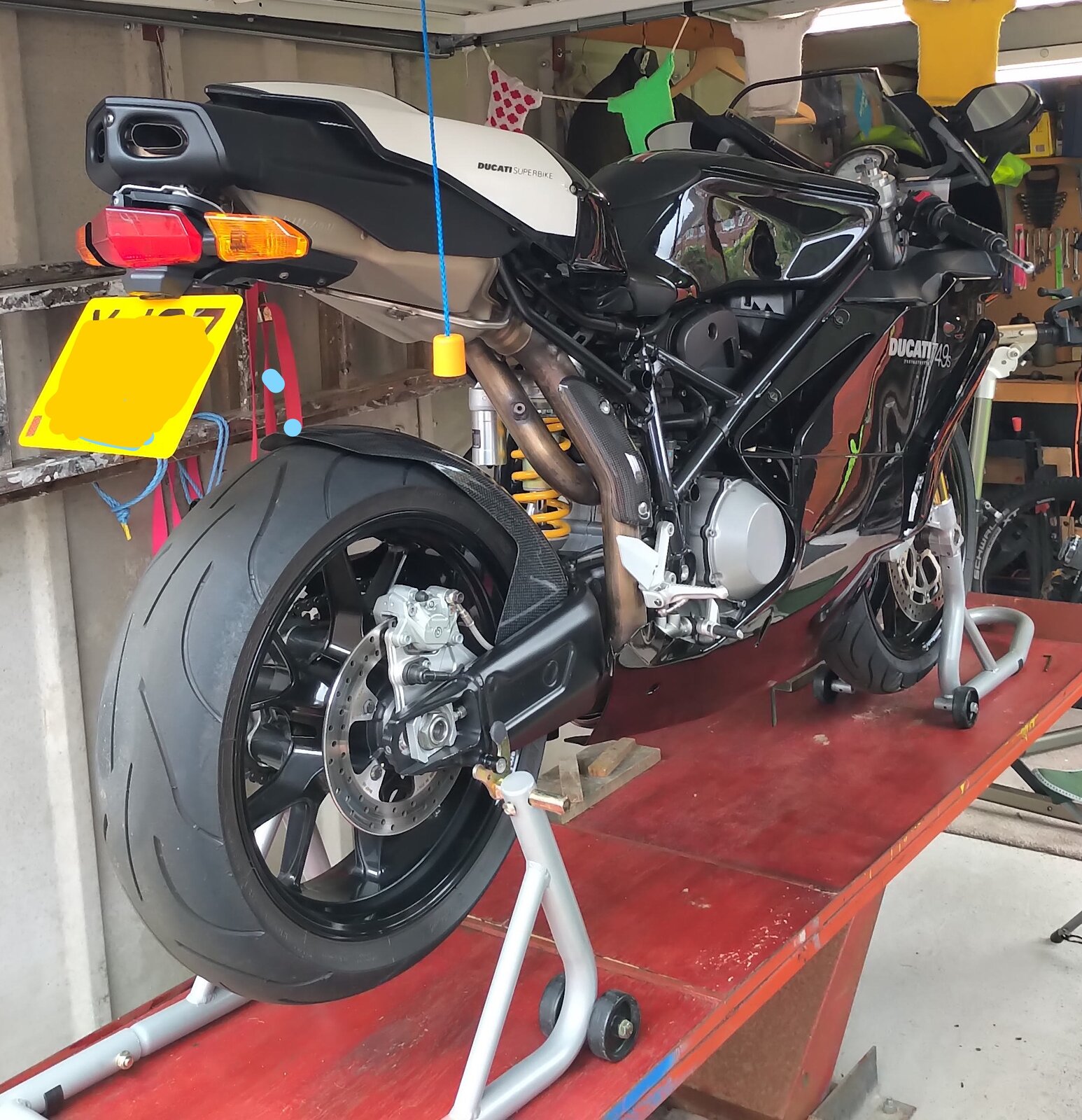

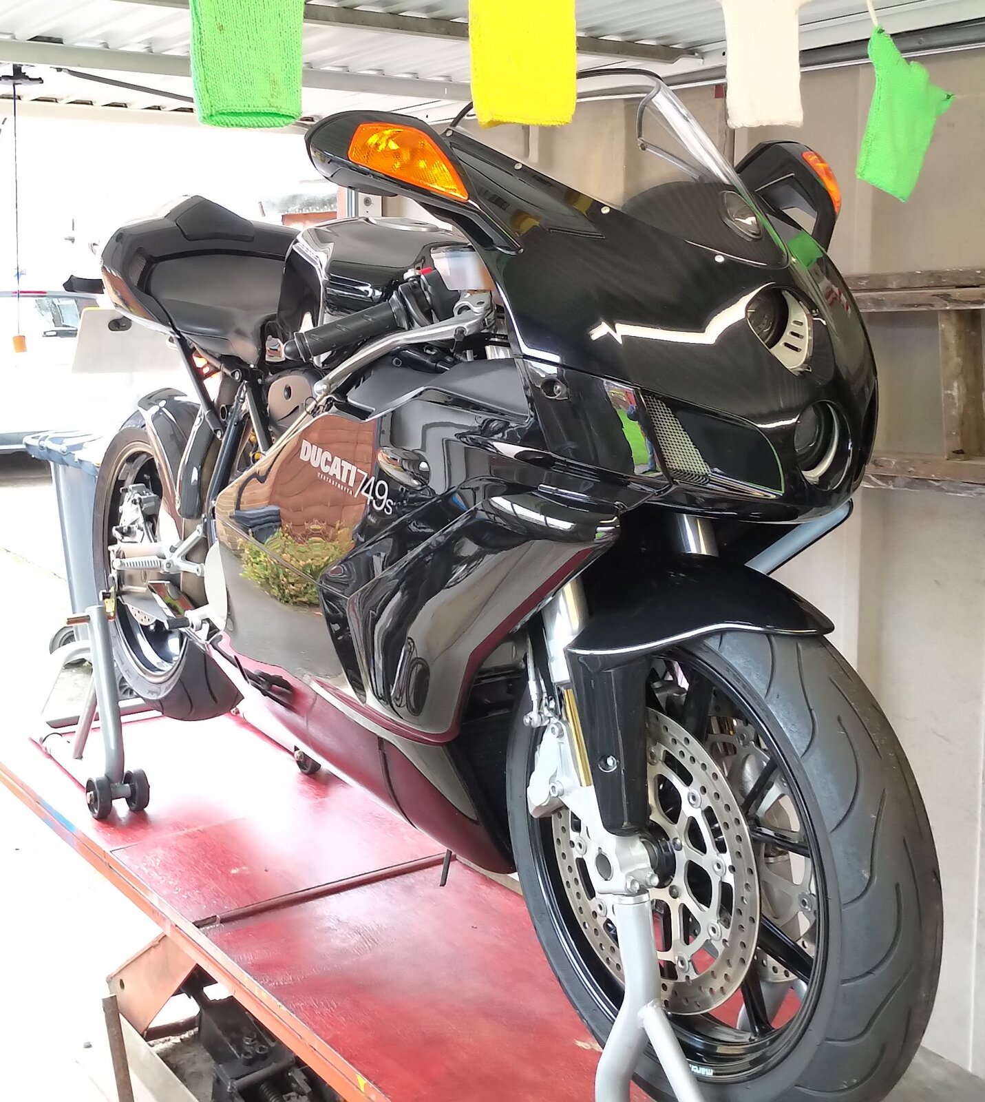

  14. Dont forget the 749s mono in glossy black
  15. @Exige will be along shortly to confirm
  16. Not seen any of those
  17. Wow, you know your stuff
    The ecu I was looking at doesn't match those numbers, goes with out saying they are silly money.
    The bikes not running badly at all so I'll play it by ear. Thanks for your help
  18. here you go
