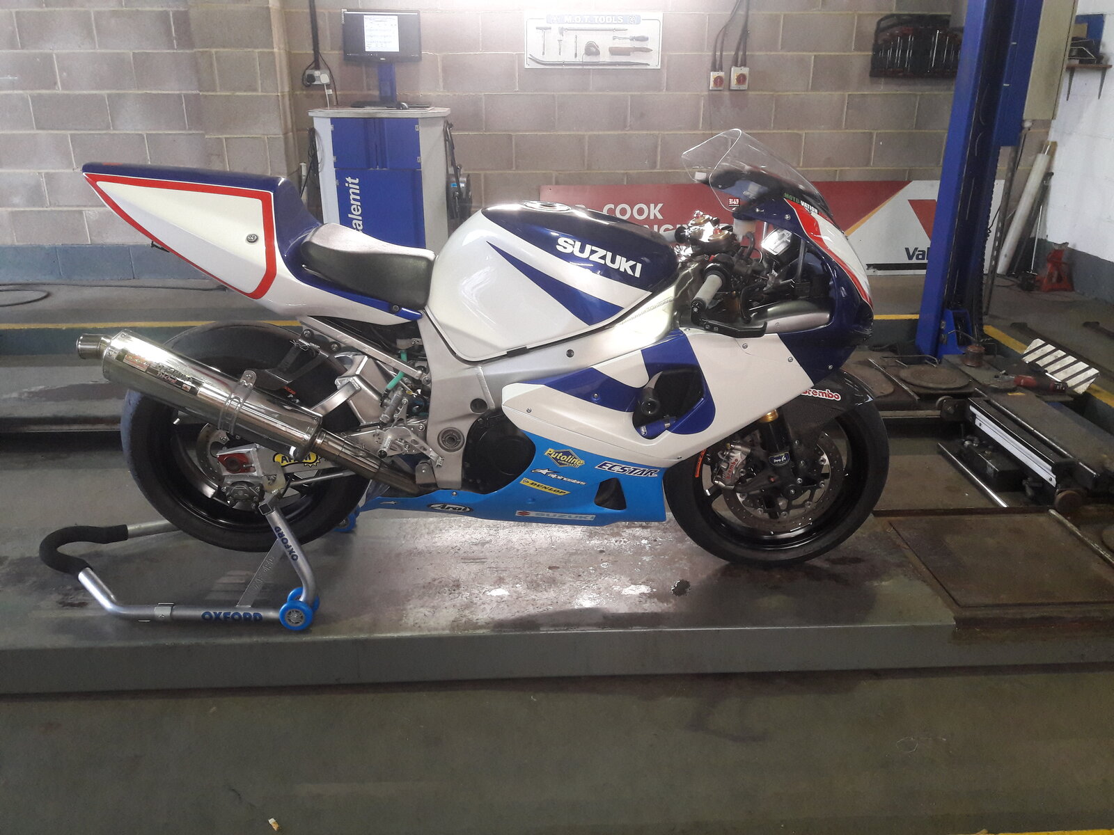

    Both are good calipers but I'd go with gp4rs calipers there's an upgraded version to the m4 , light weight and good value for money, I've got them on my gsxr track bike with zo4 pads and couldn't wish for better brakes.
