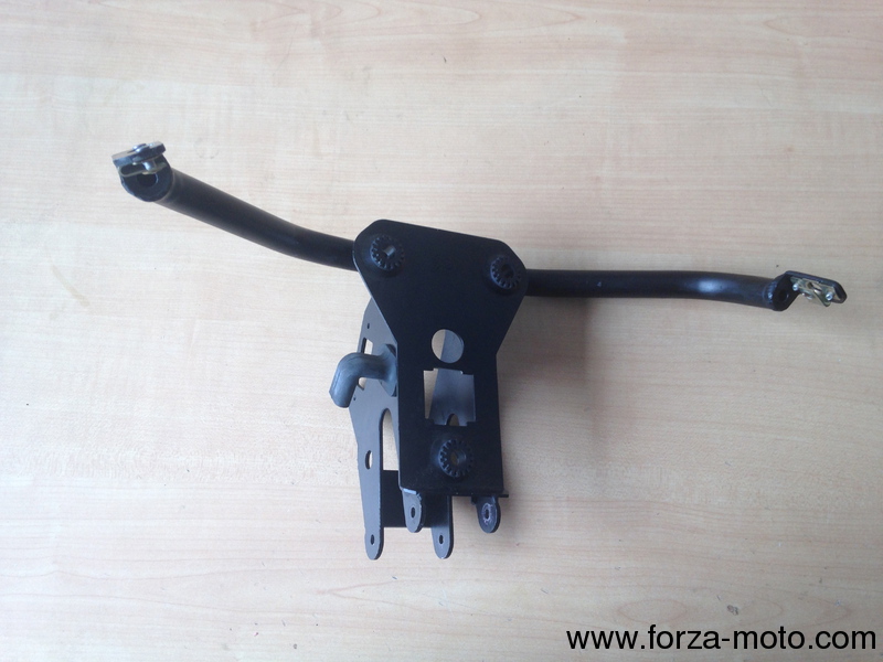

  3. Track Fairing bracket for sale here:
    https://www.ducatiforum.co.uk/threads/lots-of-749-999-parts.66064/#post-1227890
    I believe the dash is needed to run the bike . I believe also that it can run without the dash but it is fairly tricky and involved to hook up an alternative. Standard dash, in my opinion, is fine for the track. Rev counter is very big and prominent and the speedo readout can just be taped over if you don’t want to be distracted. Also, it is very light.
  4. I think that bracket will only work with a race fairing.
  5. Yeah well, he wants to make a track bike so assumed it would have fibreglass race fairings.
    My bad.

  9. I think you will need the front sub-frame I put up as it has the extra bracket for where the top/nose meets the side. If you wanted to use the other type @RickyX linked to I believe it needs to be a single unit for the upper 1/2.

  13. I have similar Fairings to that. They work fine with a race Fairing bracket which also holds the dash and fuses and air temp sensor. Mine is Pierbon.
