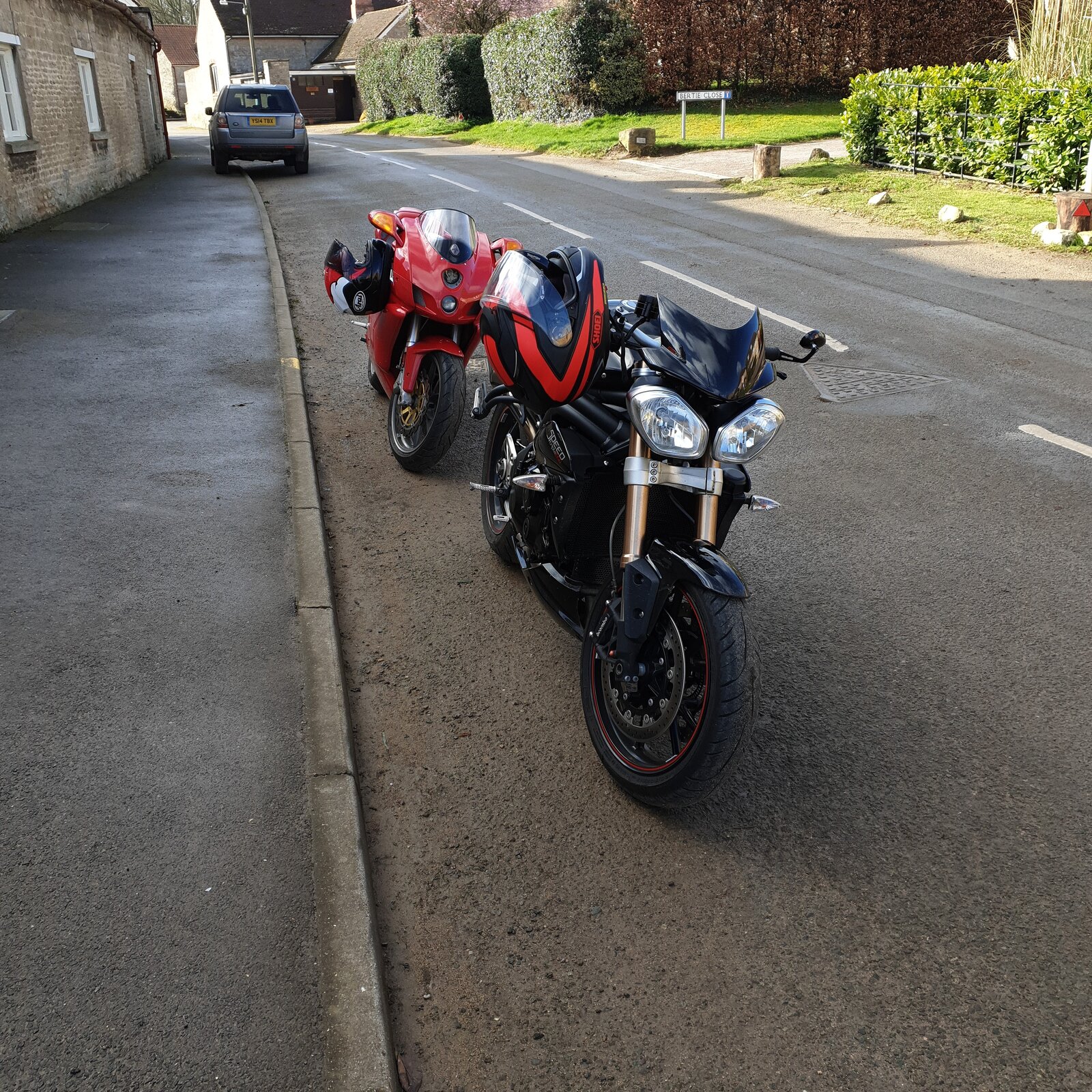

  1. Afternoon all...
    Today I should have been stripping my 749 as it keeps cutting out .... not ideal .. but the sun was out and my best mate phoned to say let's ride .... so I did the stupid thing and said Yep... went out for about 2.5 hrs .. first 2 hour great went from a place called whissendine to Melton to grimsthorpe ... to stamford ... it all went wrong on the home straight ... the old 749 started to mess about cutting out and causing me a load of trouble.... but bless her she got me home... I'm convinced its fuel related now filled up before going on the ride and towards the end when I'm getting low all the hassel starts .. so.. instead if fun I'm stripping down the tank during the evenings this coming week....
    Hope you have all had fun today with your Ducati bikes ... happy riding
