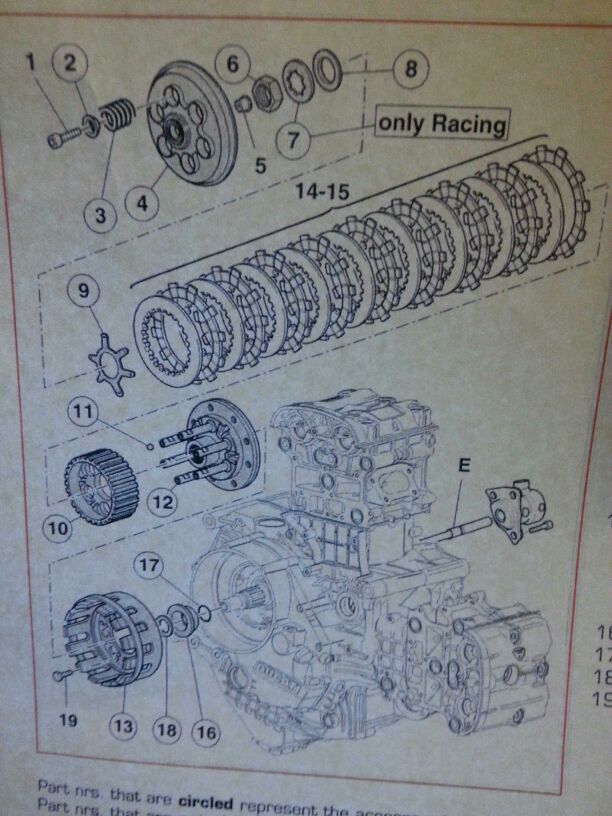

  14. ball and ramp DP
    I could do with a lesson on setting up lol - all ears
    but it is very grabby and I just put it down to being designed for very high power race engines.
    it is a ducati genuine race kit

  18. Phill, a couple of my bikes with slipper clutches made an awful noise when pulling away quickly, I switched a couple of plates for the dished ones, one dish in, one dish out and it helped a lot.

  20. will take a look at mine in the morning. I might have put the convex in the wrong place.
