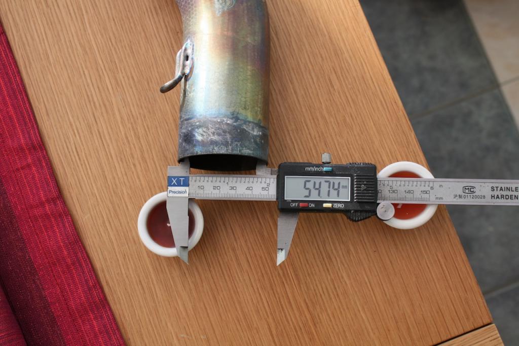

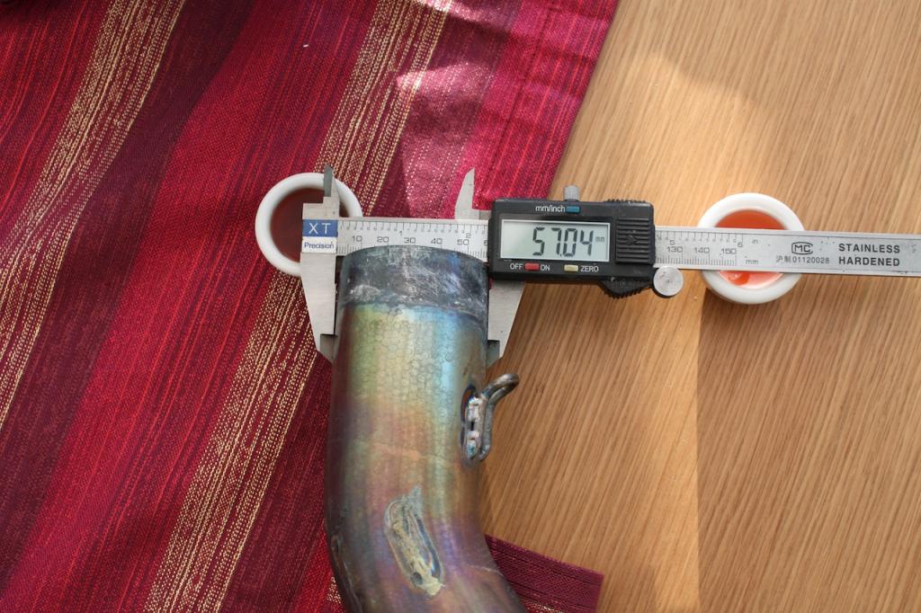

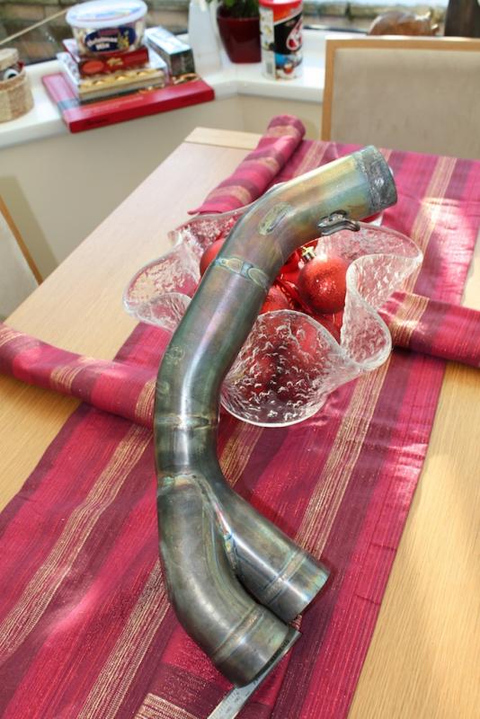

  14. As I said in a different post I have a stuart easton 749R Ti complete system . This one is 57mm although why they call it 57 I dont know because the bit that counts is 54mm.
