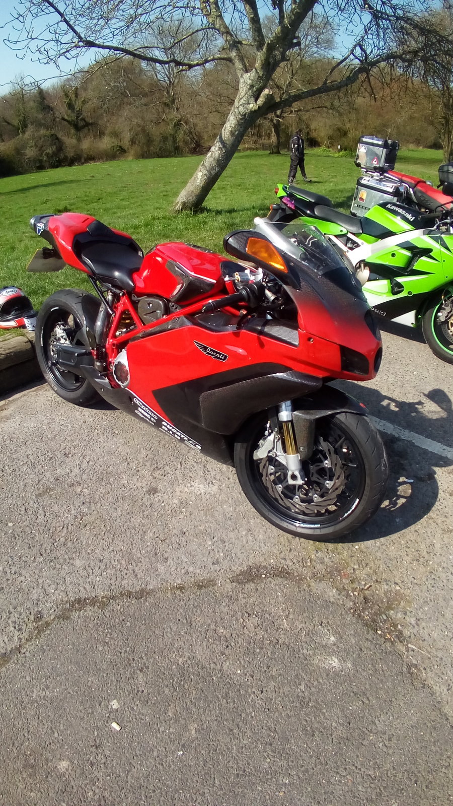

  1. hey chaps.
    Took the bike out last Saturday and at high revs it was bogging pretty bad, I have read another thread on here but I didn't see a cure from the op.
    So I'm thinking fuel or current issues, sounded like it was still firing just suddenly a few thousand rpm lower then it would kick back in again, I think that sounds more like fuel, Maybe filter? Pump relay?
    I'm a bit short of time at the mo so wondered which direction to go in first? Idles and starts fine, happened about 10 times during 2-3 hours riding, full tank, good batt, no fault codes.
    Any help gratefully received
