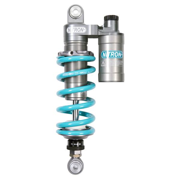

    REAR: Looking at Nitron NTR2 rear shock
    ( The r3 more suited to race and higher temps, so i dont need it )

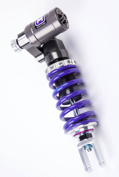

    OR the MAXTON R10
  2. Can you get a k tech for the rear to match the front?
    Nitron are great value for money though I've got an r3 on my gsxr track bike

  4. I will be going with a Maxton rebuild for both front and rear, I contacted them a while ago about options and then sent me this data sheet. I am fairly convinced the prices would go risen by now.

    cheers again, i email Maxton late last night so i will let you know. I asked them to price front piston kit with springs and a rear shick comparable to the Nitron R2 ;)

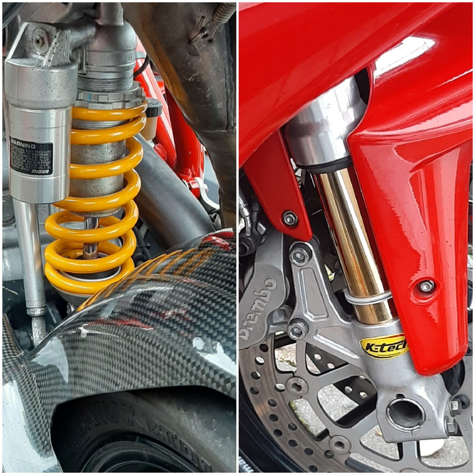

  6. DECISION MADE :idea:
    Going with ktech front springs and piston kit & keep original showa, service it an replace the spring.
    re the rear, going to stick with the current showa , as it apparently may have more range than the nitron r2, plus the internals and how the showa works may also be better, and i will change the spring at the same time, as the shock will have a full service. shoudl have parts from UK in the nexct 2 weeks or so with post and then fitted etc. Looking forward to it.
    the bike is running great, and its handling superbly as is, so will dial it in a lot more :bucktooth:
    btw, Re MAXTON, the GP 10 is what they recommend for the rear at 780.00 stg & they suggested a rocker bar like on the 749r which is 180 stg appx.

  8. Kit ordered.
    Ktech piston kit & new rear spring & going to service the showa shock.
    Hopefully over the next week or 2 be sorted. Will post back.
  9. Any updates on the suspension service?
  10. Sorry, been flat out in work.
    Yeah, vast improvement, more plush , rear a little harder but overall worth doing.
    The ktech piston kit made a big difference, front - he changed the springs but wouldn't tell me what ones(!?).
    The Showa shock on the "s" ive been told are worth servicing, as its pretty decent against spending a lot of a high end ohlins. Again this is a little harder.
    I done 999 (exactly) miles in August last Yr, aside from no padding in seat, on various roads and sh!t surfaces i couldnt fault it.
