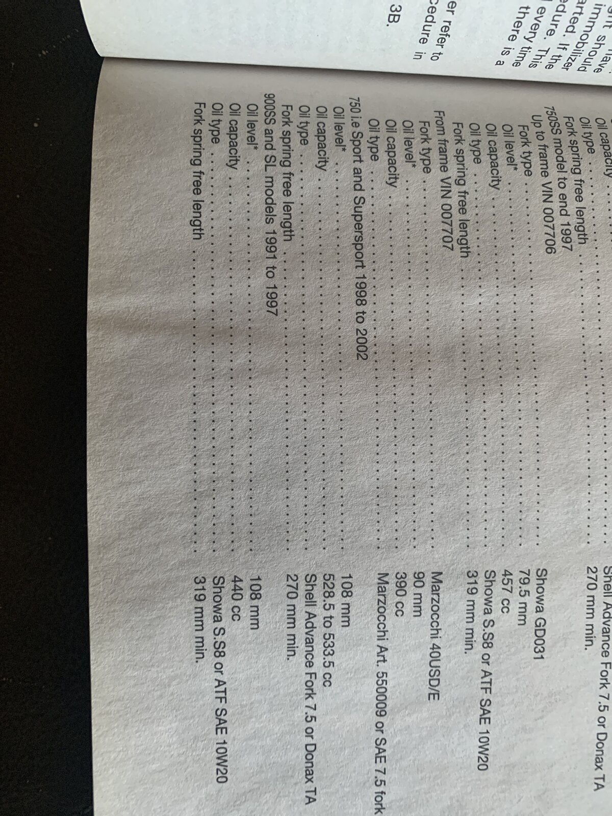

  12. Ok, so a 5 weight oil, just need to know how much to put in each fork, I've got non adjustable forks on my 2003 750SS ie ...
    From the Haynes manual if that’s any help.
  15. Might be different, hopefully somone will know the correct amount and let me know, certainly much appreciated as its holding up the front fork rebuild at the moment...
    Cheers
    Ian
  16. Thanks Alan, yes I think that's it, I might go for the 5 weight oil instead of the 7.5 weight...thanks ever so much for posting that, I owe you a pie and a pint ...haha...
  17. Hope it’s the right one, manual says 91 to 05 but specs are up to 2002 ?
  18. I'm good with that info, reckon it'll be ok Alan
    Thanks for going to the trouble of taking the pic and posting, really very much appreciated...
    All the best
    Ian
