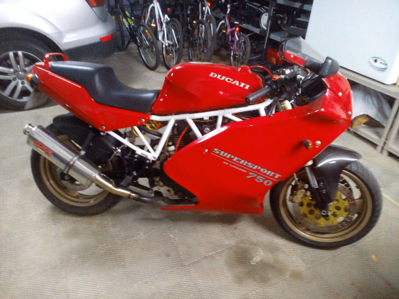

  1. Hello all,
    I have recently acquired a 94 750SS that seems to be in some decent condition but needs a full overhauling.
    It’s my first ducati, so it will take me time and lots of advice.
    My plan is to fully disassemble, fix what is broken, repaint and rebuild her to as much “as new” condition as possible with some changes and performance upgrades (clip ons, radials, etc..) but trying to keep her spirit intact.

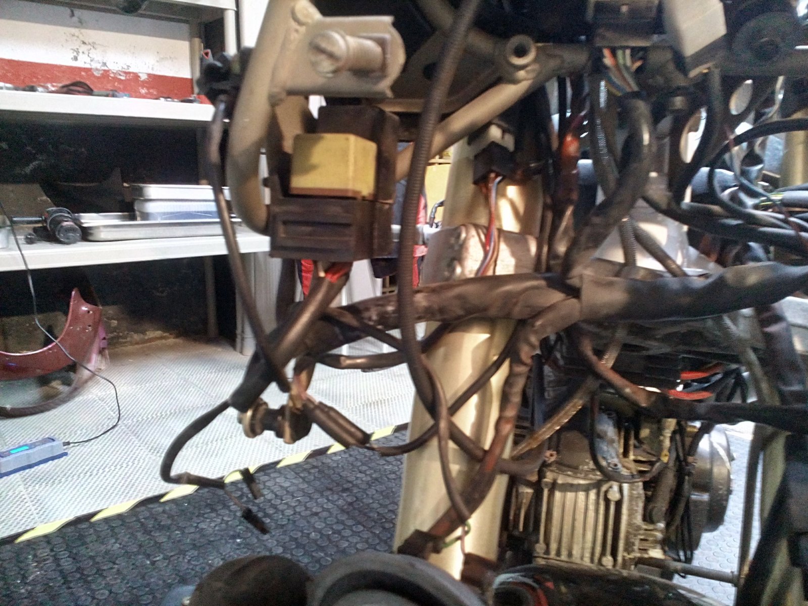

    No horn. No brake light when pulling the front brake lever (tough it works with the rear). A total mess of untidied wrapped cables.

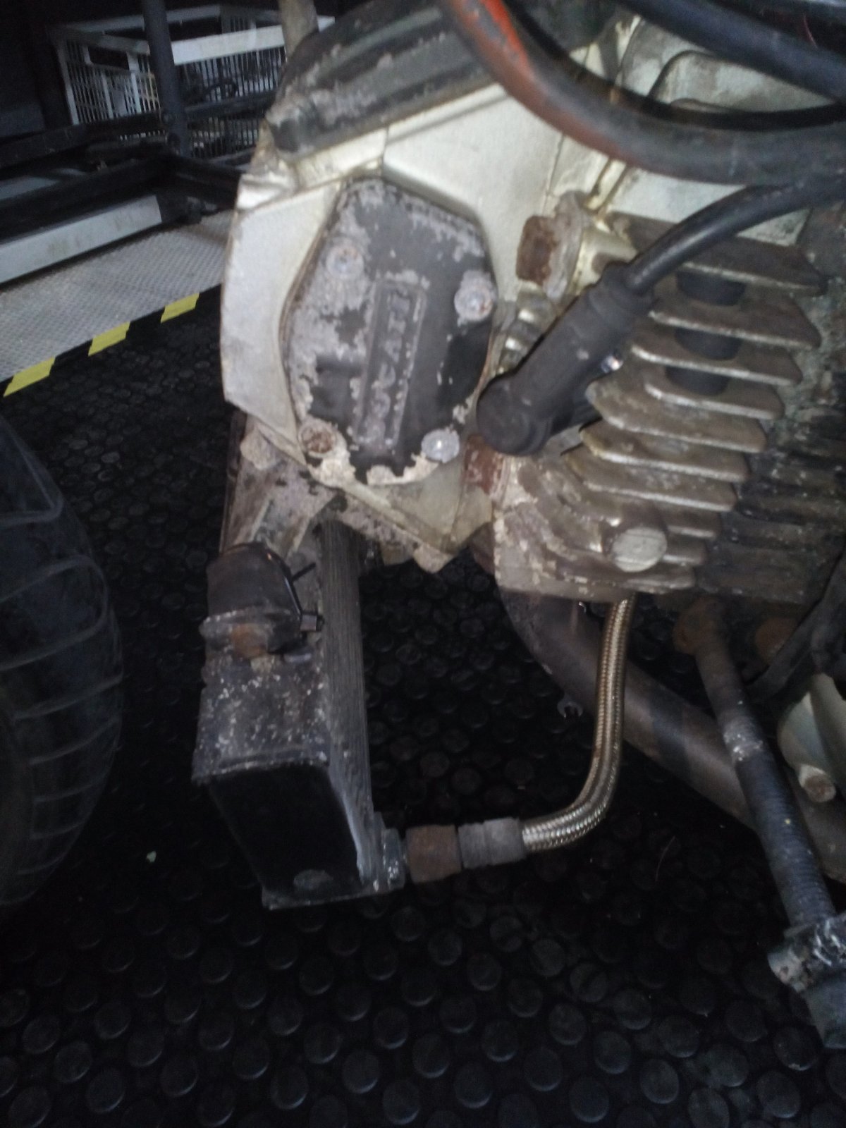

    Engine in rusty condition. Several breather and drainage pipes cut loose or disconnected
    mmm. loos like a lot of tidying up and cleaning.

    Extremely unbelivable mileage (less than 20k kilometers in 20 years.?? c'mon!)

    Good news! After reconnecting some lose cables on the front, battery was charging back again, so no need to fool around (at least by now) with a new rectifier. And also I recovered the horn sound (though it sounds like chitty chitty bang bang)

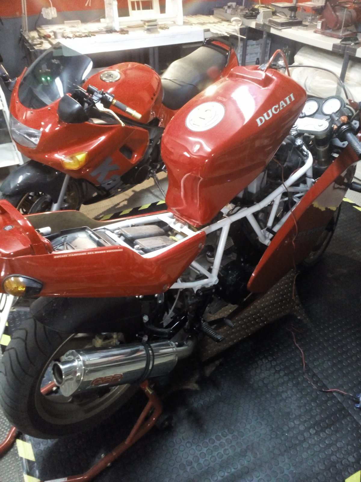

    Now I will start to stripe her down to the bare bones to send the frame, wheels, and some other parts to be sanded and painted while trying to repair the rest.
    It is a low budget project with very high end finish expectations, so do not expect weekly updates, though I will post any new changes whenever they happen.

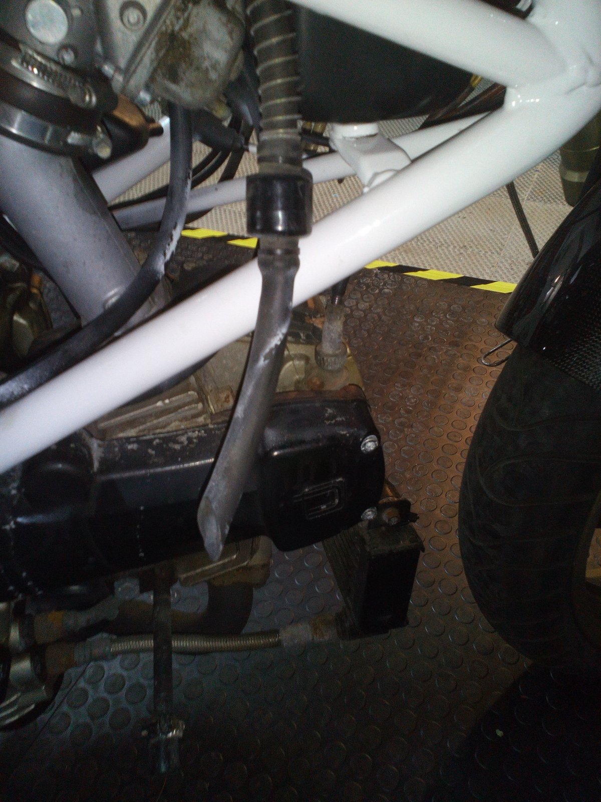

    anyhow it had a broken dowel on the subframe that supports the instruments and light (we call that the "spider" in Spain)
    see the picture
    I'tll try to weld it next weekend and also to reinforce the mirror mounts with and added dowel (as per the thread)
